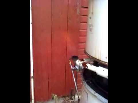

Hey MikeL! The best you’ve seen? You must have been looking at Wayne’s setup instead of mine! That, or the heat was getting to ya! Man, was it a scorcher that weekend. That gasifier I brought was my first flux core welding project, and I’m convinced more weld bead was ground off than stayed on! After much cussing, grinding and rewelding, it finally held water. Here’s a short clip from my first gasifier showing plenty of drips and gas leaks:
