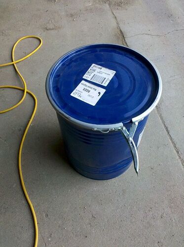

Skolnik CQ0502Q - Drum, Open Head, 5 Gal, w/Leverlock Ring (Grainger item 19K301) These are 14" in diameter with the leverlock rings. These are ideal for use in making lids for the hay filter, heat exchanger, and hopper fuel door. I have had no luck finding other reliable sources of 14 or 18" diameter lever lock lids of this type. These are however (in my opinion) very over-priced at $73 each.
If anyone has a reliable and affordable source of these they would be a great gasifier store item. The lid, lock ring, and about the top 3 inches of the drum! - Ready to weld on lids!
