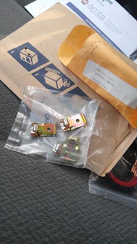

Thank you Wallace,
I took your advice and placed an ad in the Smokstak-verse, and today received four shiny new brush spring clips in the mail.
So, at present the trip to Escanaba’s Harbor Freight isn’t happening. I just get too tuckered out by 3pm to be much use to the robot team.
I do look forward to reviving the CCK.

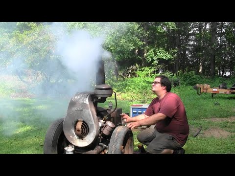

This is NOT a DRP, but I cant find any pictures or running video of one.
This is a DSP and its sort of like comparing a CCK and a LK .

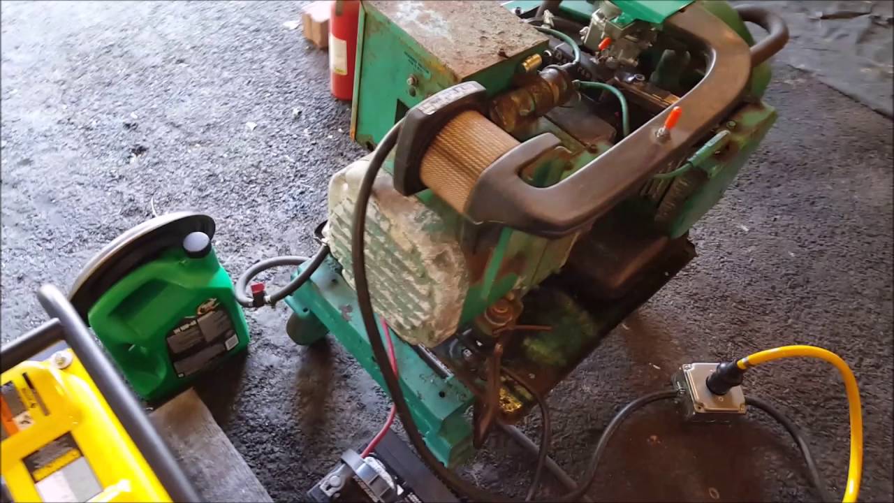

You may have seen the little aqua genny I run on chargas. When I got it off CL the filler neck was ripped out of it and the fuel hose was dry rotted. Obviously hadn’t run for a long time. All I did was silver solder the filler neck back in and get a new fuel hose. I then put e85 in it, pulled it over a few times till I was convinced the fuel was right through it, and let it set for three days. Then it started right up. I never even took it apart. My experience is that ethanol cleans everything.
I need to make sure the tank and hoses don’t leak since the tank is plastic. But e85 works like a charm. :stuck_out_tongue:

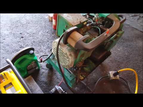

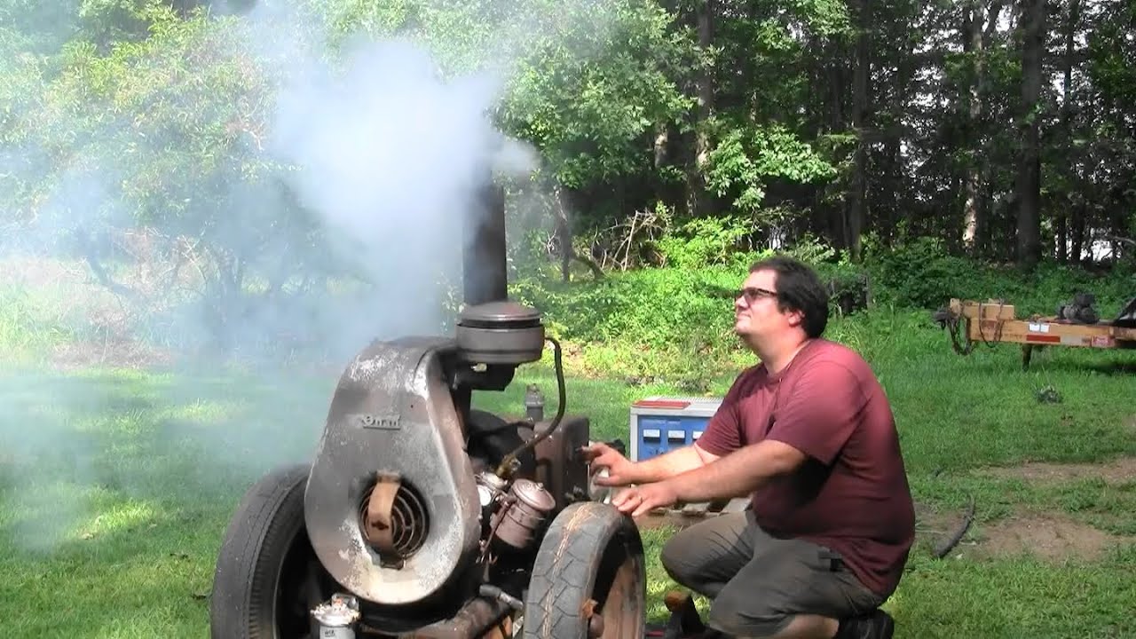

This guy really wanted to prove his BFA was better than the Chinese set.
And it is…
But if the Champion had been broken in and adjusted as well as cared for I think it might have been able to run 24 hours at 2500 watts.
But its new the machining is probably not perfect, valves may have need adjustment.
This was not a fair test unless you plan to do ZERO maintenance to your set.
But I still want you to watch and think about it.
A brand new generator could not run 24 hours out of the box at its rated output.

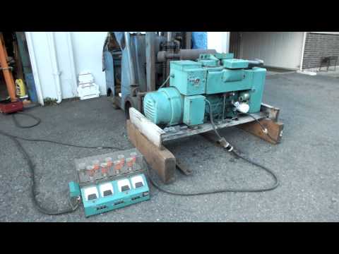

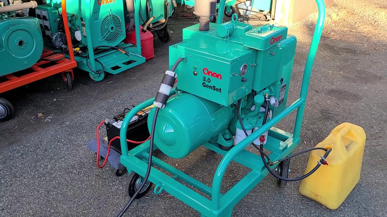

But I want to show you this…
Its gold so made between 1965 and lets say 1985.
A K 181 EP engine ( 18 cubic inch )
It will put out 3000 watts, its only rating is 3000 watts and it will deliver.
it will even deliver than on propane or natural gas.

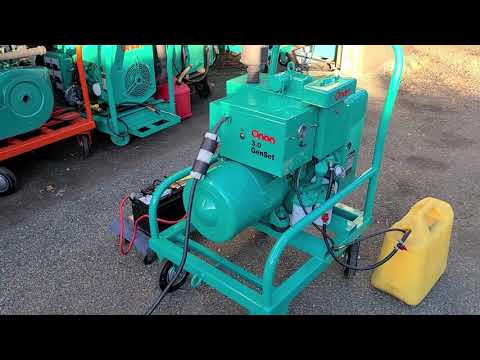

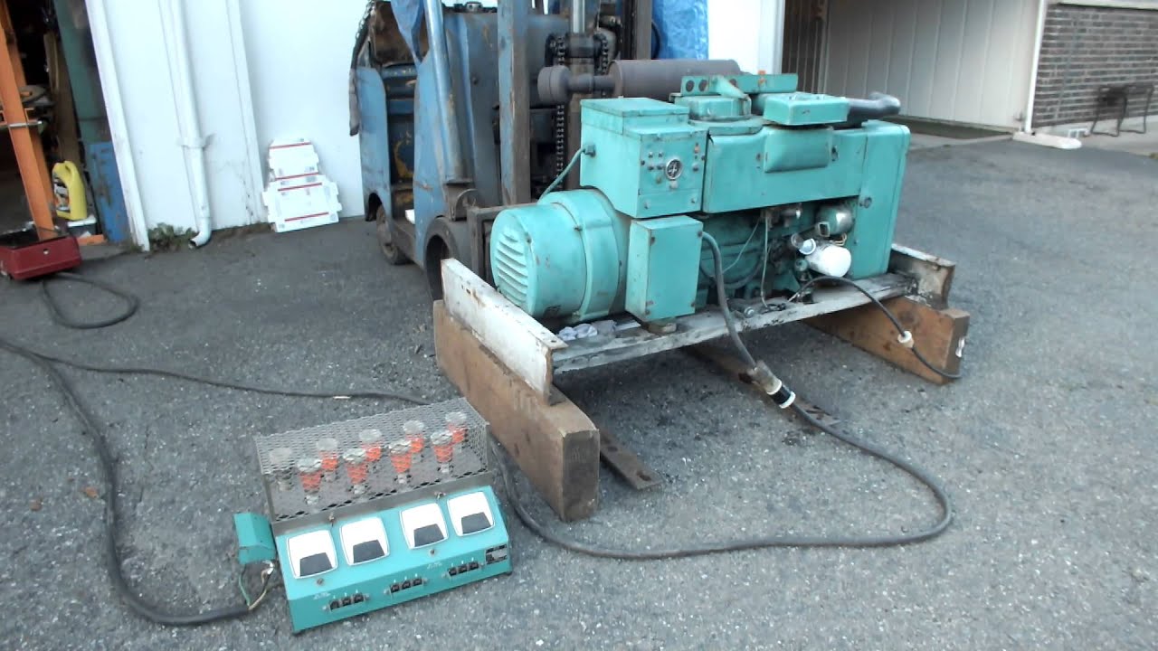

Look familiar?
Re-powered with a high compression big block Honda.
Your Mileage may vary…
That’s the engine off a Koshin GEH 4000 heavily modified to fit the 3000 watt Kohler head to ensure it could pull 3000 watts on Low cal NG gas.
The fuel also dictates what the gen can produce even if your burning those Dinosaur squeezings.
GX240 240cc rated at about 7 hp compared to the 18 cubic inch K181 rated at about 8
The 3-rm21 generator was designed to put out its rated power on any commonly available fuel.

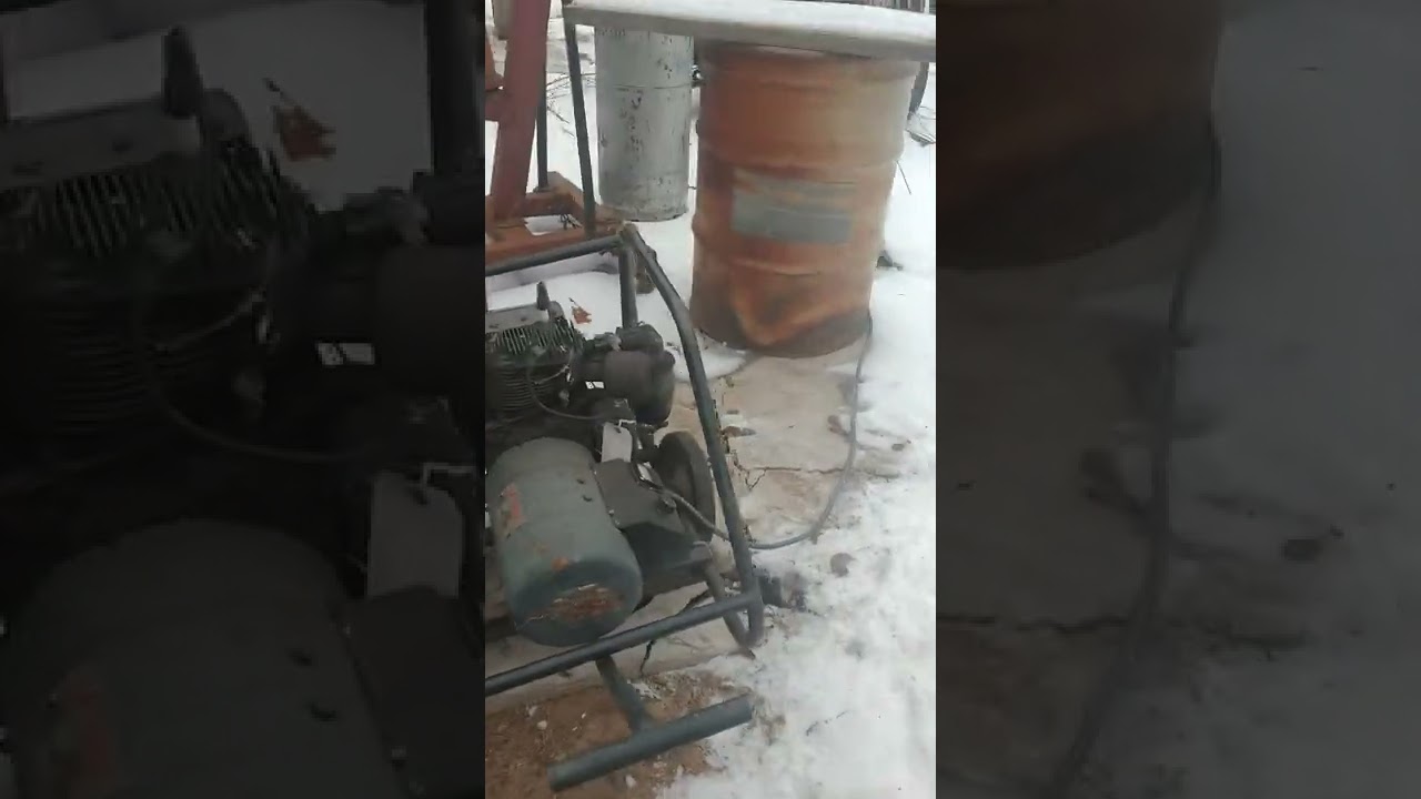

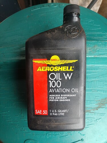

And this guy…it’s handy, runs the electric chainsaw. I had airplane oil in it and couldn’t start it by hand this winter.
The generator is a good one.
Here is a regulator you can adapt to it.
Man where do you find this stuff!!!
Wisconsin runs good!
Thats a keeper.
Long rod long stroke low compression engine will burn any grade of fuel.
Aeroshell 100 is great oil.
If you go back over my posts over the years I bring that oil up now and then.
Its excellent stuff to store and engine.
Table spoon into the spark plugs.
Mix some into some Coleman fuel and squirt it into carbs and ports… all over engines as a rust inhibiting storage oil.
Use it as assembly oil.
Top oil mixed into your gas to protect an engine before and after wood gas use if you are afraid of moister.
That oil is designed to burn clean and not gum things so its excellent storage oil.
