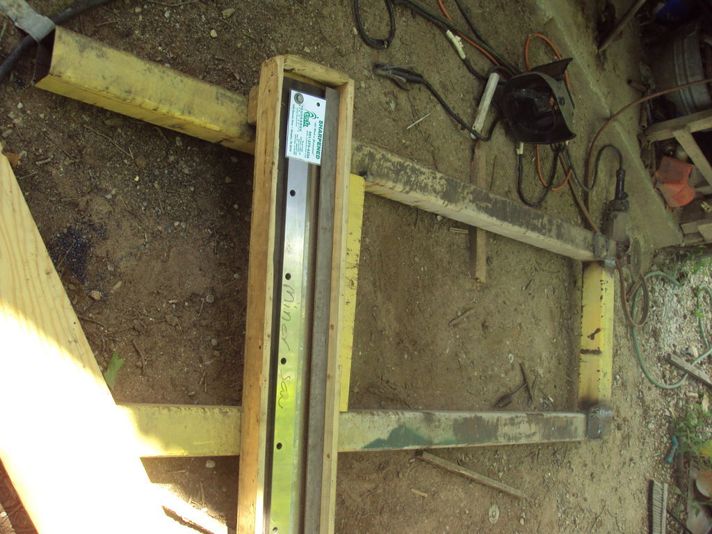

This is James Ulrich, I am in the process of building a chunker like what you are doing. My cylinder is a five inch bore, twelve inch stroke, with a 2 1/2 inch shaft; which should make the return quicker. I would prefer a four inch shaft. All in good time. Mine will be twenty four inches wide like a Guillotine. My frame will be made out of four inch square tubing, quarter inch wall thickness. I plan to cut up to 10 inch thick wood. Attached are some pictures.

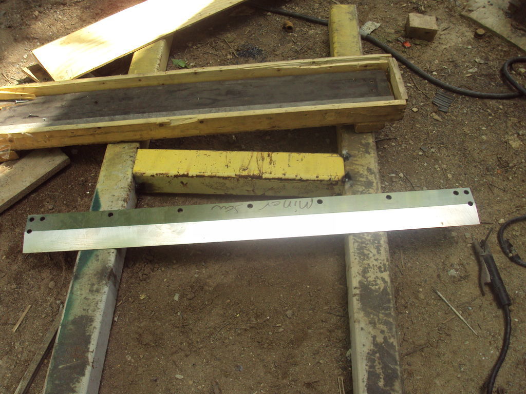

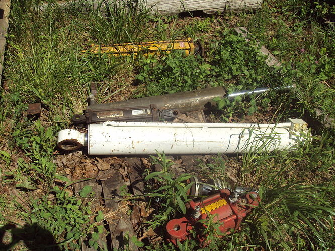

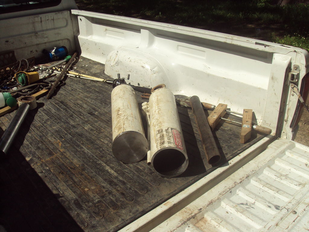

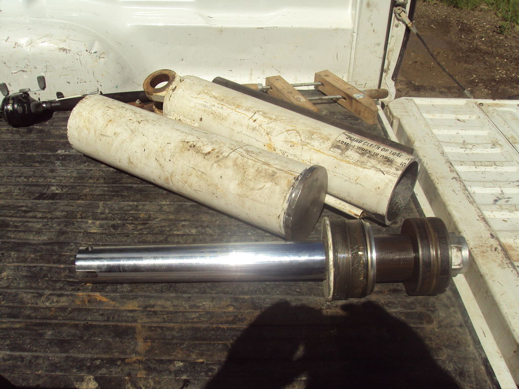

James here belowed I have attached some pictures of the cylinder that I had to re-build, blade, and the framework. I am hoping that I will be able to cut 6 to 8 in. thick slabs, 15 to 20 in. wide. Hopefully, will know soon! I am going to try and run it with the hyrdalics off the knuckle-boom; which is powered by a 3 cyclinder lombardini disesl engine-27 horsepower. The cyclinder that I did have had a 40 in stroke, I have cut it down, to an 12 in stroke. I will try to weld this blade to a piece of 0.5 in. plate.
hey james, hope your,s works , good looking blade , i had to cut and weld two together, i could not find one long enough, where did you buy yours, if i ever need to buy another it would be nice to have a single blade
David,
Hello. James here. I just got online looking for blades, Tenn.-Saw Shop in Memphis. I talked to the lady their, and told her I could use any scrap blades, or anything they had that was cheap. She found me this one for $20 plus shipping. Needthless, to say I was happy. Its 3/4 in. thick, 48 in. long, it was used for cutting paper. I will have to cut in half, but that will in return give me two. Are you planning on coming to the the Woodgas Meetup in Indiana 2012. I think I will be there Friday afternoon, or Saturday.
