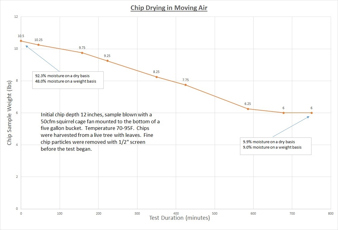

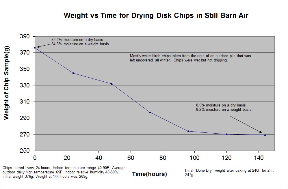

Thanks for the tech info, it seems wood drys much faster when and after chipped or chunked and or even saw’ed,am sure this info will help all us wood gas closed system wood fuel addicts.
