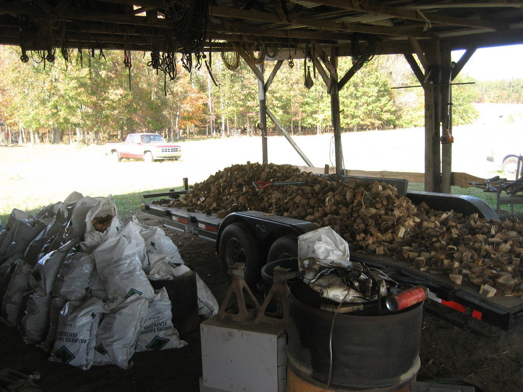

I chunked up a batch just Friday.

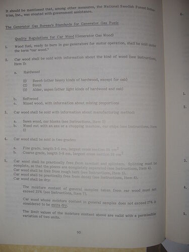

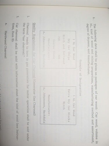

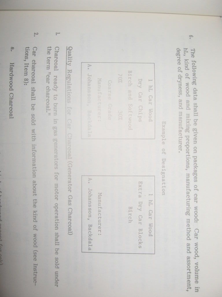

This brings up a subject that has been well discussed in the past. The following photos are from the book Generator Gas, the Swedish experiance from 1939-1945. They sold wood by the hundred liters, or a volume measurement. Moisture level could not exceed 25% and there were only two size grades recognized. Information on the wood species, volume, size and manufacture were all a part of the label.
There is similar guidelines for charcoal. Seems like a good place to start from.
Gary in PA
Gary,
That’s certainly a way to do it. Selling by volume makes it less susceptible to moisture levels, and more susceptible to wood density.
They had some strict rules, partly because of the bridging problems of the Imbert design. Wayne’s burned lots of stuff those guidelines would have dismissed entirely.
Most of the variation actually makes no difference; the most important thing is keeping the wood dry and clean. A random pound of dry clean wood will take you as far down the road as any other.
