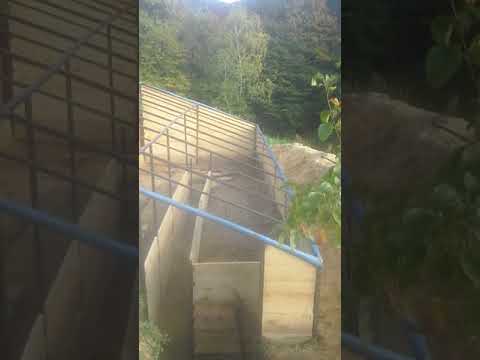

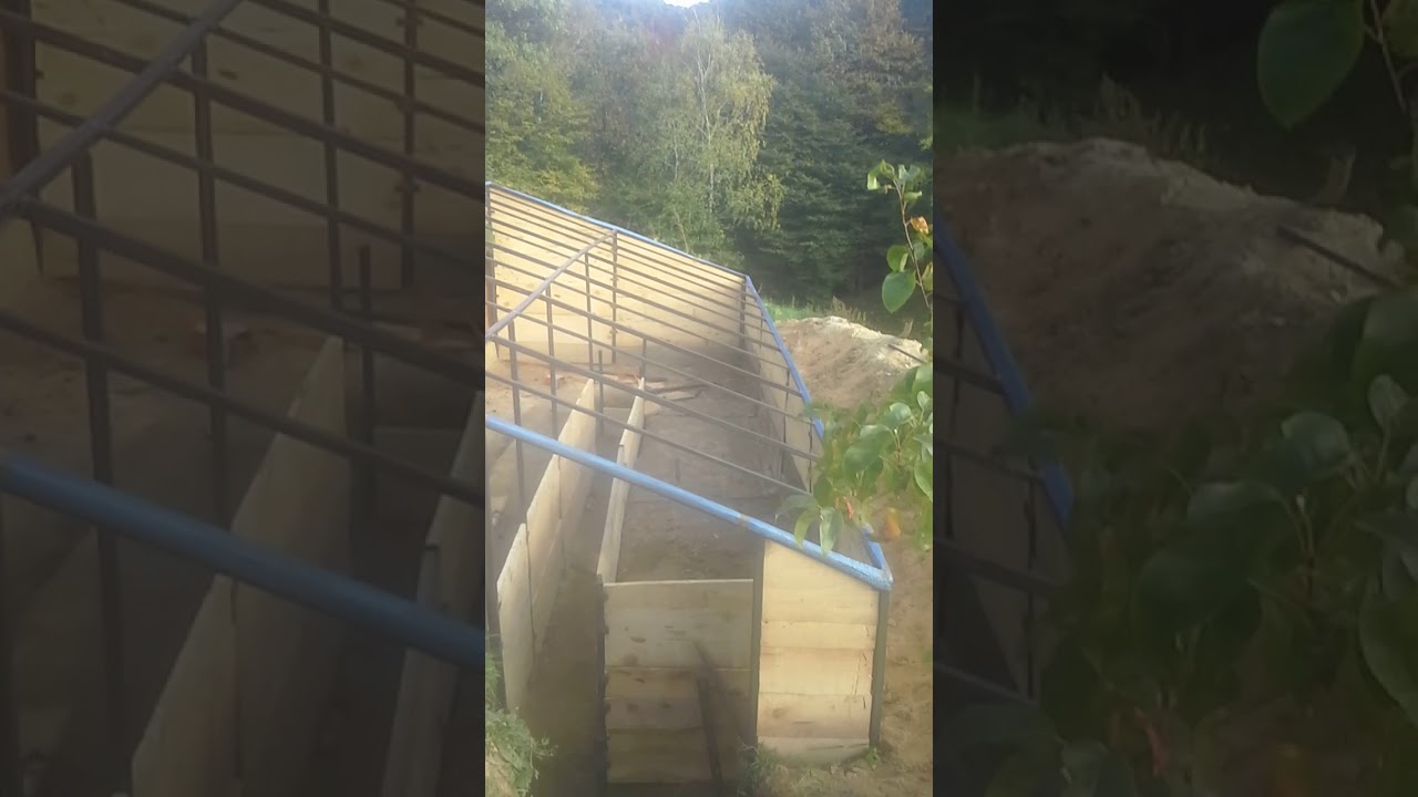

It was a rainy sunday and while checking out the greenhouse, the psychadelic sound of rain on tightly streched foil remembered me l havent yet showed the progress! So, this is it.

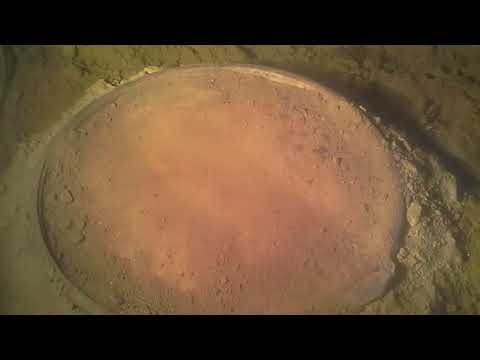

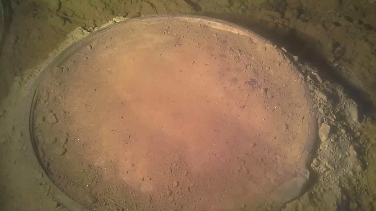

You can see several experiments in this short video. First, the in the bed composter. The idea is to dump all the organics in it, together with charcialand soil. Once fully processed to the top of the bed, a new composter will be digged out.
Then, horse manure tea oculated charcoal. Used a lot of it.

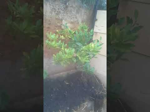

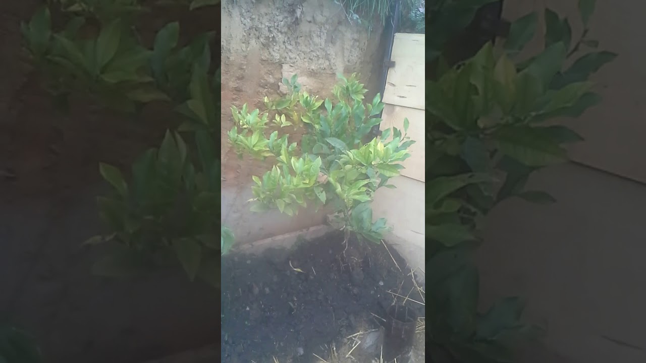

Third, the lemon tre, tomatoes, paprikas, peppers and chillis are about to survive a winter in. Fingers crossed.

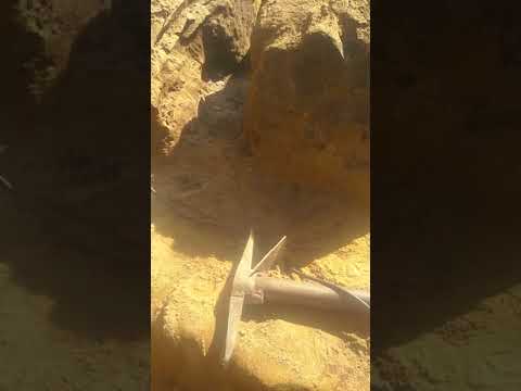

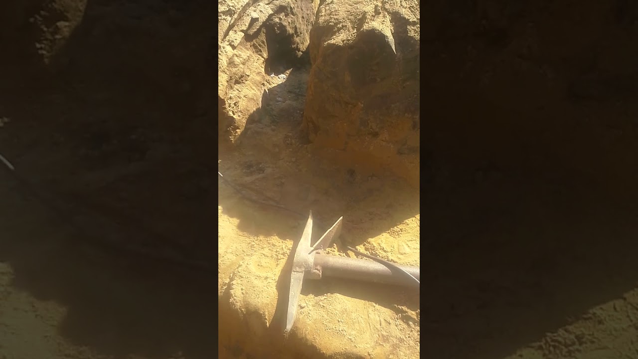

Anyway, the heater is made ou of a 55gal drum with a fireing hach on the bottom part. The idea is this can both be a normal wood burning heater, a sawdust stove, and a charcoal kiln. For now, its just a plain burner. Heats the growbed to see how it all works. It has been burning non stop for about 30 hours now and the soil is just starting to feel a bit warmer. The sandstone is a amazeing heat capacitor!
Edit: l did some more tunnel digging in the evening and while looking at the heater, a idea came to my mind. Lets throw in a potato and a rutabaga for dinner!
They were delicious!

The burner was burning non stop the last few days, well allmost. The soil is still cold deep inside, l think l need at least a week to heat the ~16m3 of sandstone to warm temperature. But it shuld allso last a long long time once fully âchargedâ with heat.
Why l says âallmostâ above? I have found out if l load the burner well, and burn full power for about a hour or two, then air tightly seal the bottom loading lid, the remaining wood will carbonise in a corse of a few hours, or better over night, wich produces some premium charcoal, while still heating the system. I make about 4kg at a time.
Since the charcoal cooks slowly, it is wery dense since the rapid pirolisis gas escapeing from the inside dont fluff the structure. It has a nice hard texture with litle dust once shattered, a metalic ring and like l sayd, much denster thain any char l made so far.
