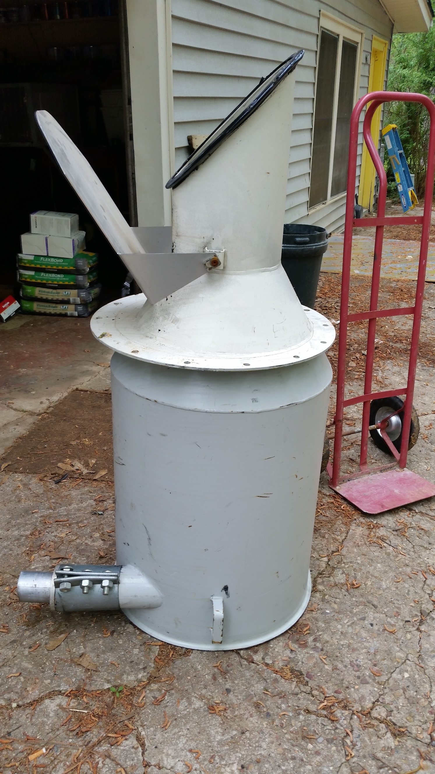

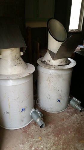

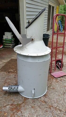

Hello and thank you for welcoming me to this site. For some time, I have been wanting to build a wood gasifier and yesterday, I came into good fortune when I found what appears to me to be 2 pre-made units which look like an easy set up. They said WOOD GASIFIER all over them as I pulled them from the scrap box at my work. Yes, they were 100% free!
Now, how can I make these work to produce actual gas which will run a 6500kw Onan Emerald III generator? I am collecting ideas and concepts at this point, so all input would be greatly appreciated, as I am certain there is a collective here who are much smarter than I… Pictures posted, hand cart indicates size of the units. Please take a look and give me your thoughts on how YOU would utilize what I have here.

Nice find, man! Ready made funnels, wow. Yes, gasifier all over them! Now for the dimensions. As far as I could

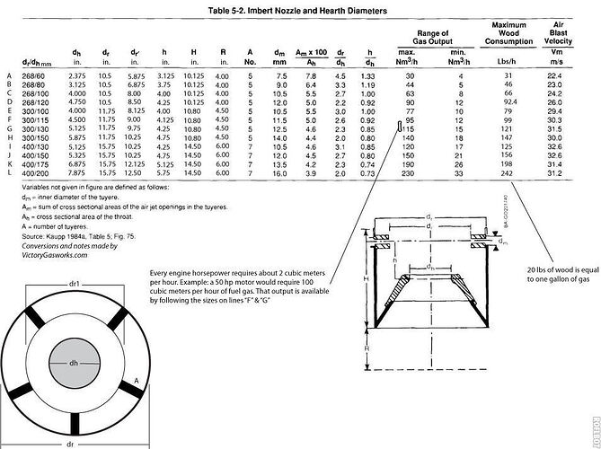

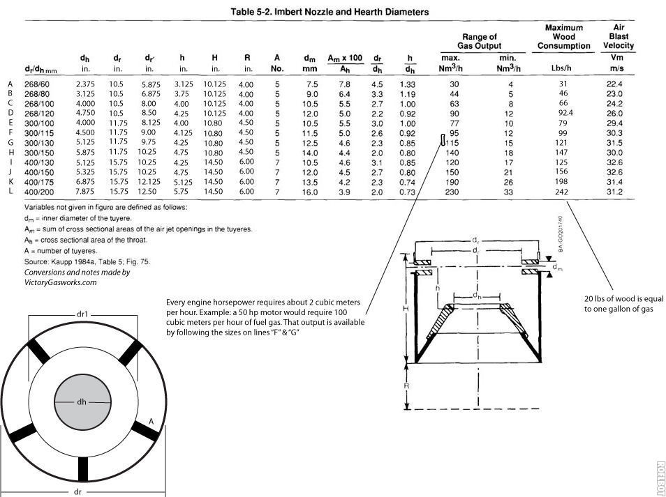

find out your unit motor is about 14 bhp ( if I’m wrong, please correct me} as imbert gasifier
construction dimensions are based on HP. For an actual well detailed build of an imbert
gasifier, check out, “My first small engine run” in the Small engine section on this site. I
built mine to handle up to 30 HP, so I used line C dimensions on the imbert chart. Yes, I have run
5 to 10 hp engines well on this size, since I had no larger engine at that time. Still don’t. See how the
engine runs and judge for yourself. As on old carpenter told me, measure 3 times and cut once.
I’ll be glad to answer any questions I can, so don’t hesitate to ask. Pics are invaluable!
You’ll find more folks pitching in, too. A great site full of great guys willing to help.

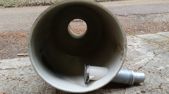

I noticed a flapper type device in pic 2. I know you haven’t started yet, but you want to avoid
buried flapper valves like pic 2.. How do you clear and free it, if it gets tarred up!? Opposite cords
or a lever handle, aggghhhh, air leaks, big pita and dangerous!

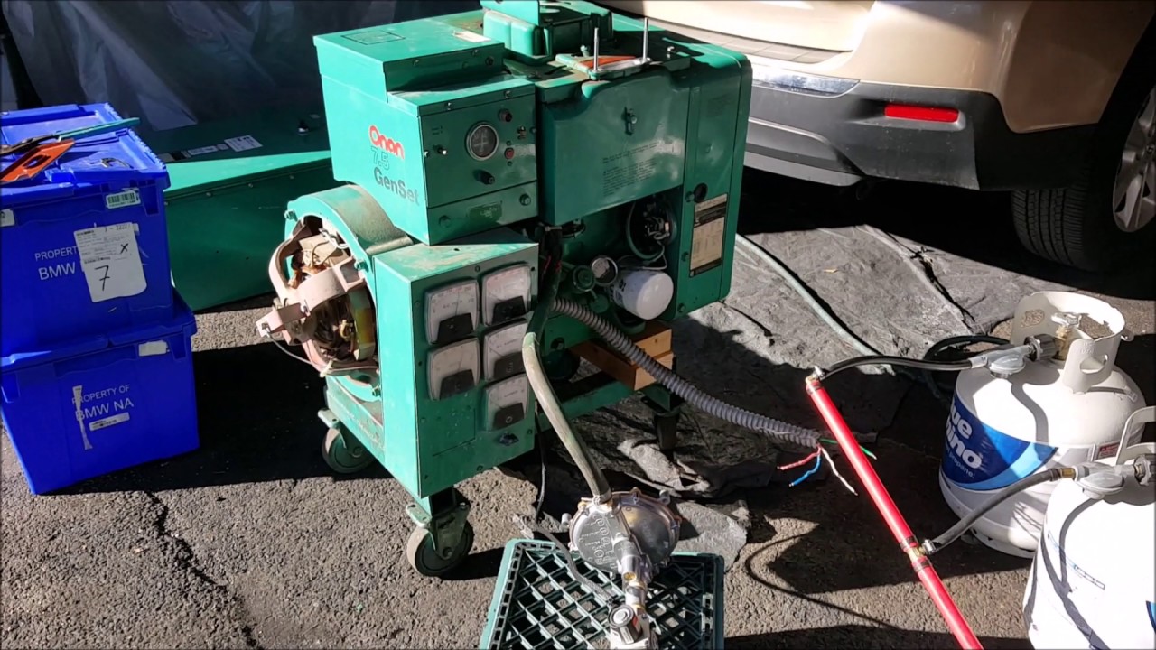

Great plant however the NHE engine is a flat head and will burn gas like the second coming is near…
The control boards and regulator are as rare and expensive as golden unicorn droppings if you fry one.
That plant might not be the best choice evn though I know its been done ( youtubers )
If you want a flat head, stick with a K series Kohler
Rebuild parts are cheap and the electrics are crude and very insensative to speed fluctiations and abuse.
Chinese OHV engines are disposable and easy to modify for wood gas.
OHV automitive engines in stationary plants offer the best compromise in efficiency and cost effective repair.
Electrics are always a crap shoot if they use sphphisticated regulators and controllers, but there are work arounds ( for the onan too) if you fry boards and controls but you need some electronics and electrical skills
Pepe- Oh man, this is a lot of valuable information! I was actually leaning toward round bales of pine needles which would fit perfectly into the hoppers and would pack much more punch than wood. I have more pine needles than I know what to do with on my property and they rake and bail nicely. They are quite gaseous as well. Being I could build 2 identical units at once, one could be in use while the other would be cleaned and reloaded for a continuous burn if needed. These units were pictured exactly as
I found them, those flappers must go indeed as
I have no use for them at all. I will be capping the ends and installing a drain valve for wash out. That area will serve as an ash collector… I believe I personally would sleeve the entire unit, add burners, add a removable cap and split (Y) the gas produced back into the unit and on to a gen-set… Is what is in my head anyway… I believe, the gas which the gen-set doesn’t use can fire the unit.

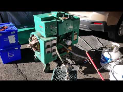

That makes a whole lotta sense. My Onan is running on vapor now and it uses very little fuel on the vapor set up. I have bypassed the carburetor completely, and also the circuit board no longer controls the ignition. I simply installed an ignition switch. I see what you are saying and you are 100% spot on… The Onan is my tinker toy. Something more viably efficient would indeed be a far better option. Yes… This is my YouTube video… LOL!
I appreciate your sensible approach, and I think you are 100% correct on all levels. It is hard to have that Onan and not play with it though. I would love to see it running on pine needles just to say it can be done and astound my neighbors…

I will be brutally honest with you now watching that video.
I don’t Ike what I am seeing and think a catastrophic failure is coming
The AVR can not take that kind of surging and if you had not bypassed the safeties the machine would shut itself down.
From my experience and listening to the sound of your engine your air fuel ratio is a little lean. When burning gasoline this is bad. Your engine will produce NOx (pollution) and it will run hot. You could burn your exhaust valve(s) and possibly other parts in the combustion chamber.
Once you get your air fuel ratio dialed in I would want to see a good long test to see if you actually get better fuel economy. At this point this whole ‘engine running on vapors’ thing seems like snake oil.
