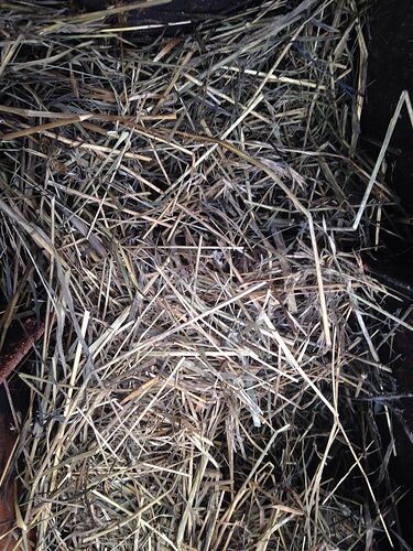

It’s been about 10 weeks since I’ve driven the Caddy, I knew it was going to be a while so I cracked the hay filters open at the bottom and top so air could go up though them. I haven’t done anything with it, when I got a deprive on my transplant people came out of the woodwork wanting stuff done. Finally got to the Caddy, took the lids off of the filters and dug down into the hay to have a look, looks like it did pretty good although there is some mold, how much is too much? Would mold hurt the engine?

I don’t feel qualified to answer your motor question but if it were mine I think I would blow some strong air through the filter ( leaf blower ) also flood it with water and go with it .
I will do that. I was pretty happy with the way the hay stayed for those 10 weeks, there is some mold but not too much. I know I’ve cleaned my filters before, put fresh hay in, sealed it all up but I didn’t run it, few days latter I took the tops off to check hay and it wasn’t pretty, that told me they store better opened up a little so air can go up thru them rather then closed up!

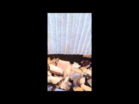

Didn’t want anyone to forget the Wood Powered Caddy’s fuel processor! It’s been working pretty good, Wasn’t planning on running it but a friend cut some “cow patties” for me so I couldn’t resist videoing and posting, I really enjoy running it, great way to work out frustrations!
Can you chunk oak. When I spit it for fire wood, it seems very stringy and often I have to pull the two pieces apart after I run it through the splitter. Or because your “cow patties” are only a couple inches thick, the stringiness doesn’t hamper the chunking.
Good to see you are feeling well enough to run your chunkerTomC

Tom, I don’t know why it wouldn’t split any kind of wood, I have found the harder the better, as far as stringy I don’t know. When it’s running the edge comes down within 1/4in so it would separate the chunks from the pattie, whatever strings may be still hanging would probably break while handling them.

May your stay at the VA continue to be comfortable and brief. Looks like it will be next spring before my Caddy will be running on wood. Seems like any mold should expire as soon as the filter atmosphere changes back to woodgas.

The mold must have not hurt anything, I blow it out from bottom up with leaf blower like Wayne suggested, washed it down with water and took it out and ran the crap out of it, ran just fine!
