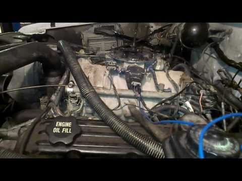

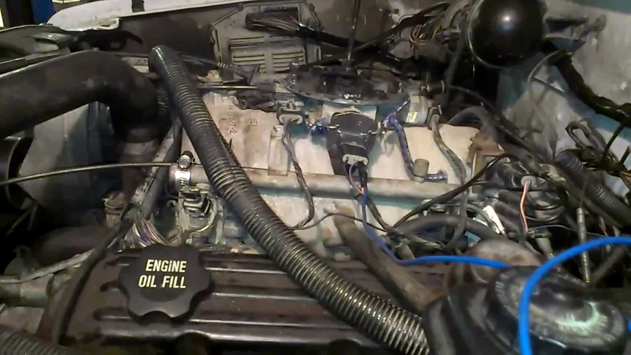

I need some advise on the Caddy, I want to make it shift sooner, it stays in all the gears much longer then necessary making it pull more woodgas then needed! Even if I let off the gas pedal it wonât shift, it will only shift when RPMâs get way up! Is there a way to adjust that? I would really like to be able to shift it manually to keep the RPMâs down, what would I need to do to accomplish that? Herb
Hi Herb, some tps have a small amount of adjustment. Electronic trans. shift by speed, and throttle position sensors sending info to a computer.

Thanks Al and Terry! Iâll see if I can find the tps!
Another thing about the Caddy trans that doesnât seem right to me, it free wheels, meaning when I let off of Excelerator the engine goes back down to idle, not in high gear but in the lower gears, that may be a clue to you tranny guys! Does engine vacuum play a roll with shifting? Thanks
Hey Herb, not sure what year you have, but electronic trans after mid 80âs donât use vacuum modulators to shift, use electric solenoids. sounds like something in torque convert., or pump. google your problem may find it. good luck, Al
