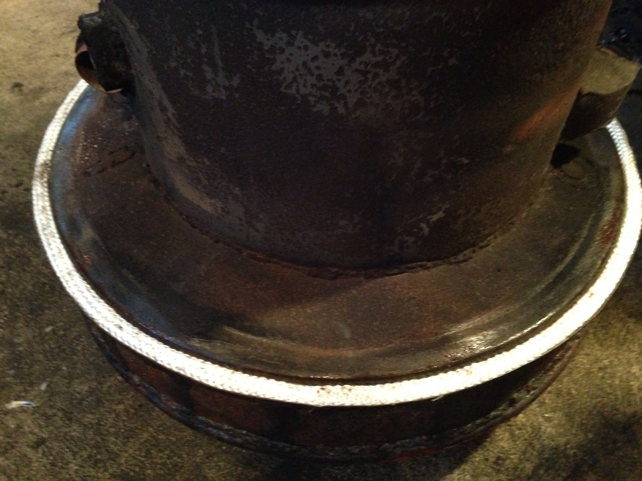

Hi Carl, its the burn tube lid, where it sits on bottom drum!
Well I decided to go with the old tried and true stove gasket rope, it installed very nice, didn’t even have to cut it for length and the 5/8 rope fit in the 55 gal lid perfectly!

Yeah that 5/8 rope works great, I was going to put some of the sealer on it but it fit so good didn’t have to, it practically snapped in the grove!
