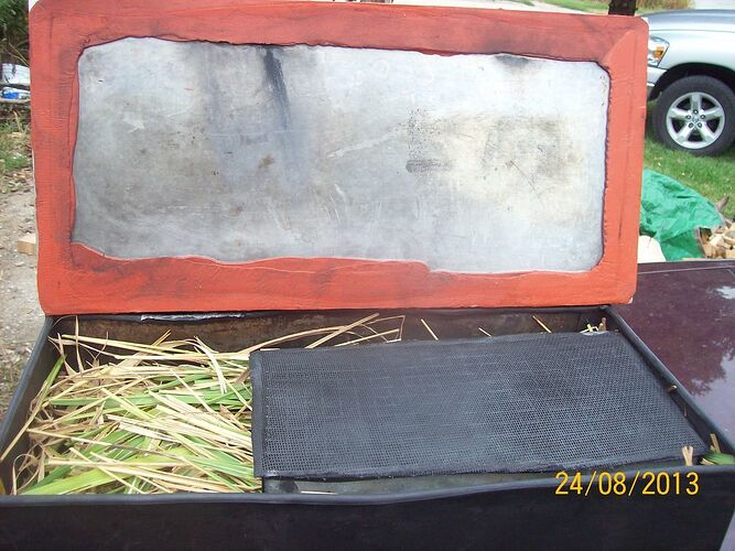

Did a complete service on my unit this week, took this pic of inside one of the hay filters. this is looking down at top from side w/aluminum top/lid flipped over. The red is gasket, the black 6" X 12" box i s where the now cleaned and cooled woodgas goes down and out to engine, same on other side..
Herb looks like I asked the same question twice on the stainless steel things. sorry about that.
Denny
The only SS I’m using are acting as spings for door/lids at different places, all my doors/lids are puff ports. O the other place I used SS is around the center section, by the time I got that welding done under there no one wanted to see it, it’s not pretty! I say if it’s not pretty cover it up with somethi ng that is pretty. latter, Herb
