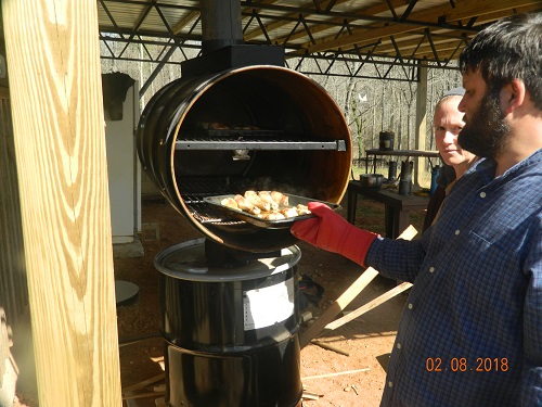

Sorry it took a whgile to get some pics. We finally set up the oven in it’s final home. It still needs some paint in a few places.
chicken legs…not quite done. Those are some tiny T-LUDS on the table in the back ground. And a metal-bucket-rocket stove in the far back.
Much better after 425 F for a while.
The oven box swivels on the bottom barrel. Both ends of the oven can be removed to make a directional heat exchanger. I have hopes of developing a steam powered fan to pull hot air through a food/coffee drying chamber. It may end up being our laundry drier???
Jesse sorting firewood for the different stoves and ovens.
I made this oven with a “self feed” and an ash tray. The ash tray also serves to feed air to the under side of the combustion chamber. But usually this is not needed since the down draft of the air through the fuel inlet keeps the fire from climbing out of the feed slot.
At other times I have used fiberglass or mud to seal the barrels together. This time I bought 2 rolls of exhaust pipe wrap. It worked perfectly and looks much better. This one also has heavier steel for the gas manifolds. Earlier models were too efficient and caused cooking problems as the temps jumped rapidly (often exceeding 600 F). We added some mass to absorb some heat so it could serve as a heat generator/exchanger for an air space (highland greenhouse) in a place where fuel supply is short, but where there would also likely be an abundance of labor (to tend fires at night) . For exmples: Andes Mountains, or small scale Central/South American coffee farm…etc…
It’s amazing how much you can cook on so little wood if you get a near-complete-combustion.
