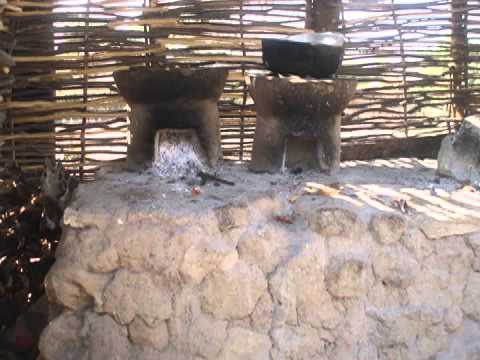

Got any clay?
Warning: the preview picture YouTube chose is not what the video is about.
