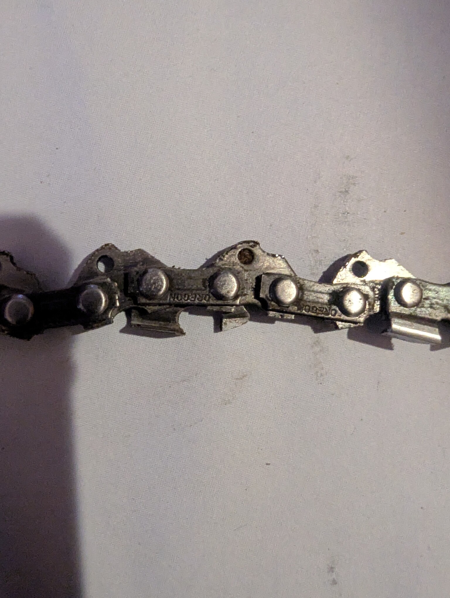

I have this saw tooth on this chain that won’t slide in the groove on the bar on the saw. Is that repairable by like dropping a link, filing, etc. or do i need a new chain. The chain popped off while i was using it.
The pointed part isn’t as pronounced as it is on the other links. It is the one with the gunk in the hole..
I’'ve had that happen more than once. I just find the ones that won’t slide through the bar and just touch them with a grinding stone on a rotary tool until they will.
I keep a flat file in the tool belt sleeve for raker tooth lowering.
I use this out in the field to dress down the raised edges burred drive teeth from a chain popped off.
Tedious as hell. But gets you back up and going.
I never had that happen before. It dremeled it, and actually the adjoining teeth had burrs on it as well. They all must have been stuck on the sprocket. It is all back working! Well I need to sharpen it again, but Sugar water is boiling. Thank you!

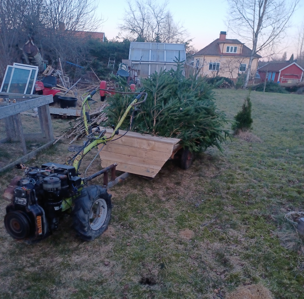

Collecting fuel, pickin’ up neighbours unwanted wood.

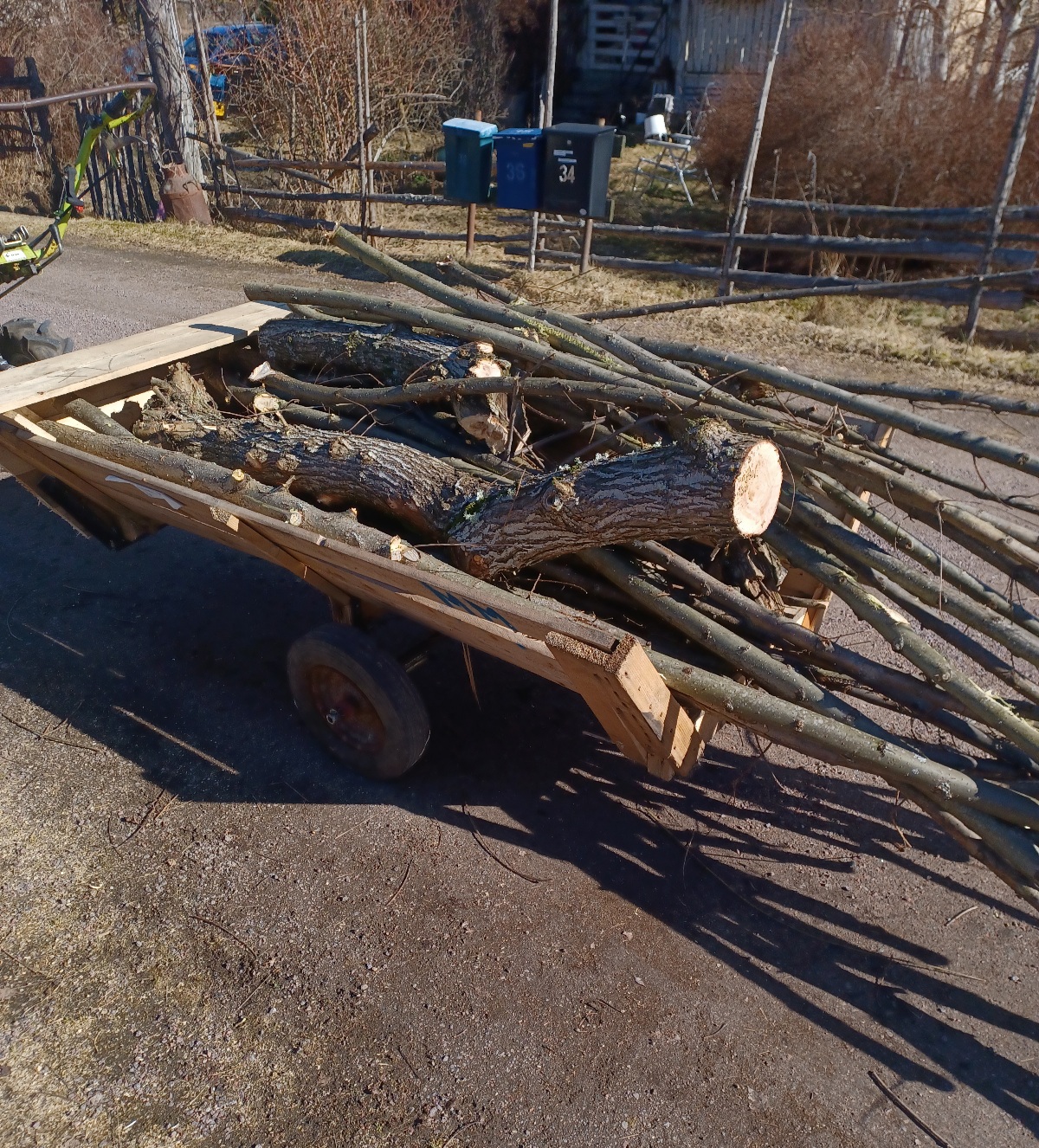

One load of thin garden willow, affected by some kind of “willow disease”.

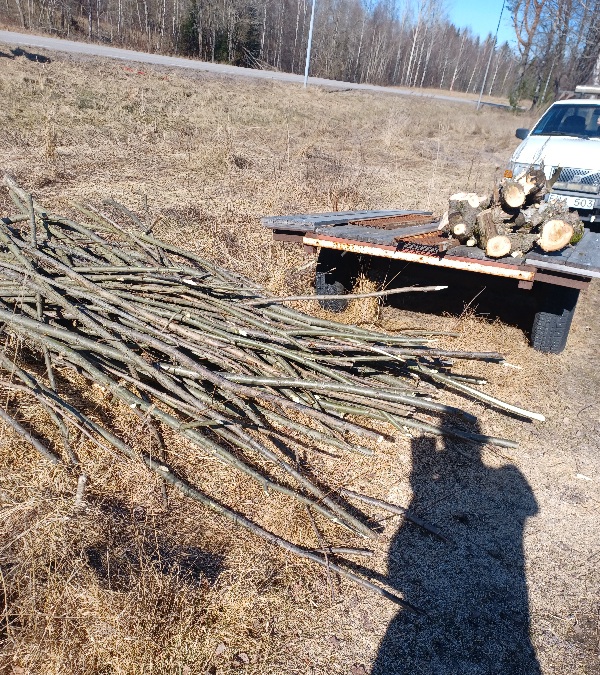

Another load.

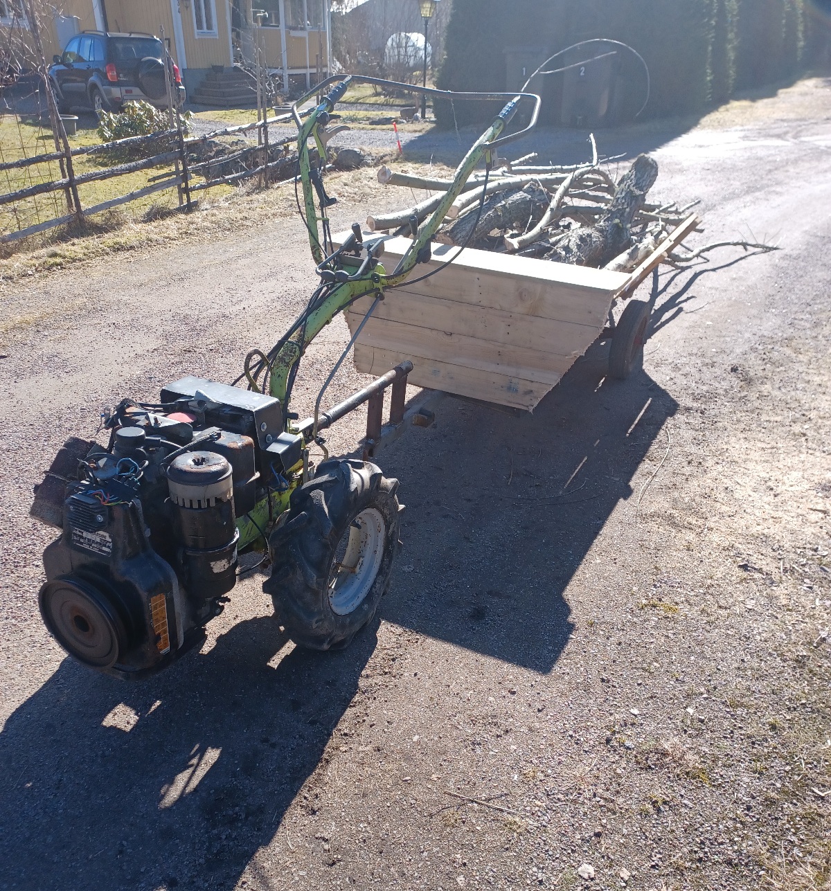

The little Grillo diesel is a work-horse, i slapped together the wagon yesterday. I find it pretty fun to drive two-wheel tractor this way, fast, jumping, no brakes, sometimes hard to steer, fun and dangerous.
grillo is italian brand…i reject every responsability!
Yes, it seems to be a good quality brand, and with a nice running lombardini diesel :smile:
Only trouble is it seems i got the only Grillo that made it’s way to Sweden, no parts, manuals, or implements available around here.
The roto-tiller that came with it was a BCS.

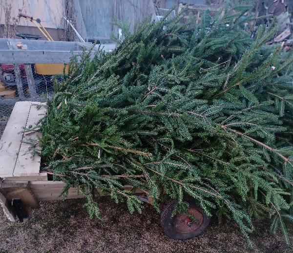

Little Grillo works hard moving brush, this is fifth load.

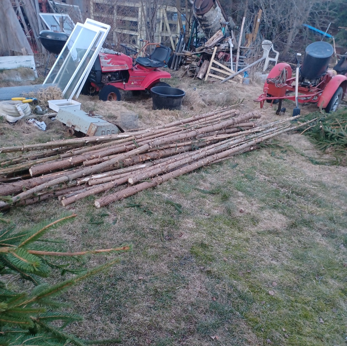

Fuel or material for old-style fencing? Decisions…
