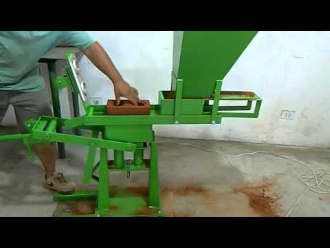

This technology looks to me much superior to milling wood, or most any other building technique, especially where labour isn’t a significant cost factor.
It’s apparently superior to fired bricks in compressive strength, withstands indefinite submersion. Popular enough in some states that Vermeer sells an automatic hydraulic pressing machine.

We have a long experience with this machine of earth blocks (more than 30 years) I´ll try to post some pictures. We called it SINVARAN (we learned about these in Colombia and we builded some), we have walls standing up for 30 years now (I´ll have to fetch the pictures). It´s fast and durable. It´s a long term and unexpensive solution. In my humble opinion, that´s the way to go.
According to what I read, the compressed earth block press was invented in Guatemala, following a seismic disaster in the 1970’s, look up CINVA. It has been widely adapted and presses improved since then. A brilliant system, I like the “Lego” style, which allows reinforced concrete grouting, and easy running of electrical cables. The mass of the bricks will provide excellent sound deadening, and will help maintain interior temperatures, cool or warm.

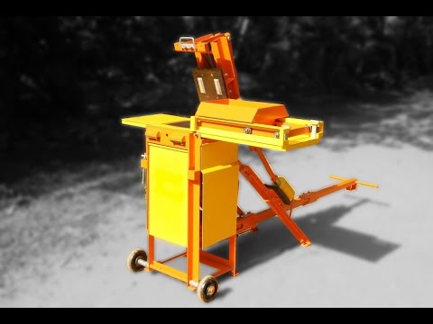

Great video Pierre. Very detailed construction information, practically plans to build one. Very seldom that you see so much build information of a commercial product. Many of the designs could be used on other projects, motor mounts, tensioners, adjusters, guards, very efficient and straight forward build.

Seems impossible that “bricks” made of dirt and a bit of Portland cement would have any long-term structural integrity. If you say it does, I believe you and would try it myself!
If you read the info for CEB, they are composed of a specific mix, certain percentage clay, certain amount sand, no topsoil or organic material. The last video I posted shows a block that has been soaking in water for 10 years. They say the compressive strength is greater than fired bricks.
Seems like an amazing step forward to be able to use earth from on site to produce such a good building product. But for me this is only information and theory. Hopefully Abner will show his results soon.
