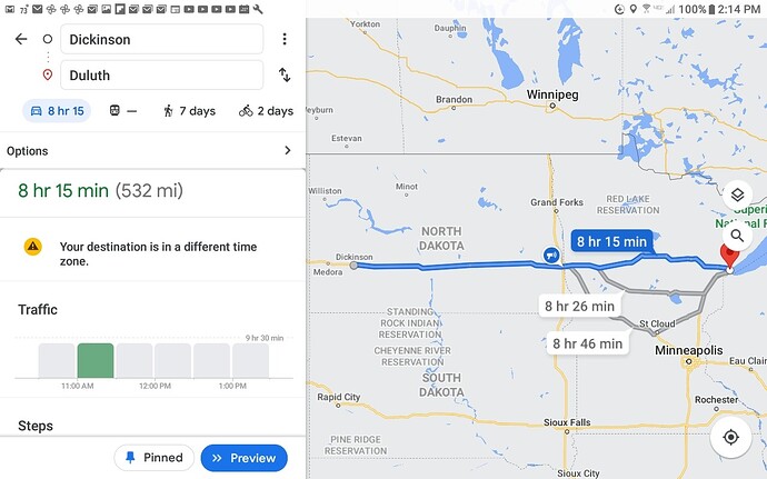

Just got off the phone talking to Jakob, it is 04:00 pm. They are a few miles outside of Fargo the (blue pin) on the map. They still need to go to Duluth the (red pin) on the map and then travel north to Brimson where Bill lives.

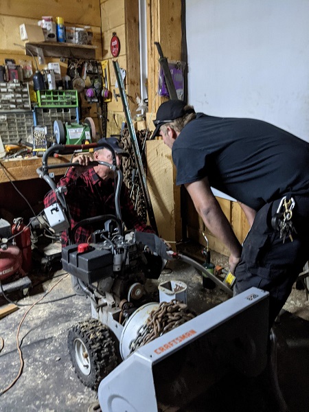

A little maintenance was required. I also made sure they had syrup in their truck when they leave.

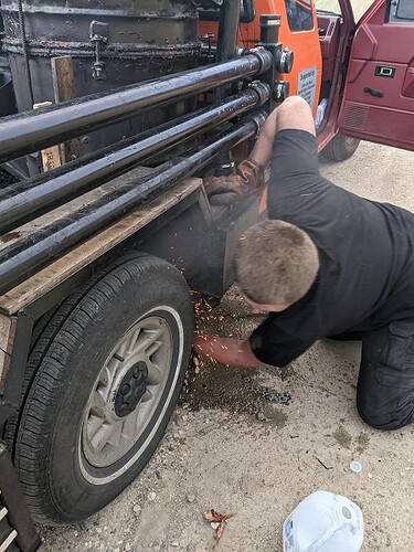

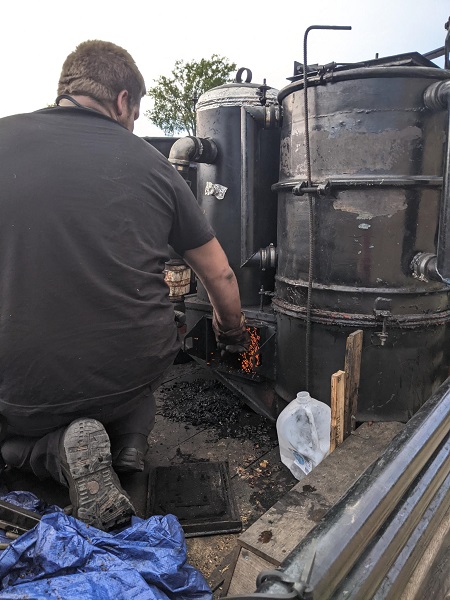

That is the best way to work on the hot leak Jakob.
That is a beautiful and sweet picture,

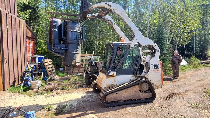

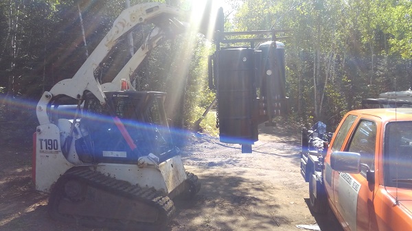

Grandpa Ken is in his usual “overseer’s” position, But I’m not sure Jakob will be able to use a T190 that has such pretty tracks on it. The one he normally has at home has not nearly as nice rubber.

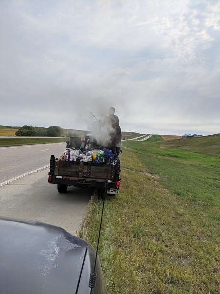

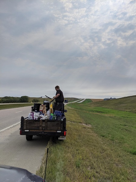

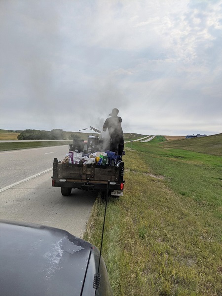

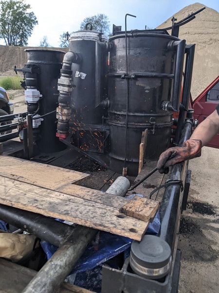

Yesterday was a very long hard day. The wood was using from Bob and Mike was creating a lot of small charcoal and fines. I was having a problem with everything plugging up. If it wasn’t the heat exchanger it was the hay filter. I finally got to the point where I had to do a hot ash dump because it wouldn’t loosen up. I found a good spot on the side of the road cleaned it out. I had just crossed into Minnesota at that time. Other than that problem it was a normal long day.

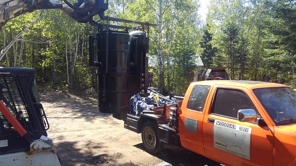

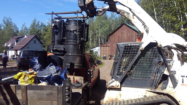

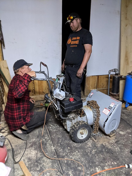

We pulled the gasifier in one piece today with bill’s skid steer. It is the same size as ours but it is a much more loaded machine. It does have much prettier tracks than mine lol. We got it put back in and another cleanout done on it.

I had to do a cleanout with it hot in just east of Fargo ND. I found a Good sand pit to do it in.

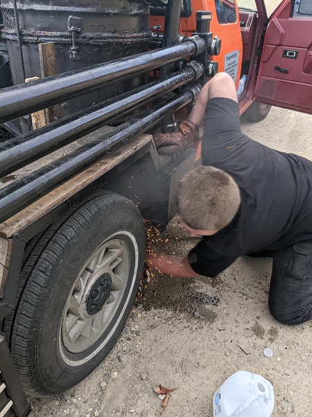

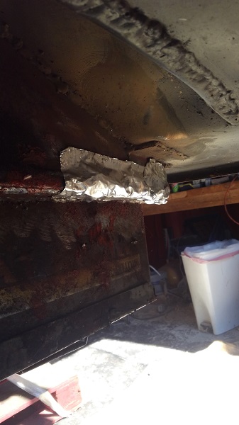

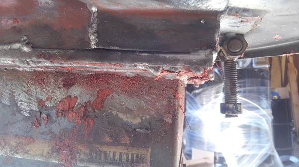

A few pics of fixing the truck today. I found the air leak and what ti was. I forgot to weld a spot. With my first door made with silicone and stove rope it covered this gap so it sealed. When I replaced with the ammo can the morning i left i had smeared some silicone over it not knowing it was there and that is what had been holding it the entire trip. I forgot to take a pic after i welded it before i taped it.

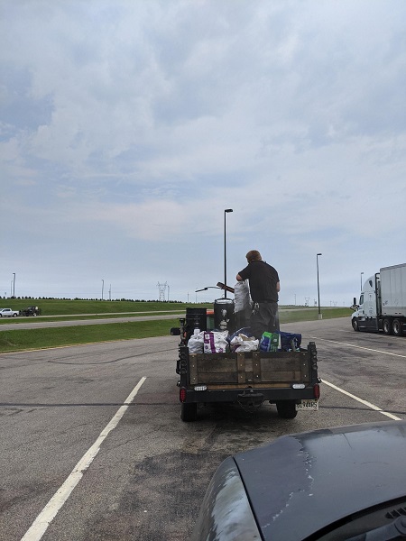

A few pics of refueling.

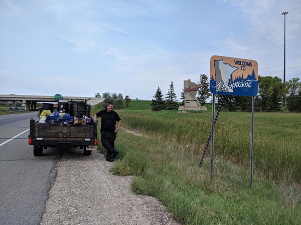

Well We obviously made it into Minnesota
Bill and i spent a few hour this evening working on his charcoal unit. We made it make good gas but having trouble with the engine, I think, we will hopefully try again tomorrow.
