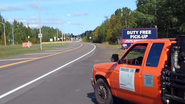

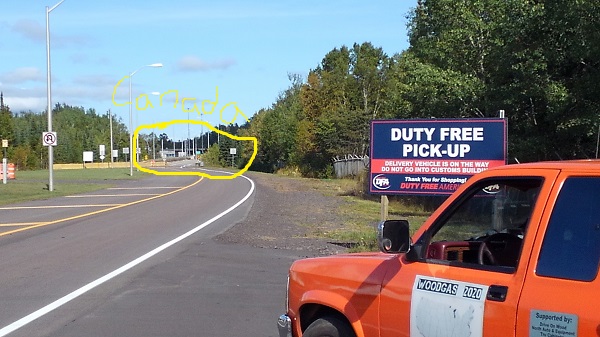

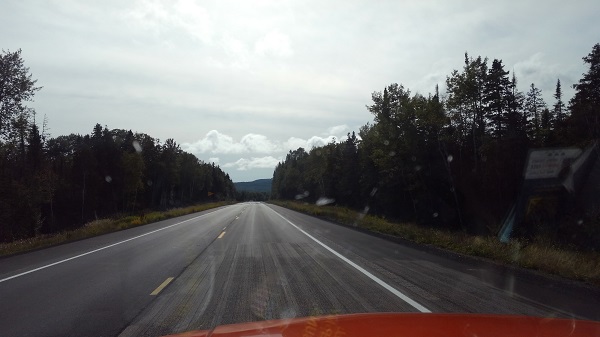

We made it to the Canadian border!!! :grin: :grin: :grin:
And back to Bill’s today. It was along slow ride. the wood i have here got rained on so it is very wet. Also when we pulled the gasifier with the skid steer yesterday the ammo can lid ash door got hung on the frame and ripped it off and bent it. I straitened it back out thought it would seal. It didn’t so i ran about half the trip with a hot leak again. once i found it i replaced the lid and it sealed up again no problem with it after that. It is still using oil. I put 3 Quarts in today, tomorrow i am going to dig a little deeper and try to diagnose it.
I got as close as a could to the checkpoint and still turn around.
