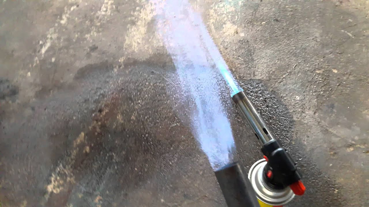

These are non-woodgas controlled productions of the gases CO and H2 to insure the purity of their flame color.
In the CO vid @ 1:18 the blue flame starts. @1:56 if you look closely at the flame you will notice a faint hint of purple in the blue. I have seen this mixed blue/purple color in my swirl burner. I have also had flames that were practically invisible as he states in the vid. I’m surmising from this that my unit is producing primarily carbon monoxide.

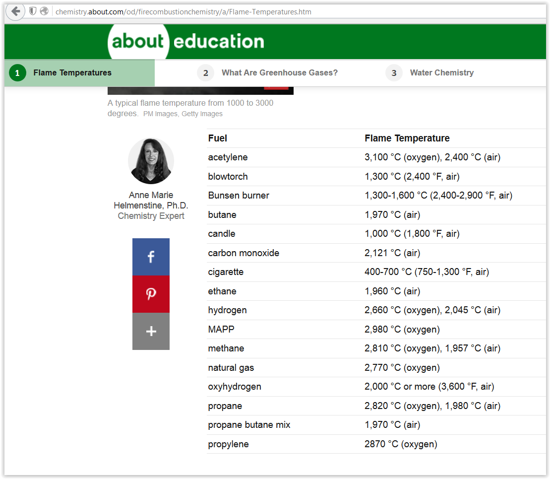

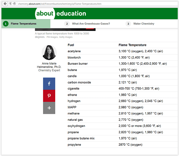

Also note below some common fuel flame temps.
Hey Mr Pepe
I liked the flame temperature chart that you put up. Thanks.
Shows why the best to use an acetylene/oxygen mix.
Bracketed r.h. side-bars has to be read carefully as it is sometimes the air versus refined pure oxygen differences. Other times bracketed number is just a Fahrenheit equivalency to the Centigrade primary.

Yes, I had to look a couple of times to read it right. One thing I found interesting is that CO and H2 have almost the same flame temp in air, 2121C and 2045C. Correspondingly, 3849F and 3713F.
I believe carbon monoxide has essentially as much energy as hydrogen. I never thought about taking the temp of the flame in my swirl burner, but now I’m really curious.

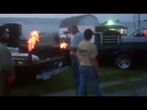

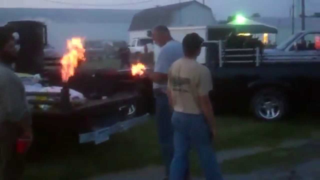

Ive pretty much given up trying to determine gas cleanliness by color. I go more off the transparency; on sunny days this is harder to judge even dirty gas can be difficult to see. If you have overcast and you are still making very transparent gas you are then making good clean gas. When we get into the potency this is where color makes the difference. When we have a good pink / purplish flare this I think gives the most power and is clean. A good brilliant blue flare is also very clean and still powerful but is harder to achieve. Our machines bounce back and forth thru a range of colors from faint yellow / orange thru the pink / purple and blue colors. This all depends on many things core temps, fuel flows and loading. One thing I always want to see in any flare is the blue hugh at the base, this is an indicator you have a good reduction process happening. No blue base in the flare, is a no go for us when we operate. I get it all the time that there is a belief that we must have this solid blue flare. This is not what I want to see at all.
Here is a simple experiment for you Pepe. When you are running put a paper towel over your flare tube and light your gas and see the color change. Yes you most likely catch this on fire in this process so take caution.
I’m not sure what the perfect gas looks like but can say collectively these vehicles have several thousand miles on them and drove several thousand miles getting to this event .
Keep in mind some are just getting started and are not at operating temp.

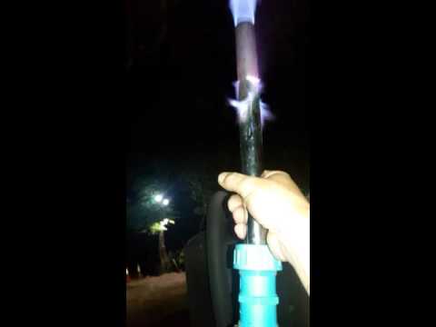

Here’s a clip that’s pretty representative of my flame colors as they generally occur. I’m using mixed hardwoods. Next spring I may do some individual species burns and record the colors for comparison. One more reason to burn.

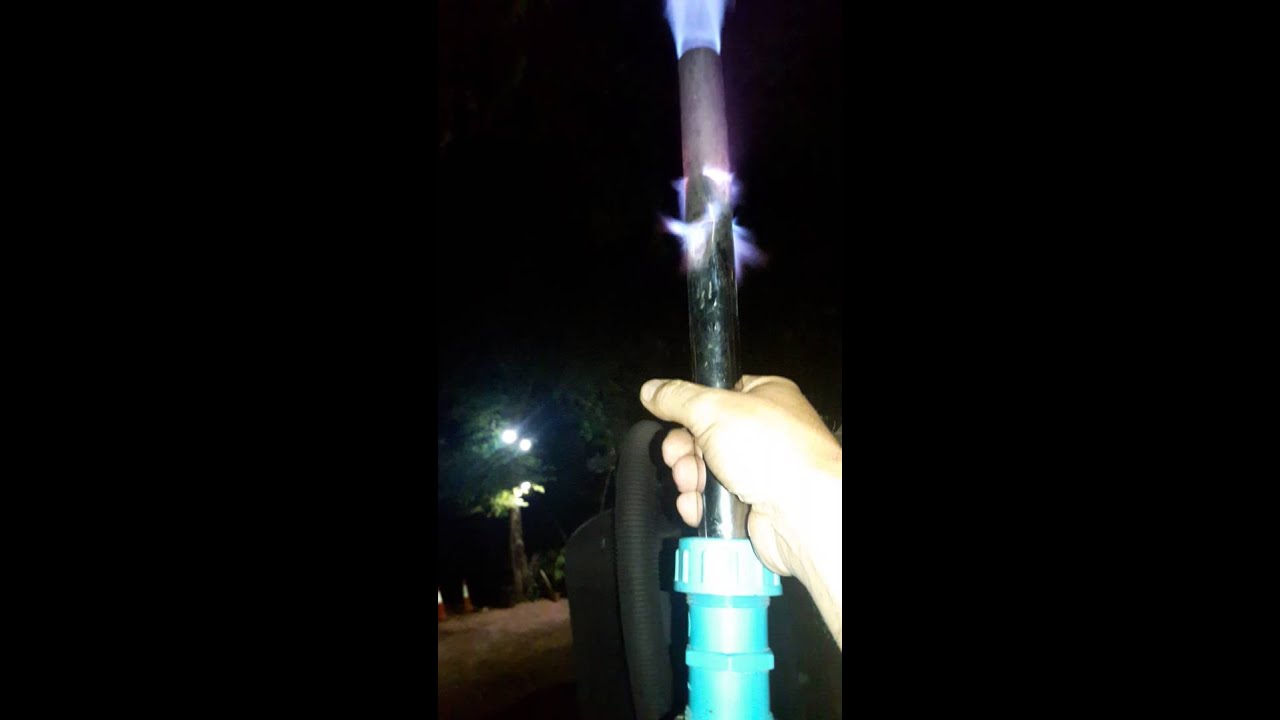

Don’t let the color fool you… its also depending the camera used.
Both in the same run
Also, the amount of air mixed in , before the gas exits the pipe, and the air humidity, do change the color…
excessing the air mixed
Also, it looks like 1 picture was without a flash and one was with. Digital cameras do so much “guessing at settings” for each picture based on what they do see, that it’s almost impossible to get comparative pictures of such things. Only a few very expensive professional cameras still allow the user to control the settings like an old manual film camera.
