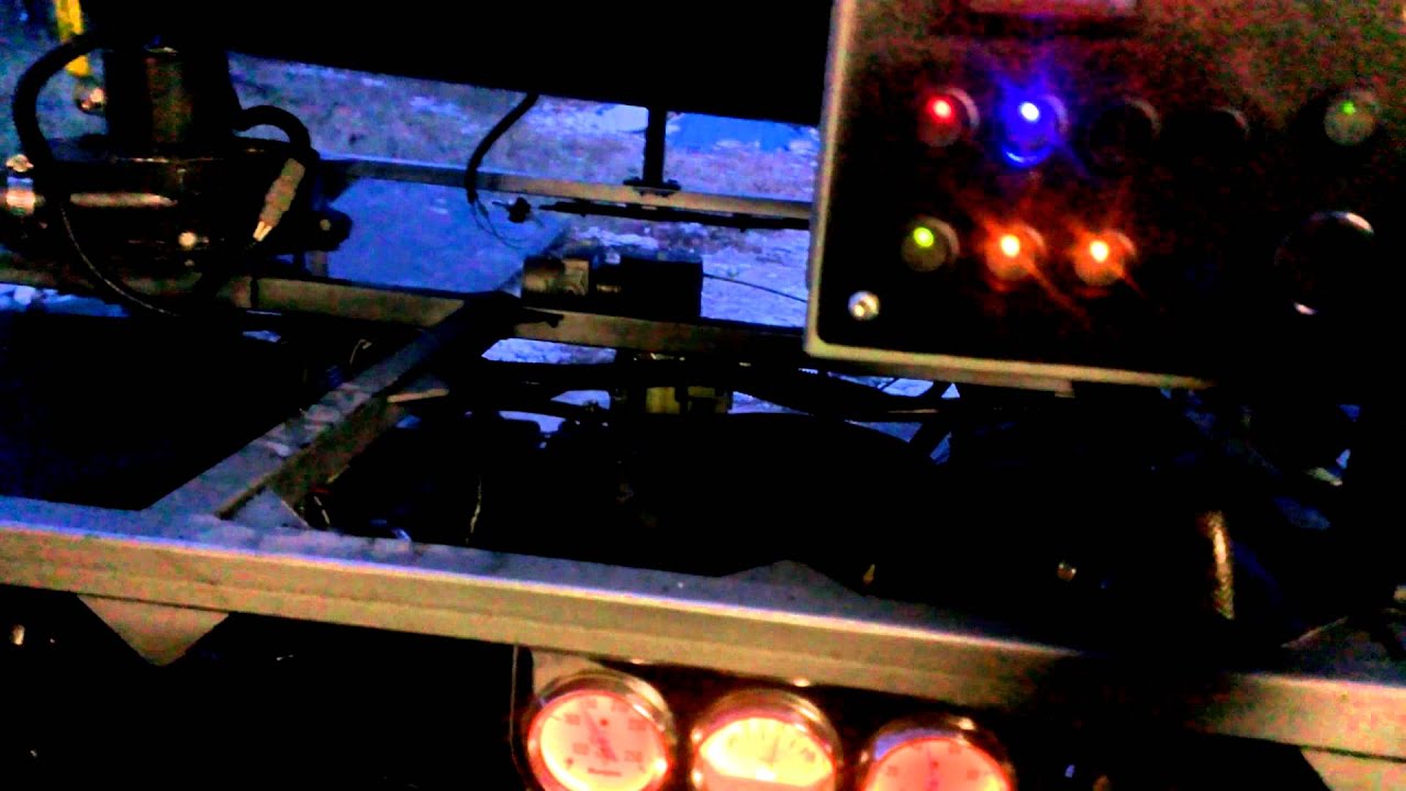

Then there was this baby, we put at least 200 hours on it after got it proofed out. It never skipped a beat on our fuel. Shipped to Italy and they put chips from Olive branches that were smaller and no good. We had to use chips on these as they wanted large hoppers systems. To keep from overwhelming the hopper with moisture we build the auger feed systems to keep the hopper charge to a minium.

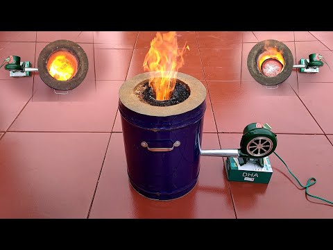

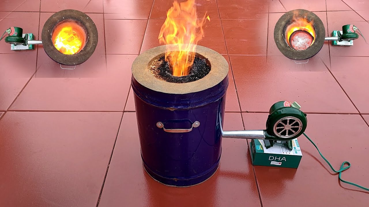

This stove is the same basic principle, but I am guessing even he sorted first.
