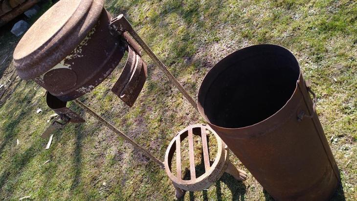

Our experience was much worst, as I already wrote. The fastest mean of heated was that “gasification based” heater called Satan.
It burns sawdust with amazing blast of gas flame, is of most simple construction and one barrel batch could last with throttled air input for whole night. If one have cheap source of sawdust, its great local heater. When connected to some sort of heat exhanger or brick work, it could heat whole house.

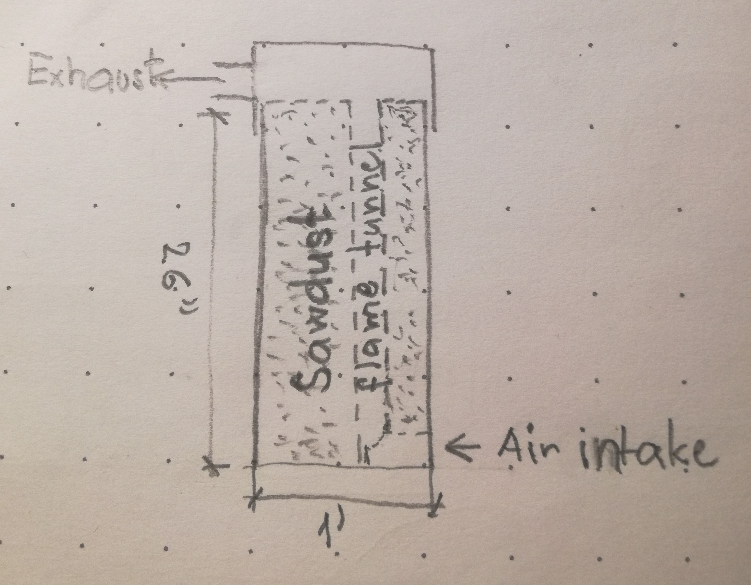

I promise I will. Just let me create nice drawings.
I think better to spend time building than drawing. I can do that too. I went to engineering school. I can make thousands of beautiful drawings. But this is not productive.

Here it is, made most simple way by hand. Not very good one, but I suppose its illustrative enough.
The device is made from two pieces, as you may see at the photo I posted earlier. The stand serve also as a top lid with smoke exhaust for removable cartridge. Cartridge itself is a simple barrel with air intake at the bottom. Intake has 2" diameter followed by the intake tunnel some 4" length. The tunnel is cut round atop at the end to allow pipe or pole of same diameter to be put inside from top.
To fill the cartridge with sawdust, you stand it on the firm ground. Put one pole which fits into the cut end of air intake tunnel. While hold it stand upright, pour some 4" of sawdust at the bottom of the cartridge. Use second pole of roughly the same diameter to hammer the sawdust until it get densely packed. The more densely packed the better. Especially around the end of air intake tunnel hard packing is essential to prevent sawdust falling and clogging the tunnel. Add more sawdust and hammer it in the same manner. Continue until you have cartridge filled almost to the top (leave 1/2" free). Carefuly get out the pole out of the packed sawdust in the cartridge. The best way is rotating and pulling together. Sawdust which fall during this operation and block the intake has to be removed. The desired result is something like large sawdust pellet with hole in the center packed in the cartridge.
The cartridge is fastened into stand by swinging rim, as you may see in the photo. It is lit through the air intake easily by gas burner or with piece of paper or wood wool. You only need good draft from your chimney :grinning:
It burns quite fast if you do not restrict the intake by rotating flap mounted at the front of it. Usually smoke tube get red hot in less then ten minutes since ignition. The top of stand serve as stove top. We were used to heat there hot water in 5 gallon cauldron.

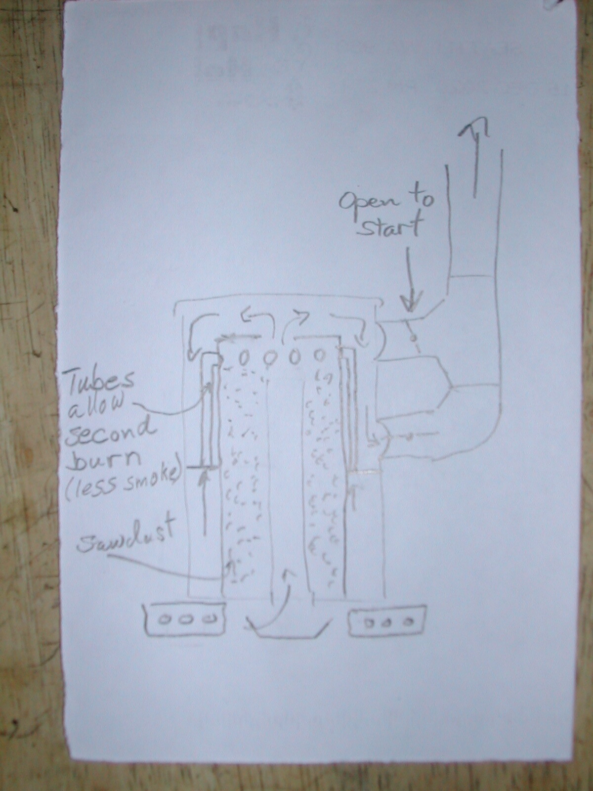

Thanks Kamil, We have this kind of thing too. Old style stoves are expected to make a little smoke. :slight_smile: Here you can see USDA stove from 1974 https://www.nrs.fs.fed.us/pubs/rn/rn_ne208.pdf I think we know how to make it better, because we know about tluds. Please add your thoughts.
I have not made this. It is only an idea.

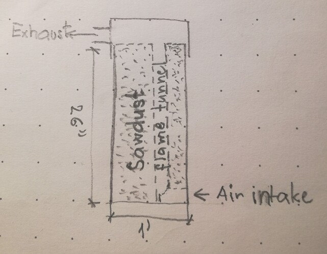

Thanks for the drawing both @KKubu and @r_wesseling. this should be a good way to heat a workshop with, which keeps the heat for so long, thank you.
Definitely, the concept is the same, @r_wesseling. That USDA piece is little bit more complex while certainly providing better heat distribution than our Satan. I also would warry a little about the air intake at the bottom, where it could be easily blocked by falling fuel. Also cover lid at the top prevent inspection during burning and most probably one have to wait till inner barrel cartridge cools down before exchange. If it is exhangeable.
I inspected burning many times and never spotted any smoke. The fire is very clean since the start and after getting hot enough it works like good rocket stove. So I assume no secondary air is needed for improvement.
If I would like to improve efficiency, I would focus on heat distribution by either hot air heat exchanger or let smoke run through masonry heater.
