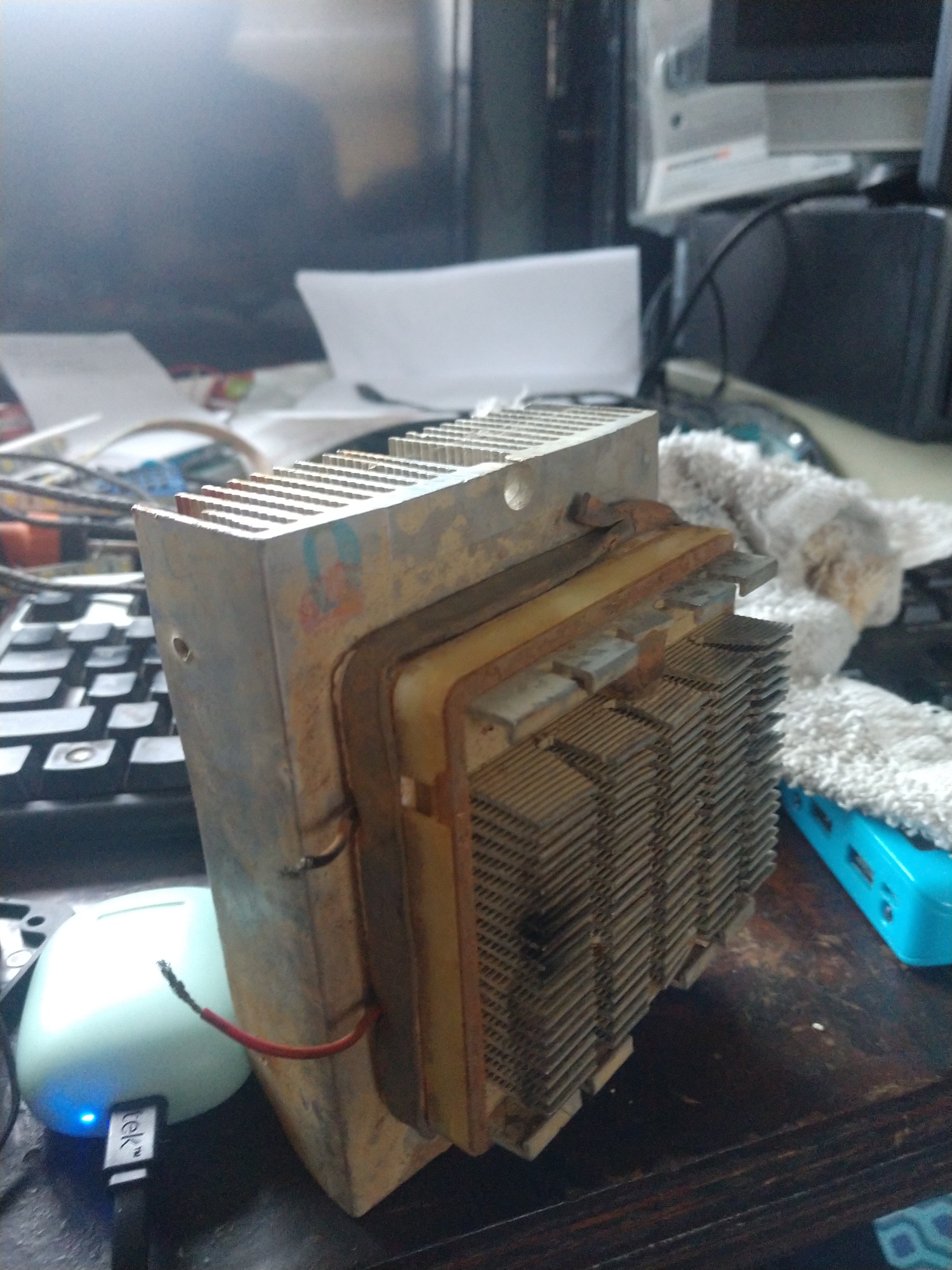

This an example of a 12v producing Peltier junction.

Those worked good in space because the extra cold made a good thermal delta. On earth the biggest problem is your device eventually become the same temperature on both sides as you simply can’t wick heat off fast enough without consuming energy to do it. I looked at that technology when I was working in the laser industry back in the late 90s early 2000s I will grant you the technology had advanced but we gave up using them on the laser cooling system quickly not because of the cost or return of electricity. There was grant money that made it cost effective if we could keep it running 24/7 we couldn’t without using more energy that we recovered. IIRC we got a design of a cooling loop that ran a few hours but no where near what we needed.
