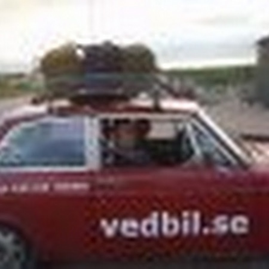

Try his site for useable video links and explaining’s:
https://www.vedbil.se/indexe.shtml
I just loaded up and watched these videos. Now my Windows 10 system is blocking them out. Too sad.
Push through and search up “Swedish woodgas tractor videos” to find. these real meat proofs.
