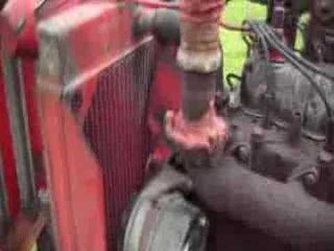

Hey TomC, Johan’s tractor “was” a diesel three cylinder David Brown (English?) that he spark converted modified using a Bosch/Volvo six cylinder distributor then using every other cap terminal. Diesel system removed. He adapted drives the spark distributor at the former diesel injector mounting location.
His and wife Jane’s kids? Doubt it. Nieves , nephews, neighbors most likely.
I’m nor sure if the third video Ford Major now woodgassed was originally gasoline or diesel.
I believe the Ford was an original WWII with the gasifier built right on it. It didn’t show this time but he took it out of an old barn and the gasket seal on the lid was shot, so he opened the lid and laid an old blanket over it and closed the lid. It sealed. Look close at the video and you will see the edges of the blanket hanging out.
Thanks for the reminder. I did remember him converting a diesel to gasTomC
