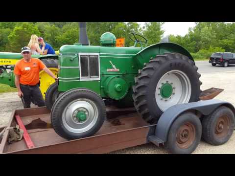

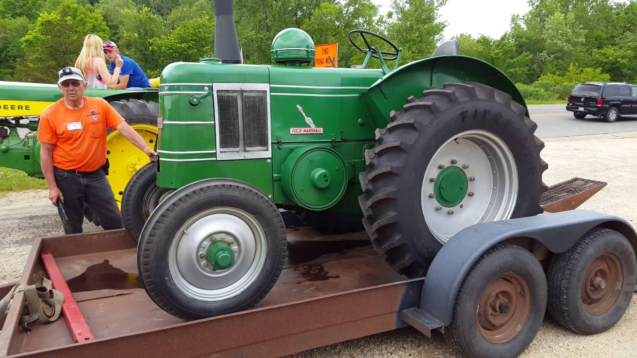

I wanted to see everything before I left the planet. Now I think I have. Nice looking metal work on that tractor.

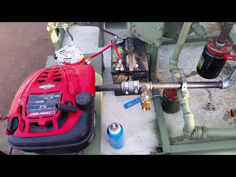

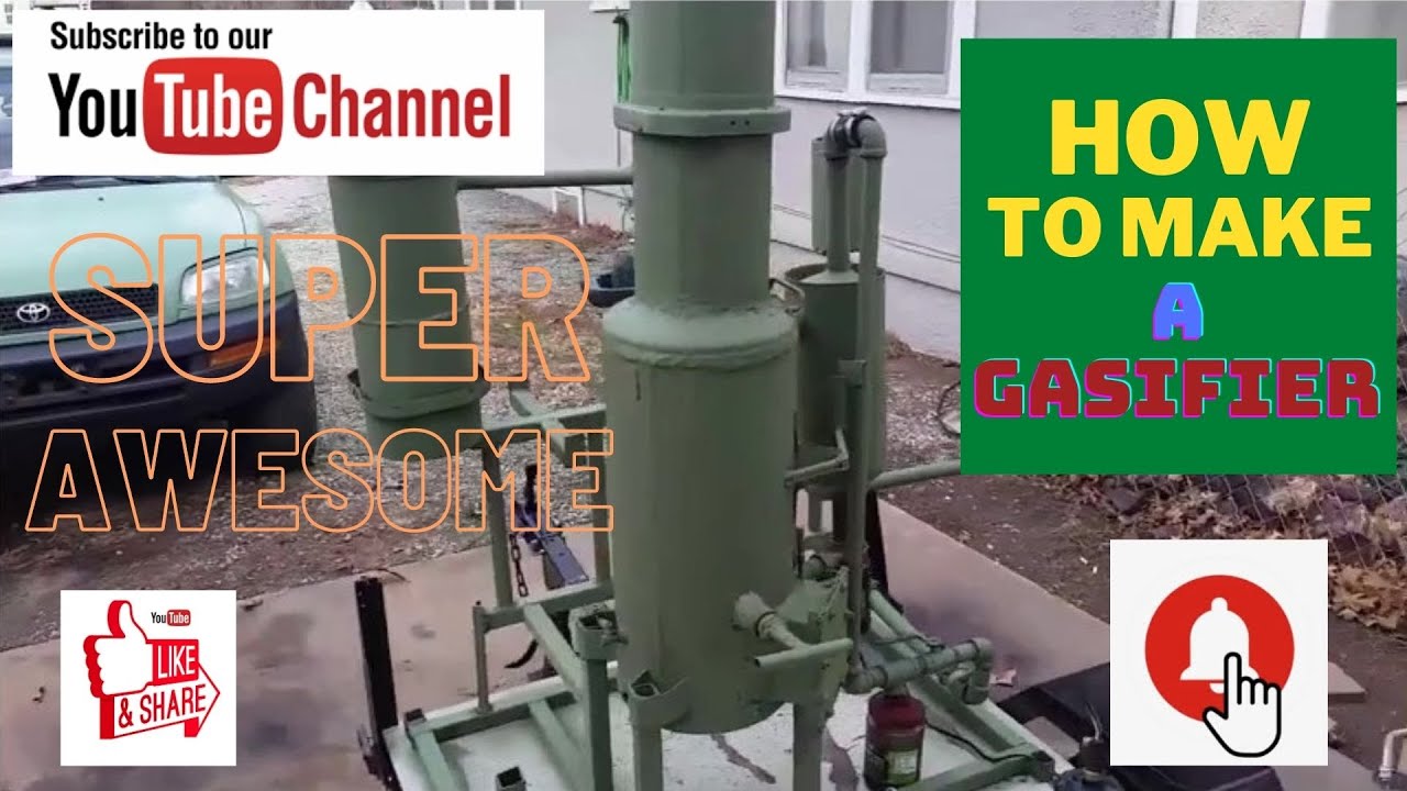

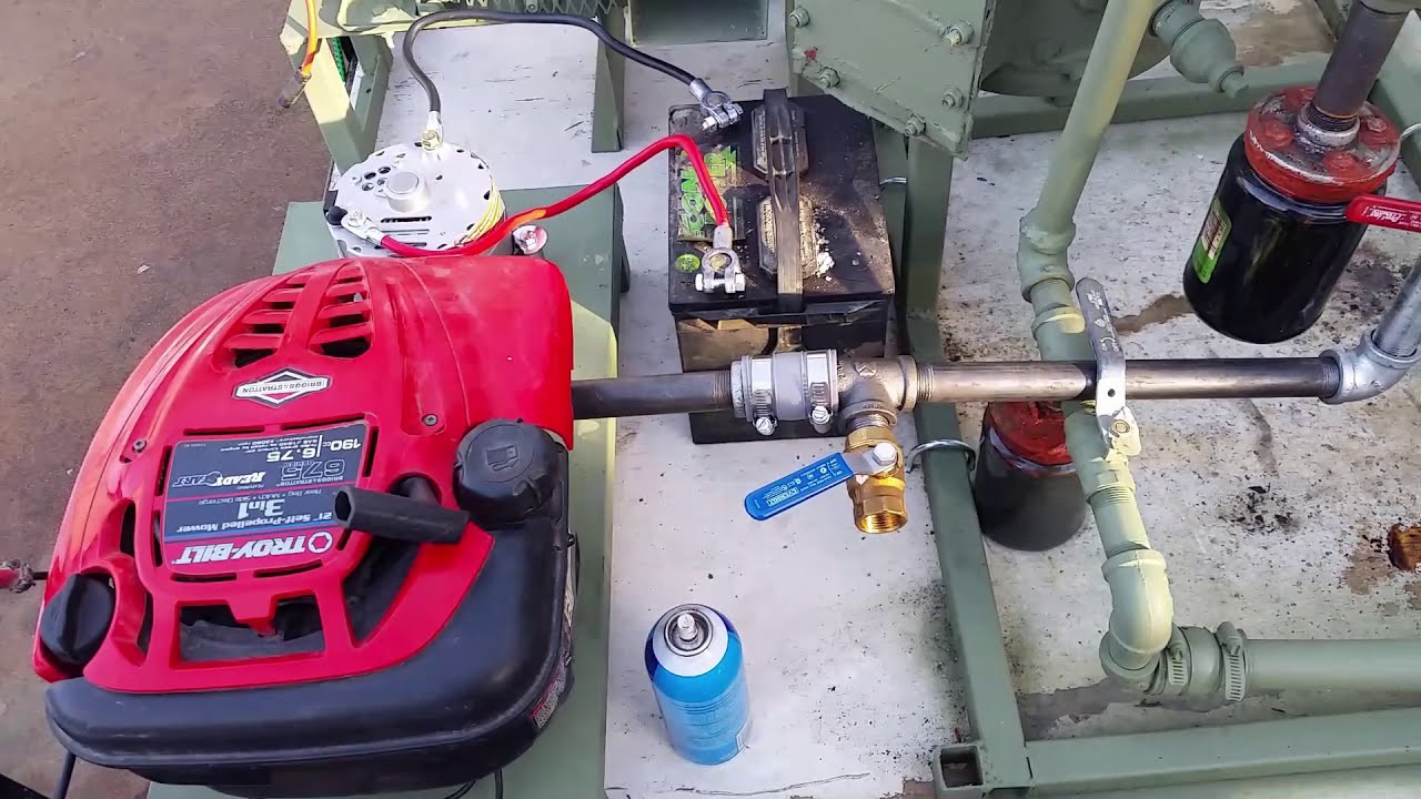

This is a video some homesteading friend posted for me. Finally getting some non-believers to show some interest. Don’t quite understand this gasifier and really don’t know what the thing on the trailer with the circular saw mounted to it. I guess he has other videos that may explain these things.
Hi Tom i think its a FEMA type gasifier
on his youtube channel is his gasifier build up in detail.
Yes as Dave says a fuel stack restricted air from above, so a Jet-less FEMA type. Made to fuel off of commercial wood pellets or wood chips made from his skillsaw powered chipper system you see on the bottom corner of his trailer.

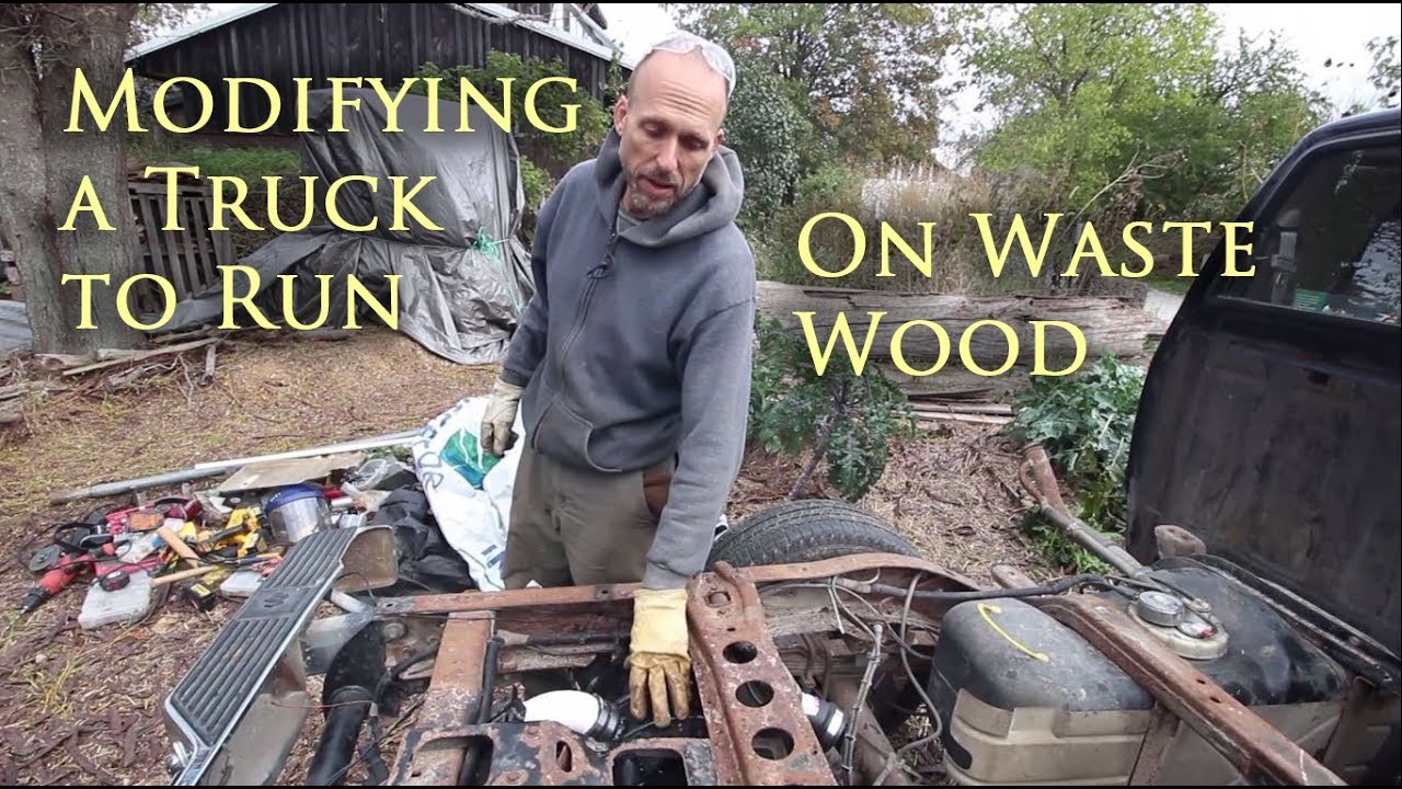

Any paying attention back on one of Joni’s topics there was a long vertical tube gasifier.
It had a tru from the die single center air nozzle.
It was making good flare gas.
Way back when Ben Pereson put up for a Mechanics Illustrated contest his EPS (Emergnecy Power System) pellet fed tiny gasifier. Vertical pipe with a single up the center air nozzle. Made good gas once heated up to stability.
Now throw some external insulation on this vertical tube.
Trail around with the center jet outlet. And be making good gas.
Hippy-skippy past all of the external froo-fraw. Run that produced gas just up off the bottom of a filter barrel can. Again see Joni. His vehicle system.

Tom , i read the comments from the people who watched that youtube video you posted and it seems there were all amazed that he was able to run engine from wood , so its not a bad thing that it brings more interest into Gasification , its how i started after all and as soon as i saw this black magic being performed in front of my eyes i wanted to have a go , my Fema experiment did not last that long once i realized it made tar and was a hard to walk away and leave running like a charcoal machine .

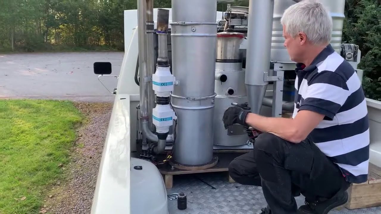

This is another Swede down south running chips. A bit too much complexity for my personal taste though.
Just one more.
Do we know these guys? We definately share the same source of information :smile:
I have to admit though, I get a little worried when they plan on draining tar from the rear tank.
