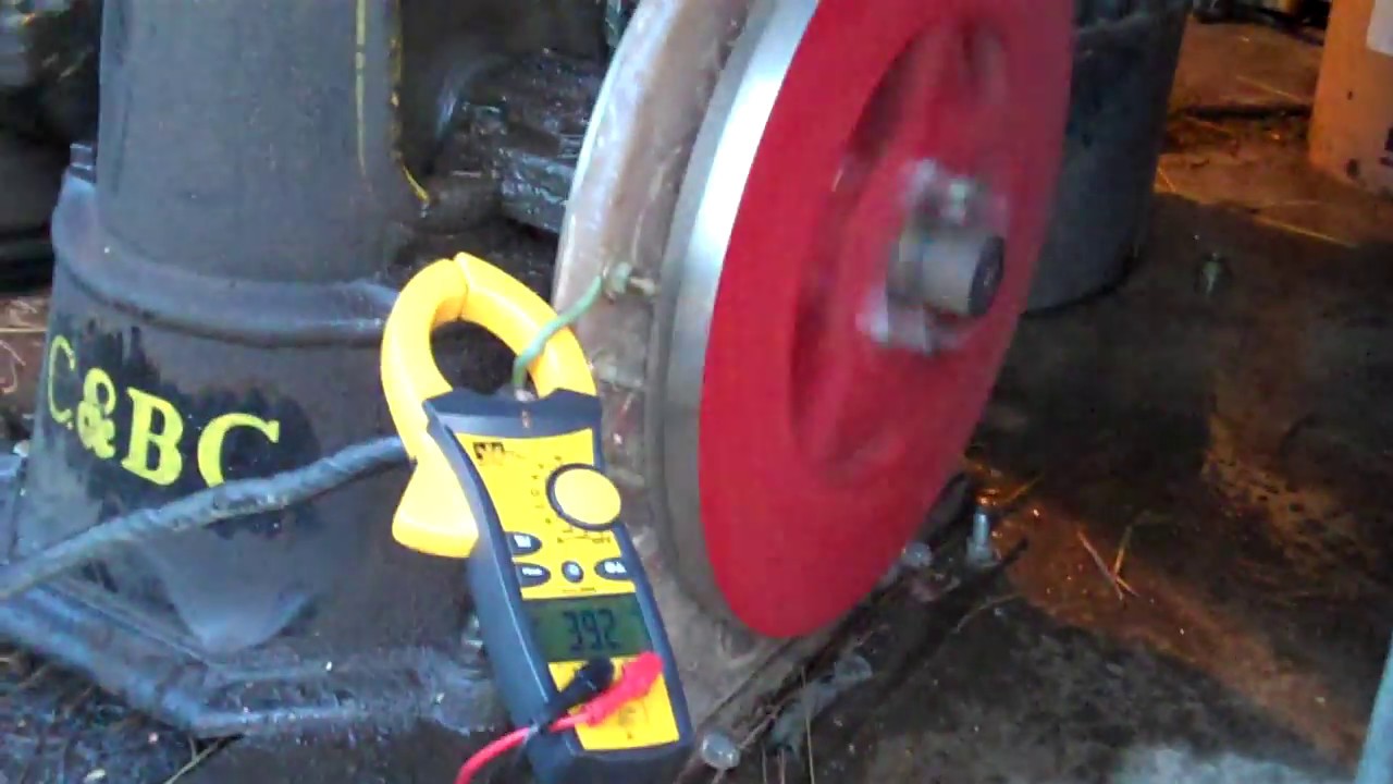

Hi all , i came across a lovely old steam generator on YouTube thought it might interest some people .

Hi Dave @d100f thanks for putting this home-power steam to electric system video up.
This is pretty much one of the same systems that was for a number of years every summer set up and demonstrated here.
A generational family-logging and farm operation. Grandma operated a farm English tea house. The Pomeroy House.
I watched real, live; and asked questions.
This small one was their 10hp system used to belt drive buzz saw up slab wood from their saw mill.
A larger one powered a sled steam donkey winch they demonstrated yarding logs and loading onto either rail car or restored early trucks.
Some details on this small one:
It starts at zero steam pressure with a relatively lazy wood fire in the fire box. Lazy smoky chimney pipe. Once some steam pressure is built up and the engine is working the cylinder exhaust steam is routed up into the lower chimney to greatly increase the draft flow rate. Note then cleaner visible firebox exhaust with energetic puffs pulses.
He refers to water level in the boiler. Easy to refill starting with no pressure. But under operation pressure not shown was a needed three cavity water pressurizing filling pump. Steam shaft powered.
All of theses for logging wood milling power plants were vertical boilers with small bed fireboxes. Have to cut and fine split wood at ~12-14 inch lengths. So no loading up and walking away for an hour or two. Needed constant tending. The donkey winch took three men to operate. Wood cutter/splitter. The fireman/lubeman. The actual winch operator.
Another reason for the constant need tending; was external lubrication of all of the moving parts. Have to re-fill all of the oiler cups. Steam leakage and hot water dripage washing off all of the parts.
Interesting the back ground surround pictures shows he is Pacific Northwest. He is electrical generating with a made axial flux windmill type system to match up to the low engine rpm.
