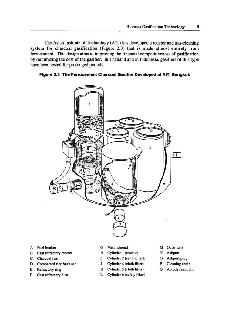

Steve, i did find an Thai style gasifier, used, tested and performed well
i will look up where the study was, but have the picture here already

Your AIT charcoal system looks interesting as using more indegious materials and nice being an in the ground based. Ha! “Down to Earth” we would say here (means practical, real people usable).
Puzzling to me though why they used such a comlex reactor system for pre-refined and densified charcoal. That part of if looks to be readilibly raw wood chunked fueled.

Steve,
my picture came in reaction of your statement
“Bluntly the Australian, Indoneasian and Thailand designers would be more wrong than right on how to make a gasifier system work year around up here in the great, cold, six months of the year frozen lands. They always design around water cooling, washing and filtratrion. NOT good for frozen areas. And frozen climate Designers up here no matter how talented are just as failure prone on how to make a gasifier system function year round down in the equatorial area’s of the world. Thier systems always undercool in equitorial ares and are too out of user regions matrials depemdent. Many, many documented reports of failures tring to do this now in the last 30 years. Read the onsite available here FOA 72 publication. A study in across world regions tech transfer failures.”
I can follow and do follow your arguments on conversions and so on, but i can think behind my own borders. Every link in the whole chain of economics has to be
considerate. And doing the best you can with the means and knowledge available leads to efficiency. the most efficient system does not mean the best system.
Think behind the borders, you only can do what is possible not what is best.
