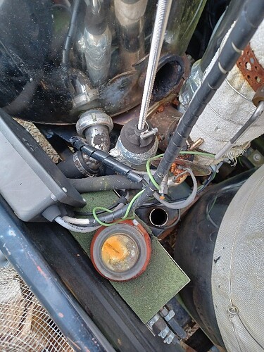

Sometimes i over-complicate things, this is view over the igniter and some “electronics”.

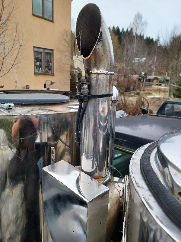

Start-up “chimney”.

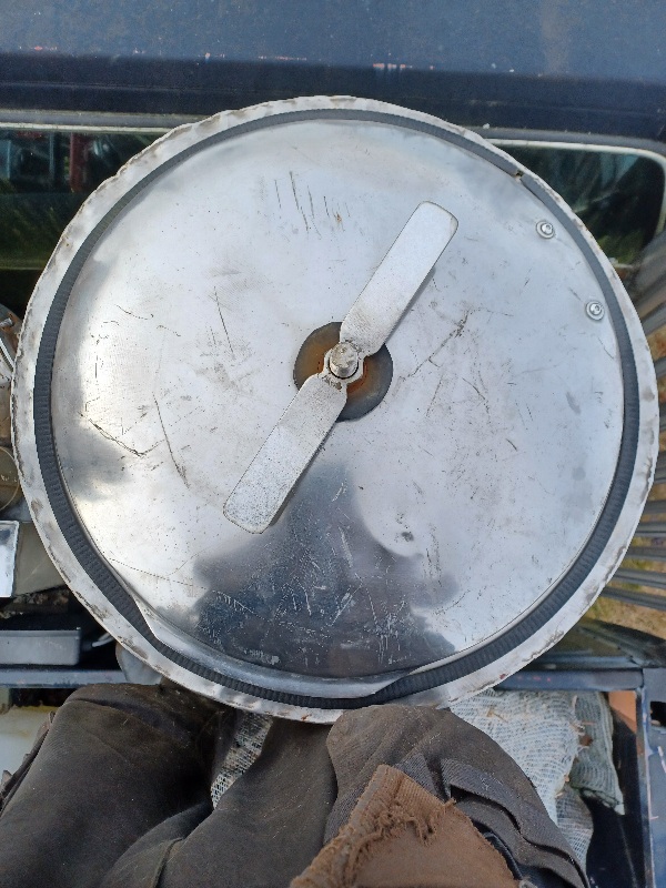

Filter from above, the lid is from a BIG potato cooker, from a commercial kitchen :grinning:

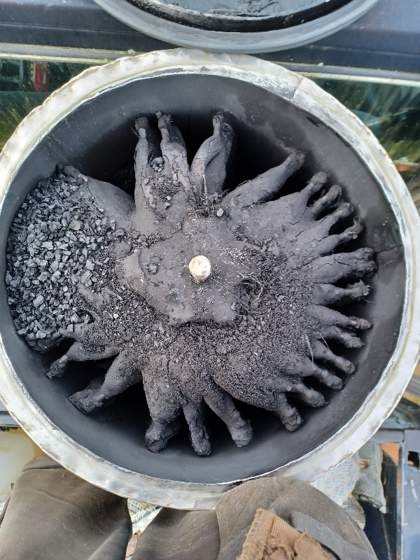

Filter from above.

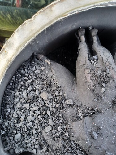

I probably should have cleaned this more often :face_with_raised_eyebrow:

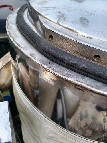

Lid for the filter, here is the same type sealing strip as Jan asked about in an other thread.

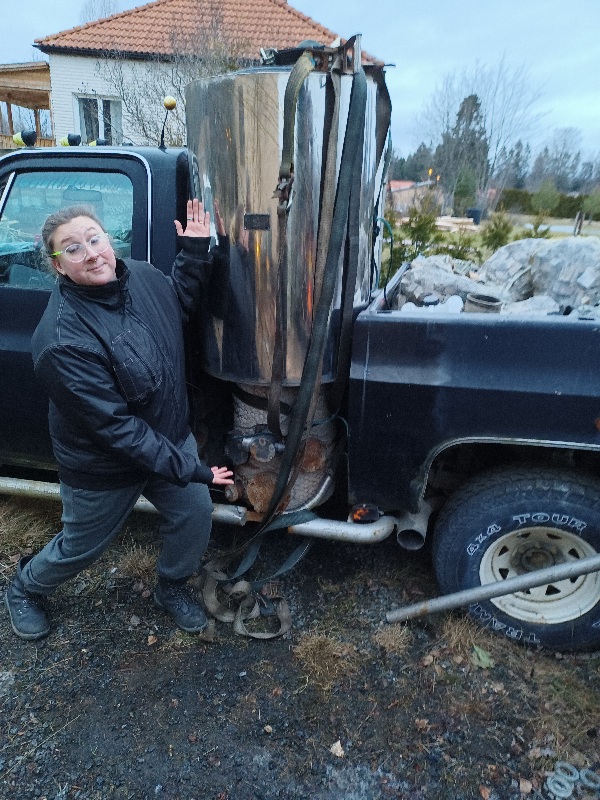

Wife showing off :slightly_smiling_face:
We at least she has a sense of humor about your re-association with your woodgas love.
Many of our wives come to hate our “mistresses”.
And your wife seems to have learned well woodgas working colors. Dark. Dark. Soots colored.
Thank you Steve, yes she is very “understanding” and accepts many of my crazy ideas.
She had even drove the truck on wood a couple of times.
Göran, you certainly managed to collect a lot of shiny stuff. If only things weren’t so busy all the time I would have been down there in no time to check things out. Looking forward to this thread.
She is 1 in billion on DOW! WOW! Tale her congratulations on that achievement. There is not many women who can DOW.
I like the auto ignite flair stack that’s a nice touch

Thanks Bob, yes i asked her if i get the truck up and running, i could film her driving, she didn’t look to positive about it? :laughing:

Thanks, i actually seen a igniter like this on a woodgas Mercedes many years ago and liked it, build one myself, the electrodes is from a oil-burner from an old boiler, connected with spark plug wire to an old coil from a Webasto diesel heater.
To complicate it some more i control it with a remote from an old truck loading ramp, it is very fun to have when leaving the truck at a supermarket parking lot for example, when curios people check out the truck :grinning:

Talking cold weather gear! Been years since I seen a webasto, don’t hear about them anymore unless you see a far north Canadian trucker like I talked about in the Detroit thread a few weeks ago. They still run them up there. I recognized the ignitor from a oil burner since I had my shop heater torn apart last week trying to get the ignitor system to work :rofl:
I could belive that, here in cold Sweden they are common, especially as i worked with heavy trucks before, this particular coil came from a Webasto from a bus, heating effect 40kw, almost the double from my house boiler :open_mouth:
Your filter looks like some kind of mutant turkey on a thanksgiving dinner table.
