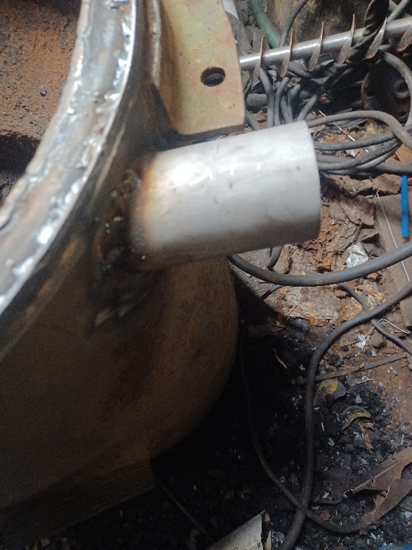

Welded in a pipe, for a sanitary coupler, for the condensate collector.
Now to decide which type of filter i want, and what space allows, also mount a cooler/radiator that flip’s/follows the hood.
