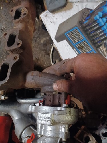

I have a turbocharger im thinking about, going to post a pic soon. VW 1liters engine, double/series turbo.
My thoughts has also been into superchargers, i got a cabin pressure compressor from, i think Saab j29, military aircraft, that may work, i’ve heard about people use them to supercharge smaller cars.

Here is the turbocharger i considering use, looks overly complicated, but no problem make it work, going to add a separate oil filter for the turbos, and maybe their own pump.
As im going to use a fabric filter, and use a very low boost pressure, i believe this may work.
Piping, and big “one way valve”.
Very small turbine on the “secondary” low rev turbocharger.
Giorgio, when I tested the Fiat on wood gas I had a very good feeling, the engine ran very smoothly and was very responsive, I think it would develop decent power, here is a video.
Goran, this turbine will probably work quite well, but a variable turbine with mechanical pressure control via a diaphragm that changes the position of the stator vanes would be a better choice, but use what you have at hand. I wouldn’t bother with an additional oil pump and filter, I would install an oil extraction from the existing installation, a fairly small amount of oil is enough to keep the sliding bearings lubricated and the turbine housing cooled, Fergie also has a fairly large amount of oil and a large massive sump where the oil it cools well, there is no need to waste time with additional things, this is my opinion.
Tone, that are good thinking all of it, if you look at the first pic i posted, you can see there are double turbochargers, the smallest one only helps the bigger one at low rev’s, the bigger is a vgt, variable geometry.
Unnecessary complex, but i have the stuff laying around, almost new, guarantee replacement at vw, only because they could make a “disturbing noise”.
Maybe the fergie has a good enough oil pump, i can tap oil pressure easily from a plug in the oil channels. A extra inline filter im going to use though, i have the filter stuff, and those small turbochargers could be a bit sensitive, the standard oil filter maybe let some nasty stuff through.
