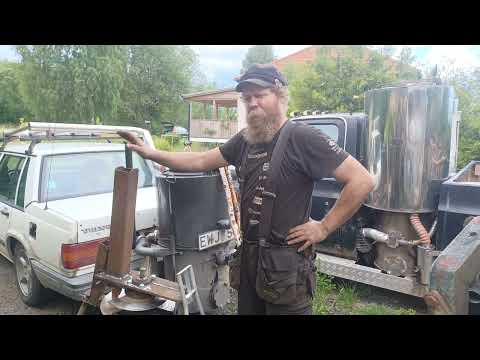

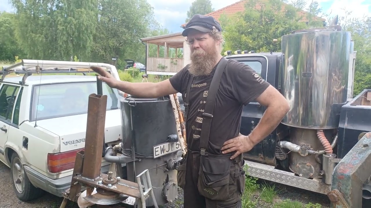

Another woodchunker for woodrunner.
I had som discs from a sowing machine laying around, and had the idea to make another wood processor.
First letting a pencil in a wire wind up around a fitting round object, to get the curved shape.
Cut it out and started grinding, this steel is hard as bear-shit.
I saved this old wheel bearing unit with hub, noisy on a car, but good enough for slowly cutting wood.
I found fitting axle material, grinded a key-way for my motor gearbox.
Welded the shaft in both the disc and the hub.
If im unsure if stuff is going to hold up, i double the welds, and thickness of material
Then i got in to the “flow” and build along, forgot to snap pic’s along
Test run, it really struggled, and the motor run HOT.
Some troubleshoting later… i found out the motor got a built-in brake, i pull that stuff, and it ran much stronger
Down the chute.
Bottom disc is adjustable, determines the lenght of the chunks.
Finished with a safety shroud.
About 5 of those discs strung together and you would have a nice screw chunker.
I like it. What Rpm is that motor turning and what it the ratio in the gear box. Nice and calm, quiet and safe. No risk of becoming Capt Hook. Might be a problem finding all nice straight limbs to feed it. Push comes to shove I guess you could shorten the hopper. ![]()

Hi Sean, i have about 5 more discs put away, and started drawing a spiral/helix? on some stiff cardboard… great minds think alike?
Thanks Tom, i will check the speed/ reduction and come back later.
