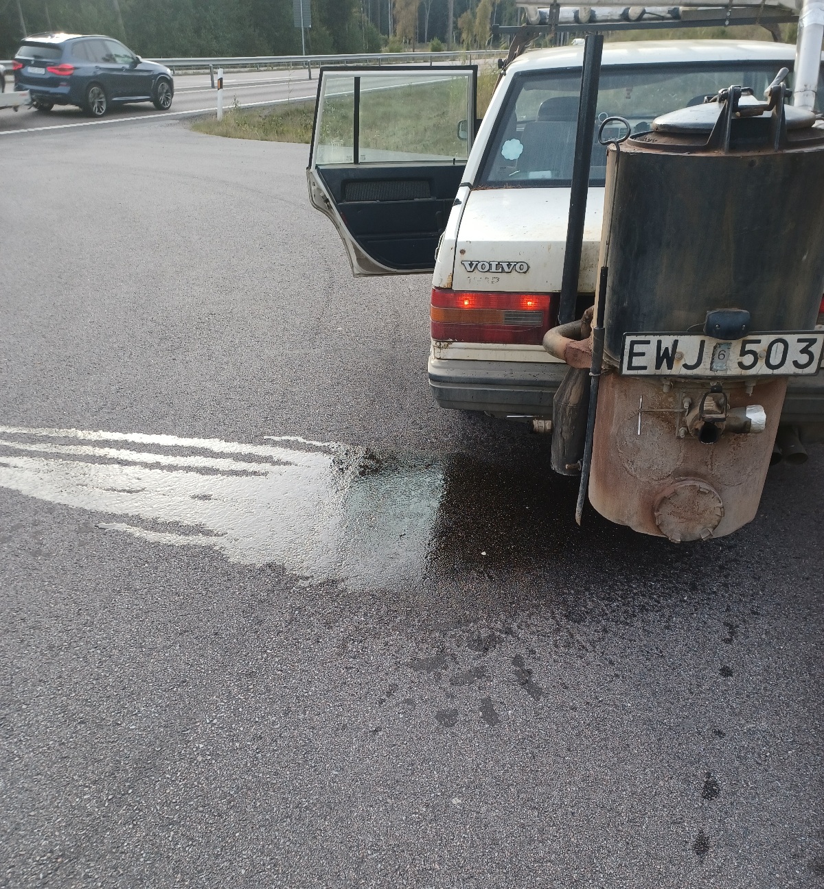

Oh, and another fun thing that happened with that volvo: once i lit the gasifier, and some curious people was standing to close, the gasifier “sneezed” “pffrrrrrtt” it sounded and it sprayed all the tarry water standing in the bottom groove, on the bystanders. :rofl:

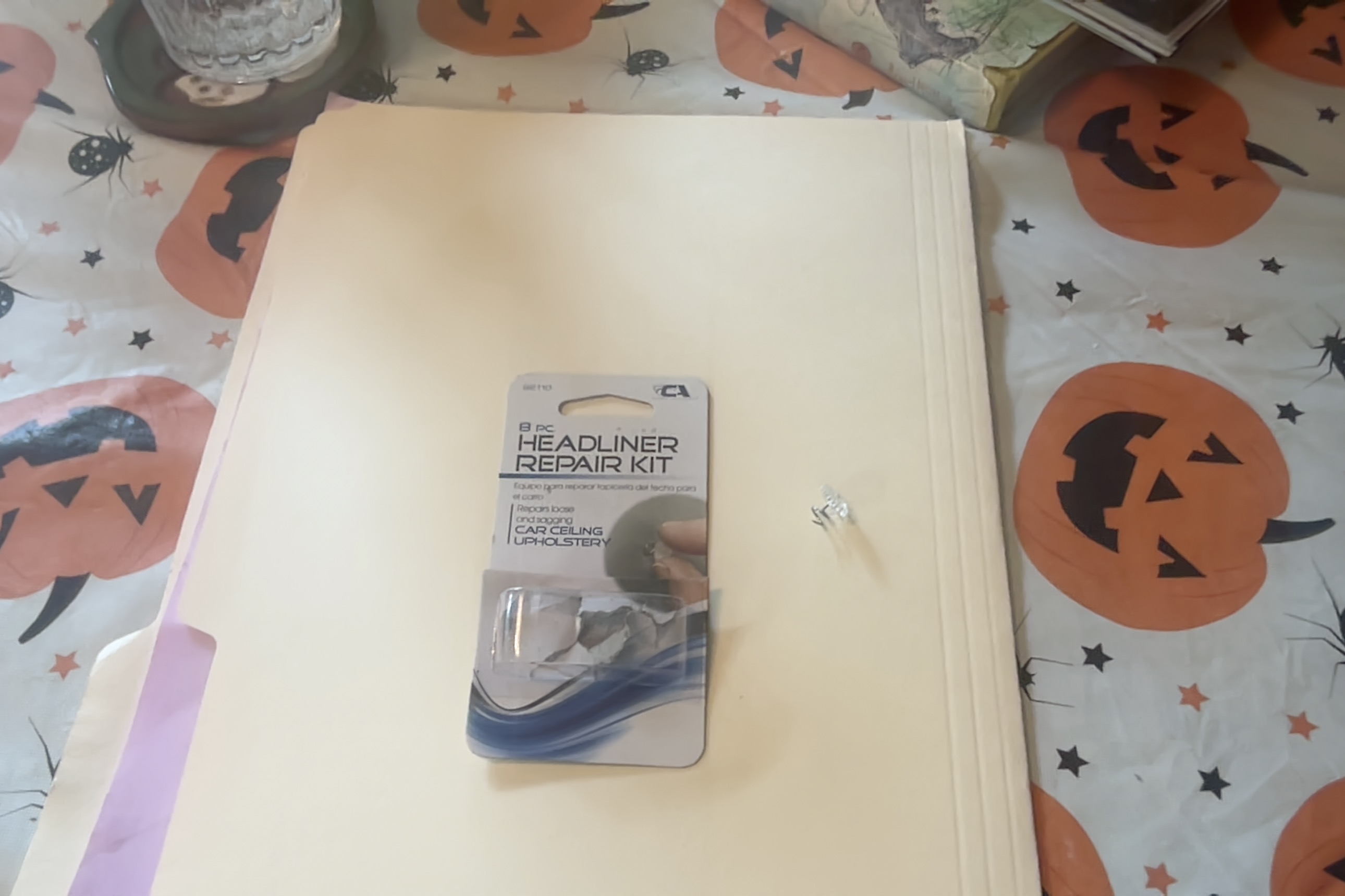

So I use a commercial reattachment product:
These need to be sharp point pushed through fabric then through the fiberboard base.
Twist screwing tightens them up.
