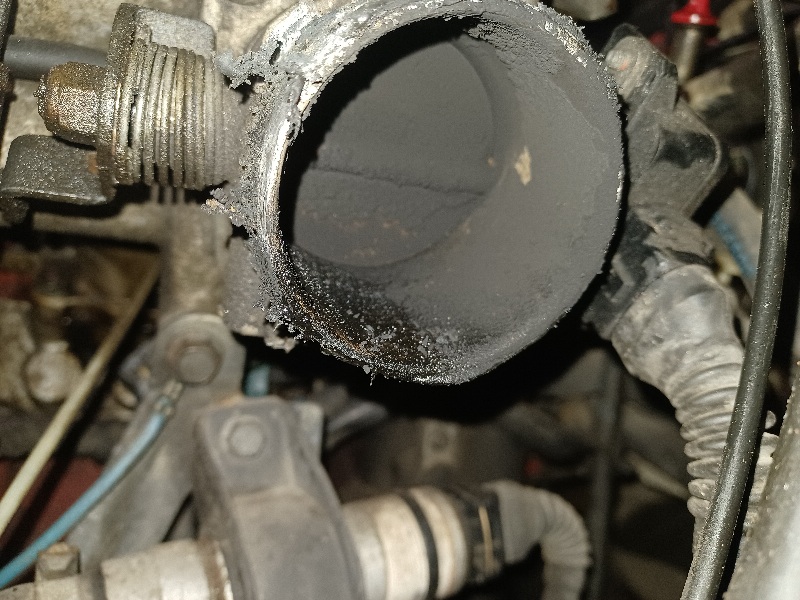

Fixed the stuff on the Volvo today, now it will pass inspection as soon i get a appointment.

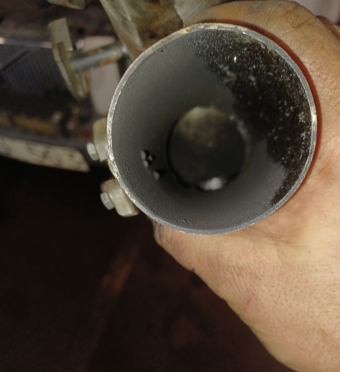

I pulled the mixer, and put back the plastic elbow.
Not that much soot in there as i expected, filter seems to work well, still. Edit: the runny stuff was not tar, it’s oil from crankcase ventilation

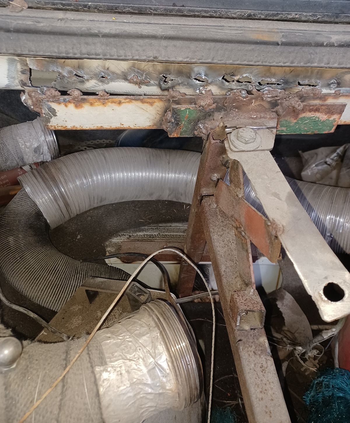

It was in time to start rebuilding the gasifier stuff, when i checked, the upper “attachment point” has started ripping off the welding points, much due to the bumpy gravel road i drive daily.
I pulled all this iron out, next gasifier will sit in the trunk.
