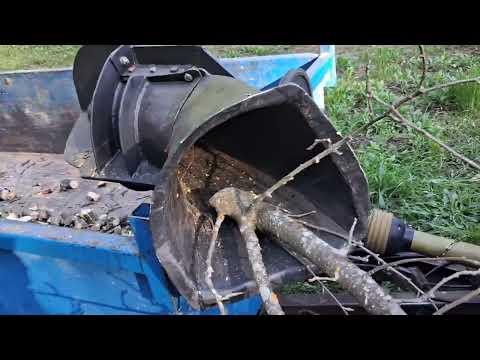

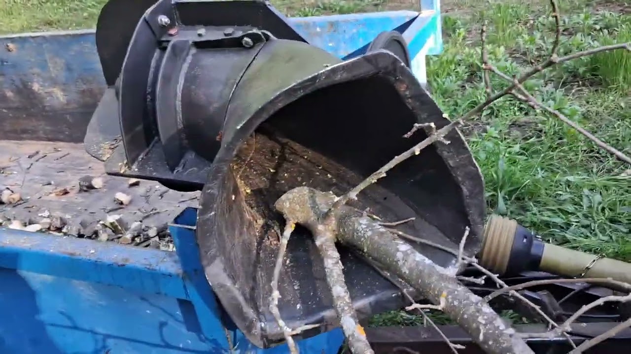

Finally the first test…
What a great tool!!!
Great work Tone, super-nice :+1:
Now i can’t show my screw-chunker anymore, i have to hide it away… :pensive: :crazy_face:
Sorry Goran and thank you, I feel a little rude for intruding on your topic, your wood chipper works really well, you don’t need to hide it… :smiley:
First, you get style points for the triangulated rear bearing mounting. It looks cool. :slight_smile:
However it will probably have to be somewhat covered up since the chips are not all landing in the wagon.
Is it actually pulling the brush in or did you have to push it a bit?
What is the spacing between the flights? it looks about 8-10cm. But I have to ask.
That looks like so much fun to use. It all looks very professional and well build. I really like how compact and simple it all is. And mounting it on that trailer really makes production streamline.
