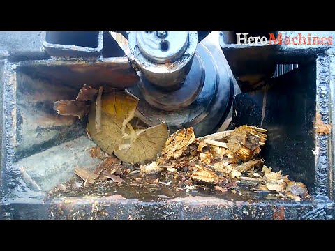

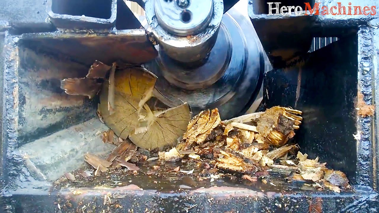

I tried cutting dry and fresh wood, of course it cuts fresh wood easier, but the blade still gets quite hot. The Czech screw chipper I bought has a turbine for ejecting wood chips, and at the same time it draws a lot of air through the chipper, which cools the blade well, but despite the intensive cooling, the housing gets a little hot.
In the link you can see that people use water cooling of the blade at slow rotation. My goal is to cut up to 10 cm thick with as little friction as possible, which reduces the load on the chipper structure, the load on the bearings and the driving force …
Tone, culd you not just install a sprayer nozzle to soray a mist of water on the blade? Shuld lubricate and cool the machine real well.
He can which i think is the point of showing that video.
The friction itself might be coming from the thickness of the blades. It isn’t a very sharp angle on the blade and it is thick metal, so there is a lot of rubbing against the blade where it isn’t actually cutting. It is really just squishing the wood.
