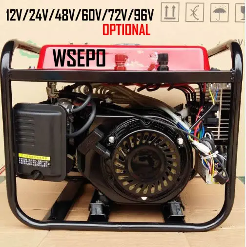

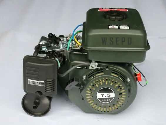

Hi Wallace
if I understand
the big advantage of this type of electric generator is to be disassociated from the demand power of a vehicle engine ?
(it is the battery that releases the power in synchronism with the vehicle )
but does this generator adjust to the charge of the battery?
should it be restarted whenever the battery requires it?
Thierry
The answer to your questions is basically yes.
The charging set was designed to extend the range of an EV.
Alone 5 hp is not enough in most cases to run even a small electric cart.
But added to an EV.
This might double its range.
If you can slow down, even stop and wait this will likely charge a car in a few \
See images in this link for how these are used in China.
Chinese electric cars are not so good
But in some places its all you can buy or it is cost prohibitive to try and liscence a gasoline or diesel car.
That is where these fit in.
Its a stop gap measure to improve the range and performance of these cheap Chinese Evs.
Here is a real slick unit for stationary aplication.
I have a dealer on ebay that i have bought tractor implements off a few times, and 3 years ago while he was filling a container up in china i asked him if he could bring 3 of these small 24 volt stationary generators back for Brian and myself and 1 spare , i think i paid with shipping about AU$200 each for them , nice and quiet little units but lacking in power when run on charcoal , great if you run out of charcoal and run on petrol though in emergency’s .
Dave .
