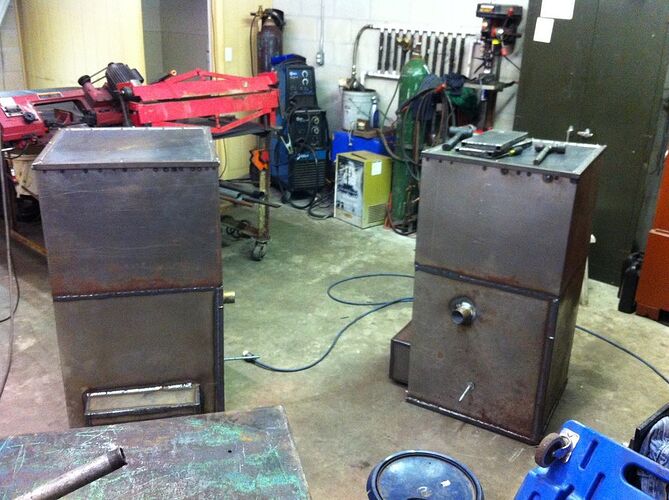

Time to dust this thread off a bit. Been busy welding lately.
How ya been?
Conspicuous in your absence, you were :slight_smile:
Square holes and round pegs… Lookin good!
TerryL
Looking good Sean !
Are you building two trucks or planing a spare gasser . ?
BBB
Looking good Sean …
Hi All!!!
I have been great. Got the new shop setup and already completed a few projects. Glad to be back on woodgas again.
Terry
Yes indeed!!! How are you doing ?
Thanks Wayne
I am pushing hard for two at the moment. With a third not too far behind.

Hi Sean, You square :o) … What are you using to brace the sides ?? You are maybe the only one that uses flat materials. I think you added some cross braces on an earlier one. I’ve been running tests on my new one. I’m using copper tubing for nozzles. It seems OK after 3 hopper fulls … It’s been so windy here that after shut down the core of my char gets cooked out. Next light up it takes an extra minute or two to rebuild a new char bed. I haven’t added the outer heat recovery shroud yet which will also close the nozzles off. I’m just putting 8 bolts in the nozzle holes right now. My lid isn’t sealing right either. I’ll add some springs to that next. It’s still friggin winter here … Ground is frozen down many feet right now. Was 12 degrees this morning. I ran a flare for a while today along the ground and melted the driveway down a couple of inches with it. Blow some of that warm Florida air this way and keep building. Thanks, Mike

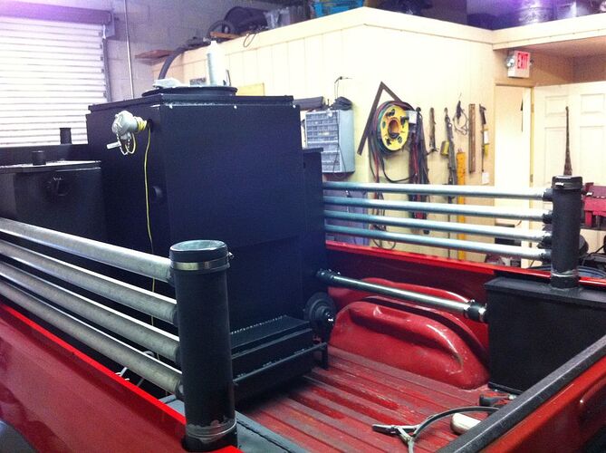

Sean , The truck has been doing good .Getting some miles down .
Got it running!!!
0-60
Here are some short videos. Planning on more next week.Details to follow. Truck runs very strong and smooth.
