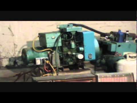

Onan is what I know best but its by no means unique a JB comparable to the inverter units you guys are talking about is 60 cubic inches, almost 1 litre!
And this is not an antique this is a modern OHV engine. ( made right into the 90s almost unchanged for 40 years )
Looks at the difference in size the big units can shed heat.
They are made of iron they don;t flex.
They hold a gallon of oil.
It can pull a rated 6000 or 7500 watts ( and has a little room for overloads ).
Compare this to a Chinese inverter.
The math works out the engines are about 10% smaller in capacity.
So assume a minimum running amps about 10% less.
Also these are aluminum block engines, they don;t have oil pumps or babbit bearings and steel rods inside.
They are not able to work like big engines, thats life.
If you have a variable load, thats where they shine saving fuel at lower power setting than a big set.

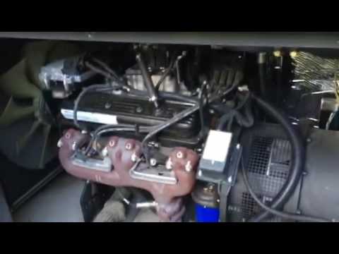

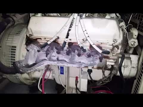

Here’s a bigger unit, the math still works however.
460 Ford industrial engine ( beefed up not a vehicle engine ) 30kw Kohler electrics.
Your looking around 60 to 75 cubic inches to make 7500 watts at 1800 rpm.
Well in excess of 500cc 3600 rpm 7500 watts if you want to look at it that way…
Light duty standby unit - emergency unit…
305 cubic in GM engine 45 kw head 3600 rpm.
Quality stuff but its all hair and teeth to do it no room for overloads and a short and brutal life at those RPM.
But its a standby unit only works in an emergency or when exercised for short periods.
it will wear itself out and need to be replaced not because of hours working, but hours screaming on a by weekly exercise cycle, that’s just life…
Again do the numbers, engine size RPM power output..
