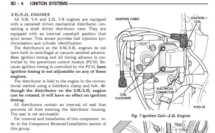

Wayne has stated above the reasons why the v6 dakotas won’t work with “advancing” the distributor. The distributor on the dodge magnum motors (92 onward) does not affect timing but electrical pulse of the injectors via the camshaft sensor (located in the distributor). The dodge Manuel specifically states timing cannot be changed by manipulation of the distributor. I think it was by blind luck alone that when the distributor turned by one peg it advances the timing 45 degrees which just so happens to help produce more power from woodgas. There is no graduation (only binary) of timing advance with turning the distributor i.e 0 degrees or 45 degrees with v8 or 60 degree with v6 ( which has shown to be incompatible with running an engine).
On the chevy/GMC trucks that Tom C talks about the rotation of the distributor directly affects the spark advance of the SBC engine. There is a bypass wire that can be unhooked and the distributor turned to set the extent of advance or retard the engine is to run (on 88- 95 chevys). This Is true up to 95 chevys (and maybe beyond) however I have no experience with post 95 chevys, hence the difference in opinion in v6 runnabliity comparing the dodges to the chevy’s
