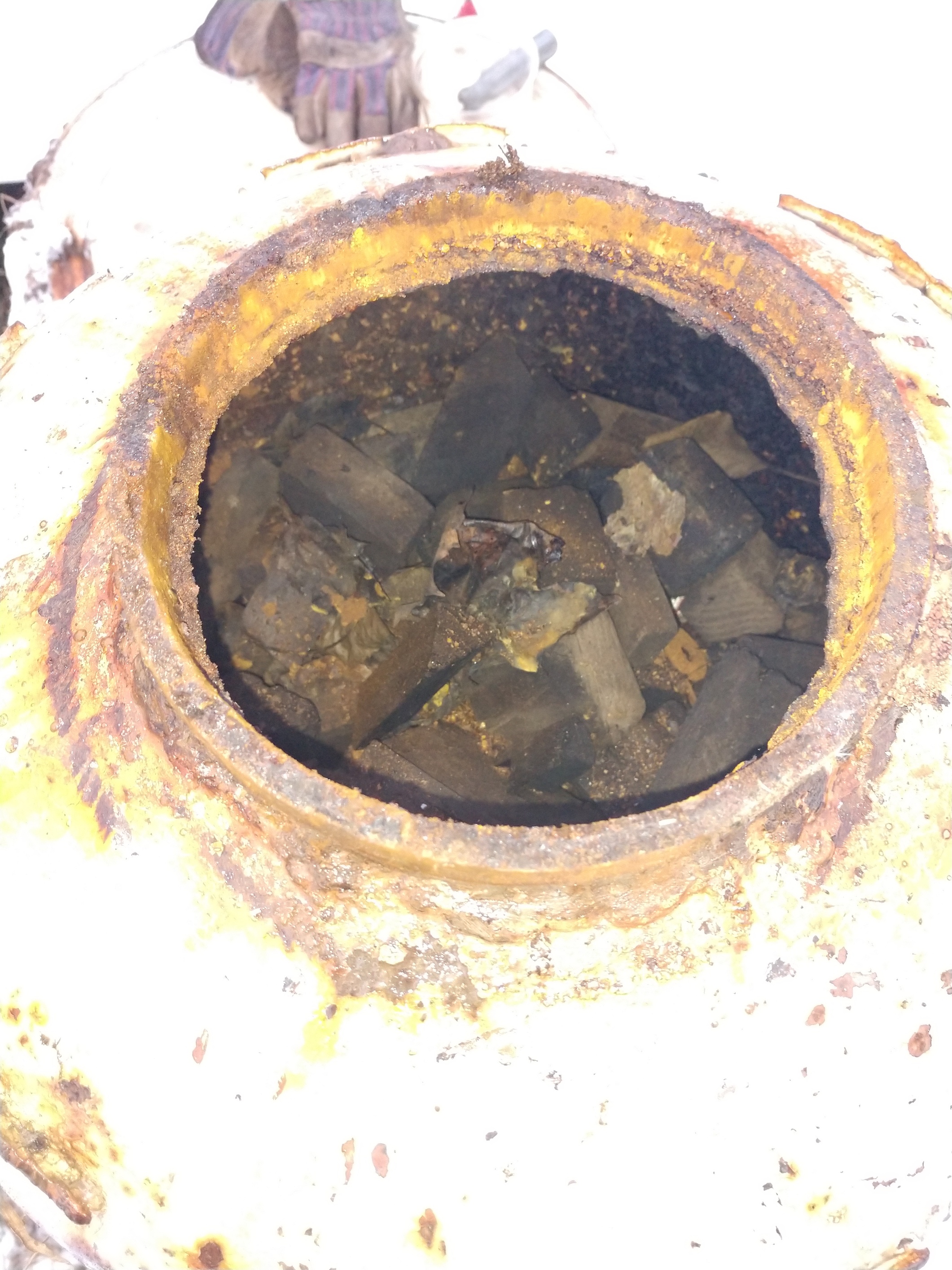

After 8 years the wood in the hopper is still good.
Drying the wood in the hopper.

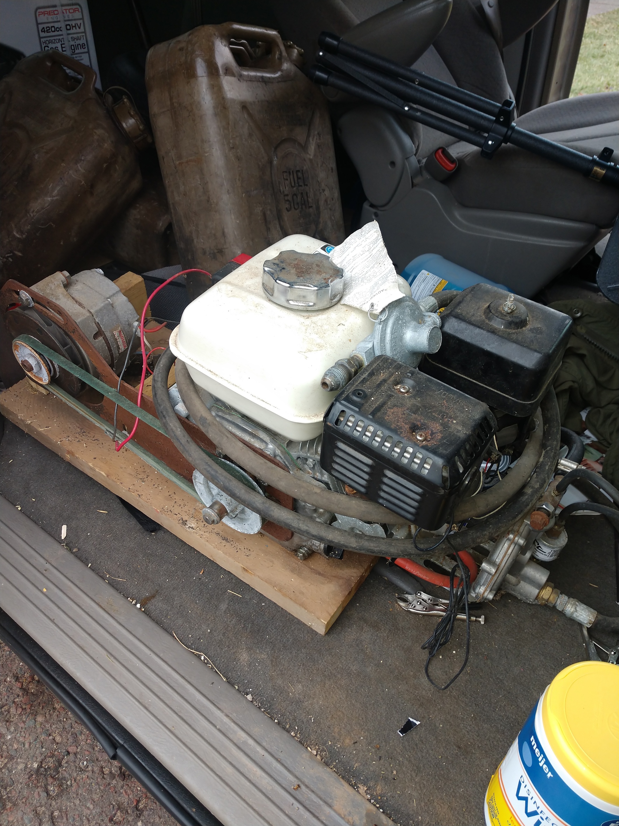

I know this is a distraction…but this just came to me from Craigslist. $200. After three different rides it finally made it from Iron Mountain, MI to Hancock, MI.

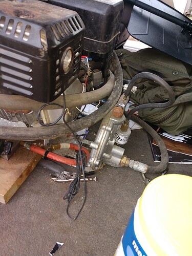

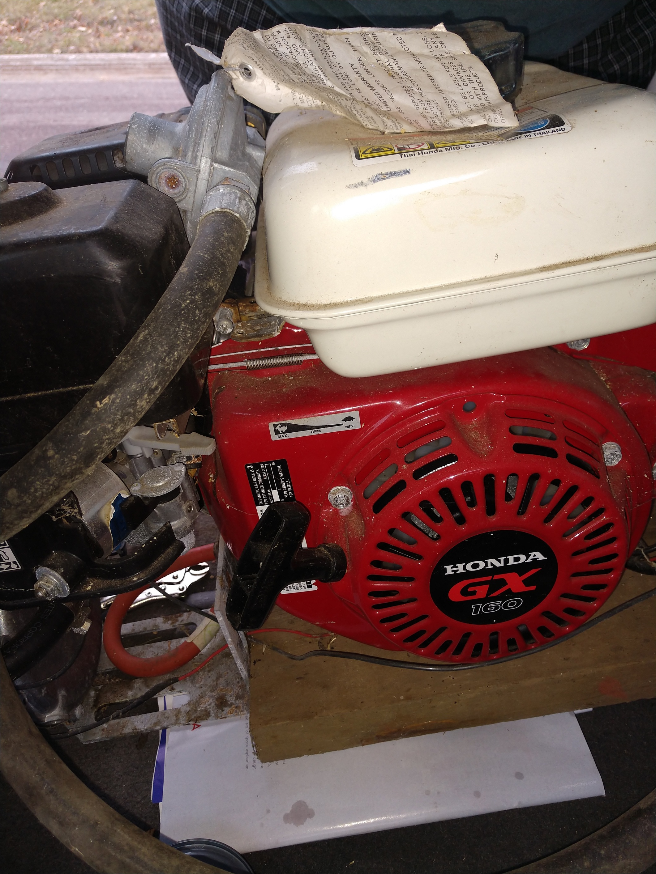

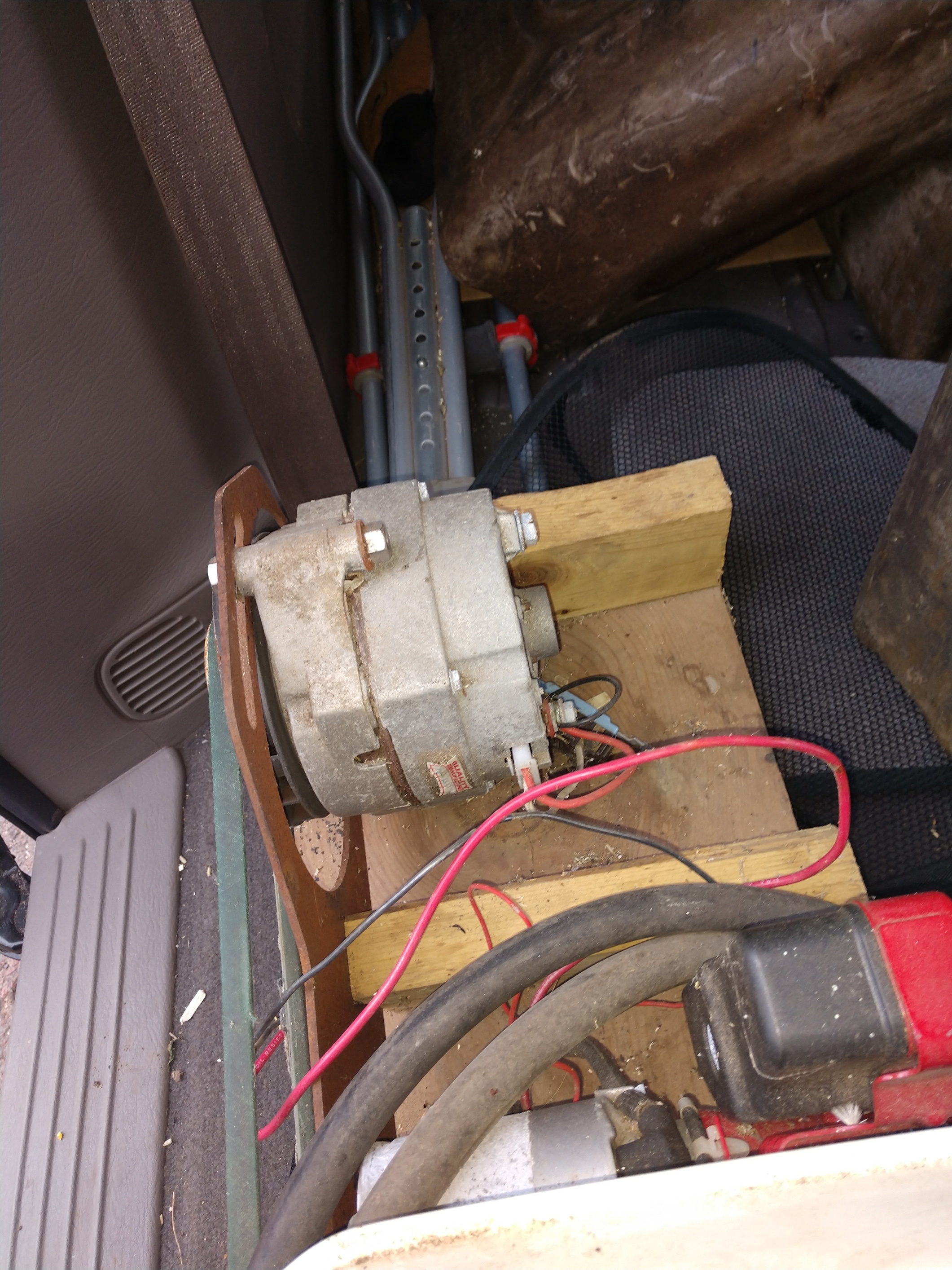

An actual Honda GX160 gasoline engine with a propane conversion. It still retains the gasoline tank and carburetor. It has a SI12 GM alternator.
I think the solenoid thingy is a propane enrichment valve…for starting. Not sure so chime in if you know. Pls
If I can master this fella, I can get away to the shop and get some work done. This thing should charge the house bank, while we go through the solstice.

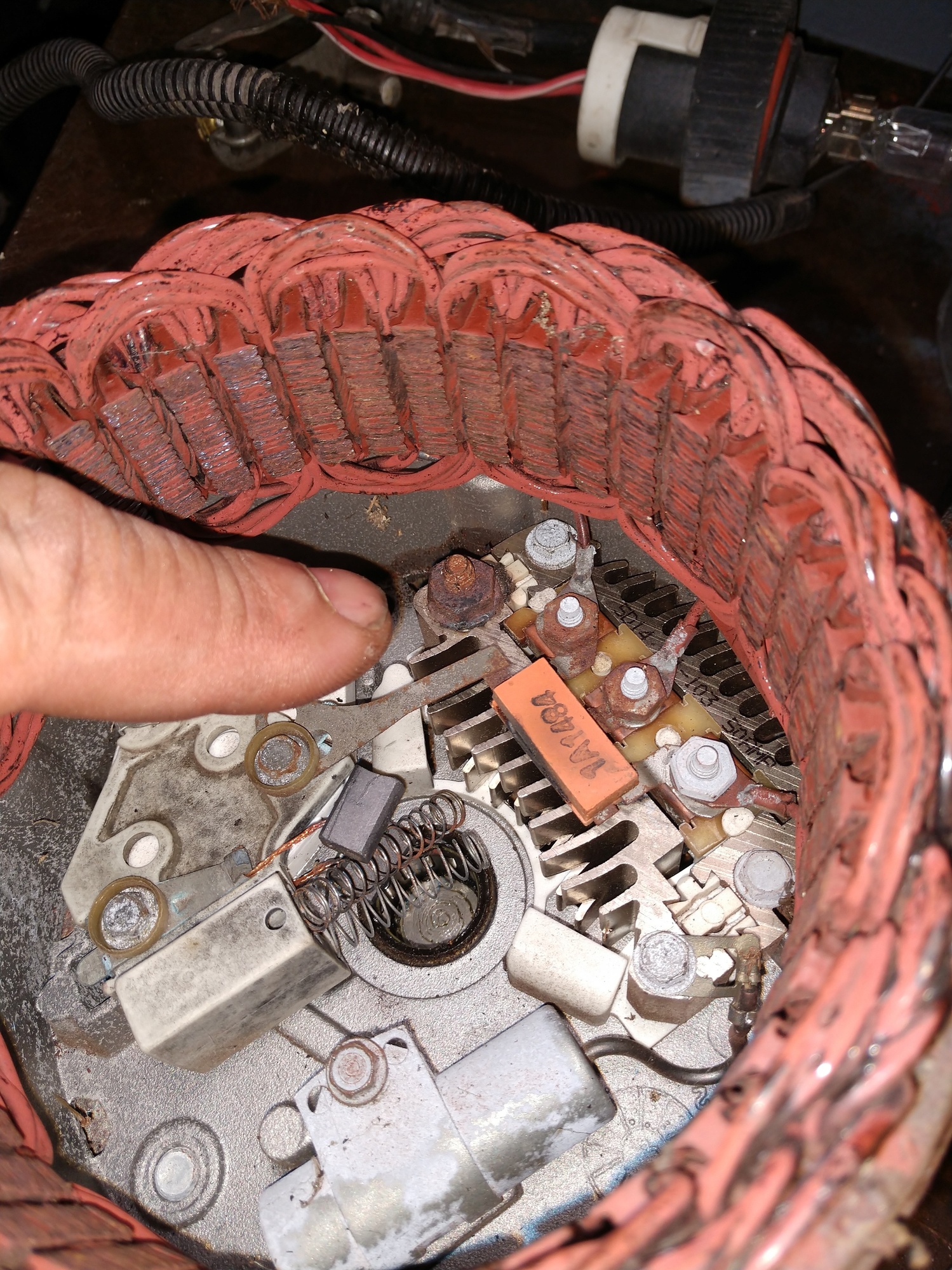

Not so fast with the Honda/12si setup…same old story, diode bridge problems. I am glad parts are darn near free!
(Note, I punted and just changed the back of the alternator, and got the whole thing working)

Most of those had dual intenral fan Nippon Denso alternators. Solid units. Dual isolated field terminal, external voltage regulator units. Can get aftermarket retrofits if the reg in the PCM goes bad.
Then the since the late 90’s Ford internal dual fan units. Also very solid units. Their back mounted voltage regulator/brush holder can be easy modified for external remote voltage regulating too.
The late model in the last 15 years GM dual internal fans units too.
ALL of these have 17mm drive side shafts. With nutted pulley retention. Pulley swapping is easy.
You could run that Honda engined gen set up on free scrounged alternators for a 100 years at least.
