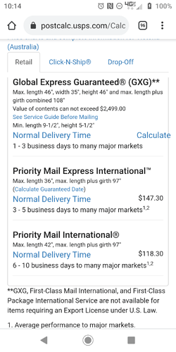

That said, if you want the makita, I would happily buy it and ship it for you. I will ask at the post office next time I go. I ship to Deutschland occasionally, so I know the drill.
Ooops where do you live?
So something around $600 or less for the saw and shipping.
Thanks for the offer Bruce so many kind folk on here , only hope i can return the fav some day to others .
I just worked out the sums and that amount’s too $801 Australian , still a great deal compared to what Amazon wanted for the same ,model .
I will check with post office about shipping of li-ion batterys as i had a camcorder seized and never returned by Ebay global shipping due to the fact it had a battery in it , if because this item is brand new then they may allow it i shall check it out .
