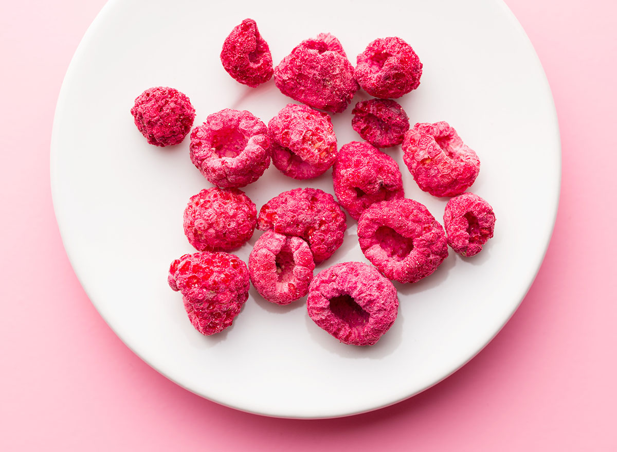

Hey Chris I think saying freeze dried fruit is bad might not be true, I’ve done peaches, plums, bananas, grapes, apples and pineapples and they are very good as a snack, one of the reasons I got the freeze dryer was to give my grand kids healthier snacks than candies ,most of the freeze drying sites claim they are way healthier than candies,I don’t think they get more sugar after drying than they had before, unless you eat more than you would fresh ones they have same benefits as fresh because freeze drying loses very little nutrients, not like dehydration.I prob watched 100 videos and researched 100 hrs before I spent the money on a freeze drier.
That “unless you eat more thain you wuld raw fruit” part is probably the key here.
Maybe but I can eat a whole banana or peach but it’s hard to eat that many pieces of freeze dried fruit cause it’s more tart and dryer but maybe some people could.
Good article and confirmed what I thought just like Kristijan said.
I think some fruits more than others would be easy to overconsume, for me that would be small fruits like raspberries, strawberries and such.
How does freezedried whole fruits and berries react if you were to try to rehydrate them again, is that possible with a reasonable good result?
