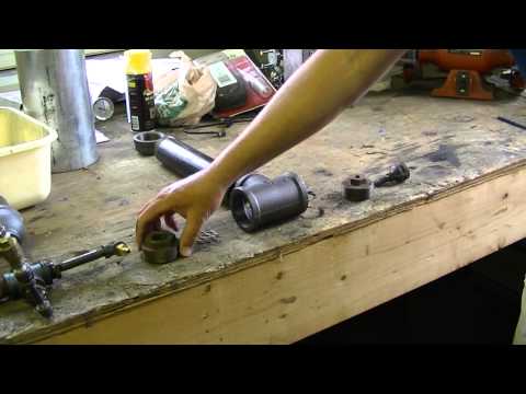

Does this happen to be similar to what you built?
Bingo, thats is. Thats the one i tried. Ty I tried 3 other wood gasifiers and a simple fire but when creating nozzels, i know id have to replace them at some point and so thats the first charcoal mix one i tried. Ty. welded up a rad and tried a bunch of differnet filter mediums. I did plan to adapt it to a tilt 45 down/cross, make it stainless steel and connect some in parralell or series with a rotating plate so each had some cool down time.
Ive tried to show my dad that vid for a while and couldnt find it again, but ive been finding new vids ive never seen before on my youtube, Tyvm. That guy is super smart and has gen stuff but yeah, that help out tytorial one is a nice starter fun way to get started enough to try blowers or somrthing. I know itll never be big enough to drive on which is my dream but its a nice way to start just creating something and get a light going. I rhink i tried enailing the guy with questions when i first heard about all of this stuff. I have theorized with steam injection and 2 burn chambers, so i am for sure square one trying stuff out but for now as long as I don’t know filtering, im not really in the game because im too scared to try any designs or builds on actual use. I should probably learn engines but im pretty sure its just all beyond me. Timing, misfires, cylindee heada and boring holes, or carburators. So i would only ever try any build once I know filtering perfectly. Then I can start on designs. I thiught actually that it wouldnt matter what fuel was used as l9ng as filtering git figured out but im seeing from this thread that itll never sadly be that simple. I wonder if a water bubbler and or electric cleaner would work?
