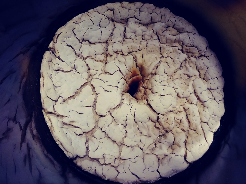

Did some more baking and also wore out my welcome at this oven. :disappointed_relieved:

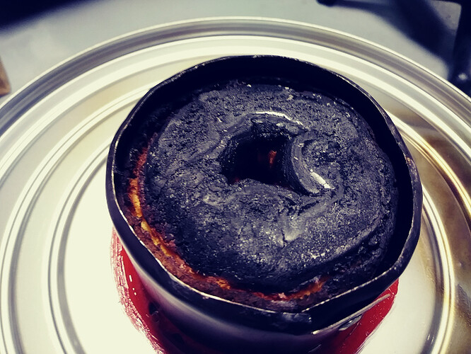

The large diameter shrunk about a 1/4" on the radius or a bit less. The bottom small diameter also shrunk a slight amount. Now it is loose in the bottom of the ACFC. I think it will be much better to make this in two parts and in two molds and use a small oven that would be much easier to find. Even an electric small counter top oven and then the air could be blocked off so not to burn up the charred bread. Of course I am not too sure if a kitchen oven can reach high enough temperature to carbonize the bread.
After more baking…
Top looking into:
Bottom:

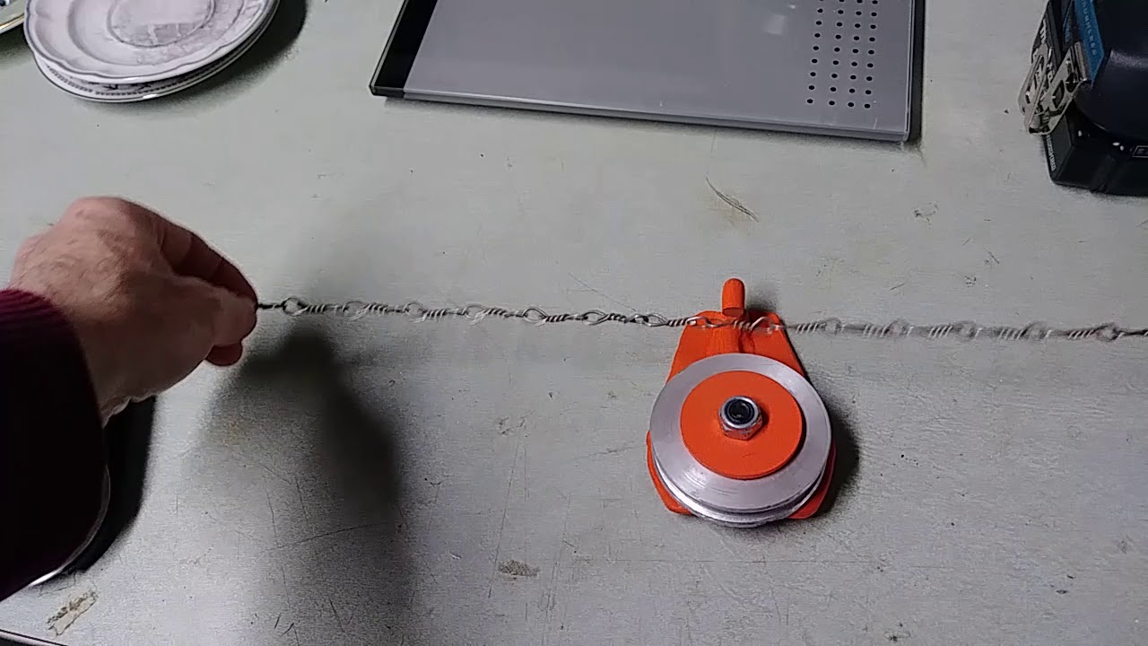

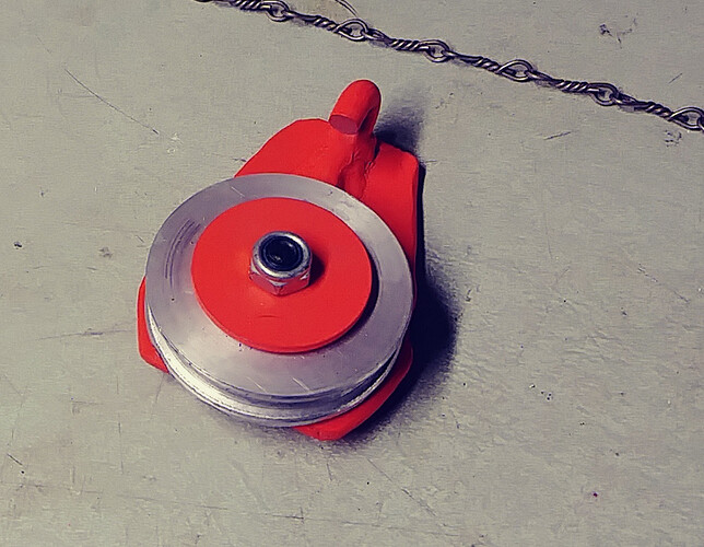

Here is a video on how I made the easy to rig snatch block for the machine that is half skidder and half forwarder. Easy to place rope over the pulley.
Pic.:
Video:

I think the skin should be removed from the bread to reduce surface cracking.

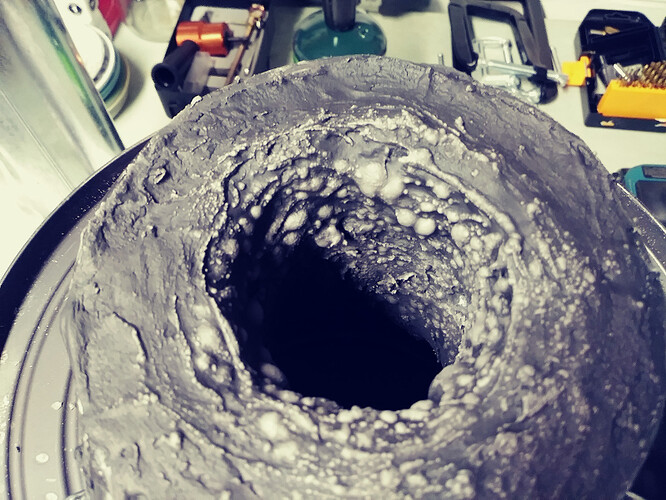

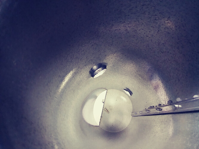

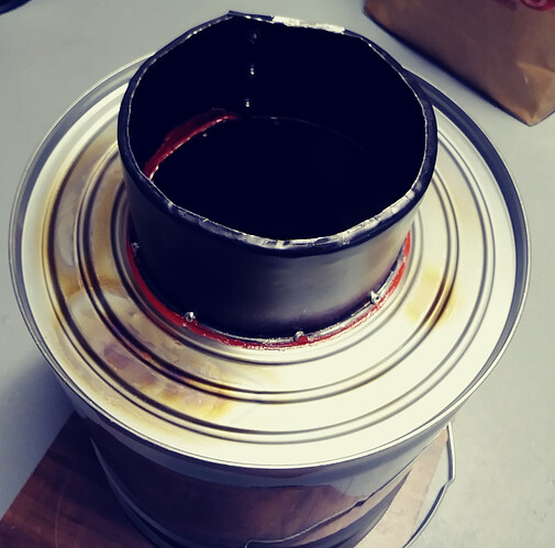

Bruce, interesting stuff. I now have my own small oven. I plan on changing how I make the carbon bread foam. The last design has the carbon bread foam removed. The lower oxidation cylinder is removed and a larger hole for a larger diameter cylinder has been cut. This will allow for more insulation. This first bottom pail will be built with ceramic blanket, original plan. A second bottom pail will be assemble for carbon bread foam. This way the bread testing will not delay the new ACFC much.

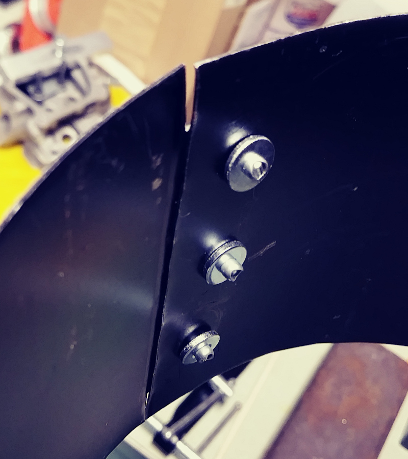

I learned what happens if the burrs are not removed when using back washers with rivets. Silly me. The middle rivet hole had the drill burrs removed.
The new enlarged oxidation zone.

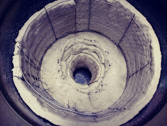

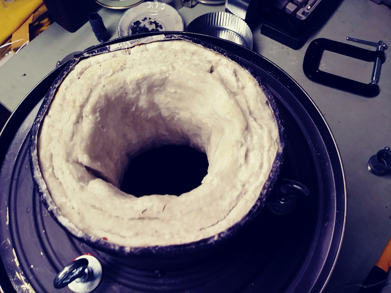

I do not like this toxic ceramic blanket any but it might buy me some time while working on the carbon foam. I bought a quart of the expensive rigidizer and applied it to the blanket. It becomes more fragile, I believe, then the carbon foam made from bread. Easy to put your finger through.
Bottom grate area:
Top, where fuel sets:

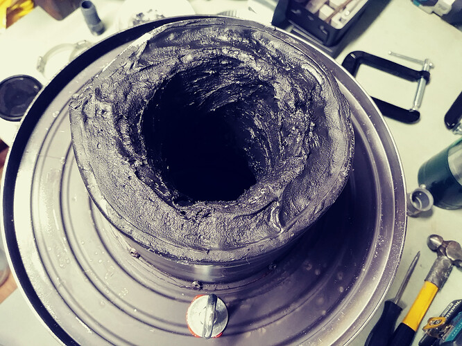

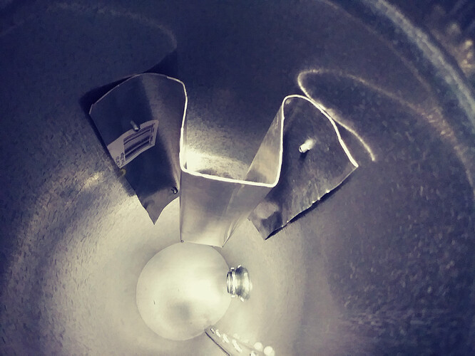

Opening is too large. Closing in with furnace cement:

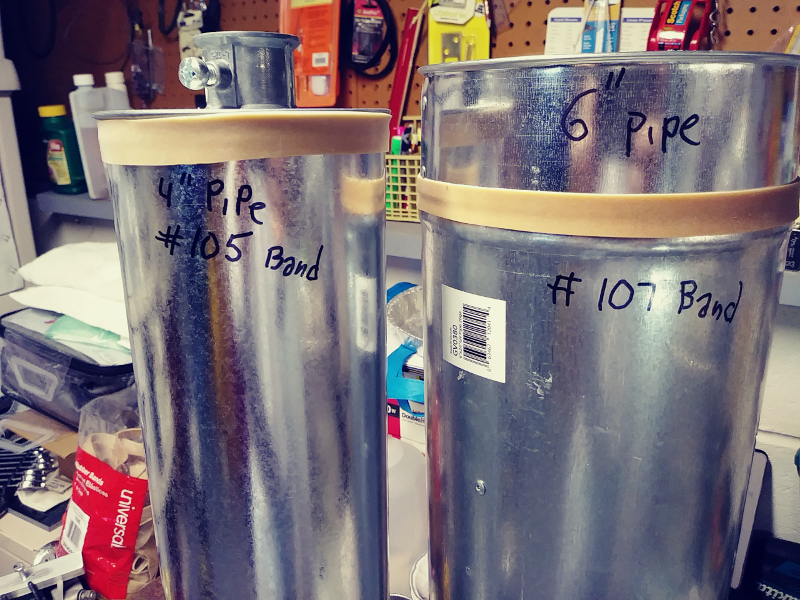

Becoming a sheet metal junkie. I see myself joining the stainless steel gasifier group. A lot of sheet metal can be stored in a small area as compared to tanks. Surely there will still be a use for some old tanks.

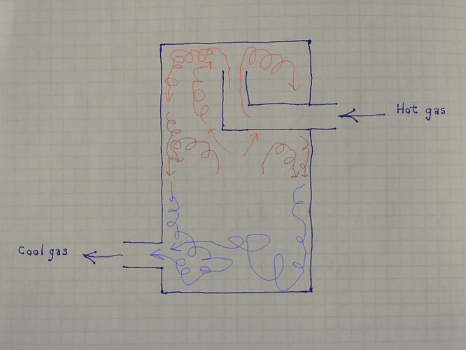

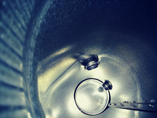

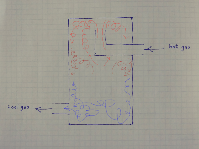

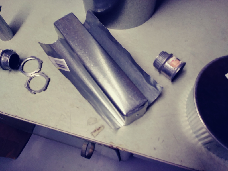

The cooler is stolen from the wood stove people. They call this design a bell or stratified flue gas heat exchanger. The idea is that the hot gas will rise to the top and as the walls of the cooler cools the gas this cooled gas will sink to the bottom.

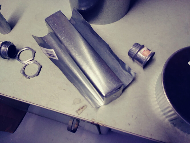

Who needs plastic when you have sheet metal that will flow:

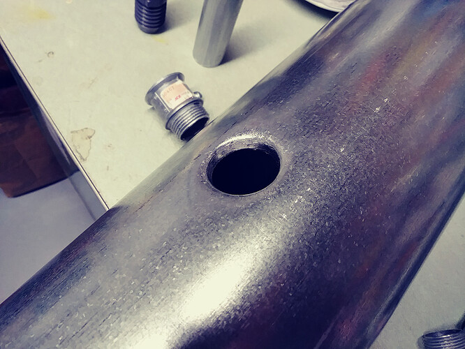

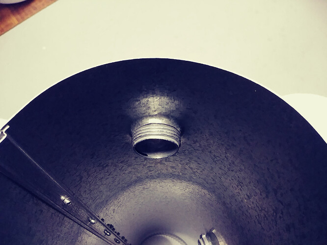

These conduit fittings make a nice connection, rather tight. The hole is flared with a ball pen hammer. Also add silicone sealant.
c
The cooler is just hanging from the loose pipe connection. That explains the tilt.:
No idea how well this cooler will work…
Opps. I forgot the elbow:
Reading through Bob’s build I found a link that Garry, @taitgarry00, posted. Gives some hope for the stratified gas heat exchanger. Possibly, as the moist hot gas looses some of the moister to the walls of this thing this gas will be displaced to the bottom a long with water running down the sides.
https://www.washingtonpost.com/news/capital-weather-gang/wp/2013/08/05/why-dry-air-is-heavier-than-humid-air/?amp;utm_term=.b1bb1c05fade&noredirect=on&utm_term=.8795a706aec0
Giving a band seal a try. The pipe seams are a pain in the butt but for now that is all I have. Decided to order (later) a small 24" slip roll and go with stainless steel.

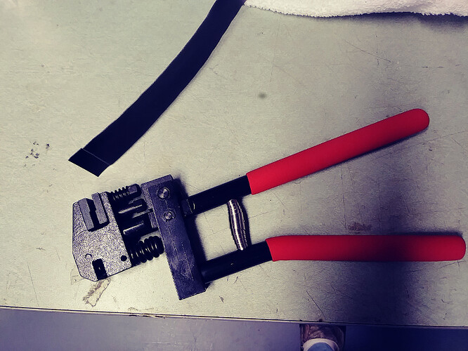

Hand joggling tool showed up. OK for small projects. This $25 tool looks identical as the $85 ones.

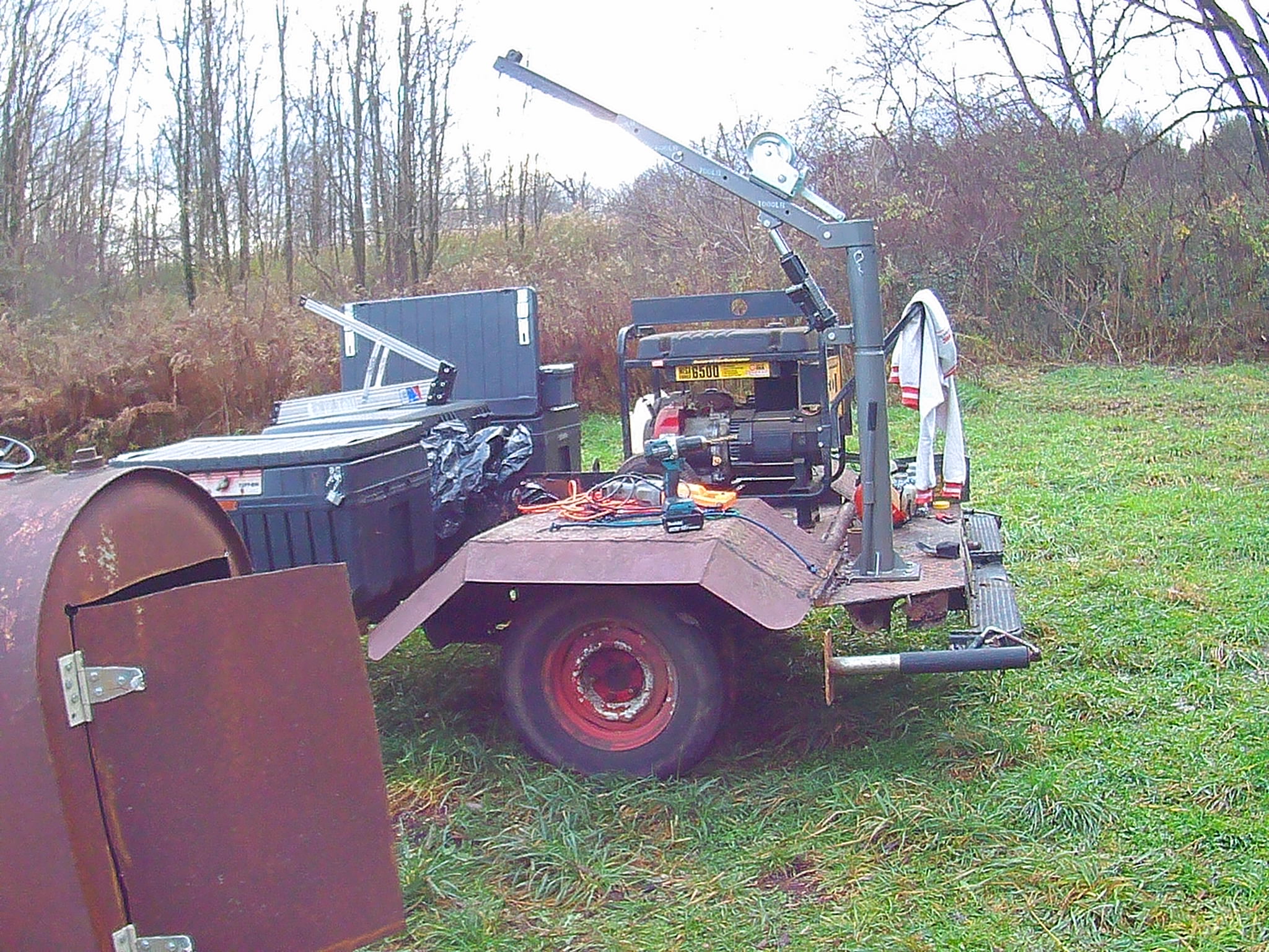

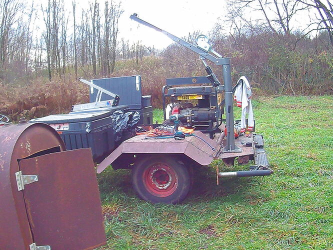

Just got in from making a lockable job site tool box for the mill. Not finished yet.
Use the tool trailer a lot but soon to be snowed in. The generator is about 25 years old and still runs like new, arm is nice for loading and unloading.

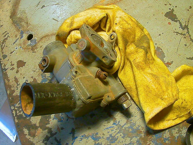

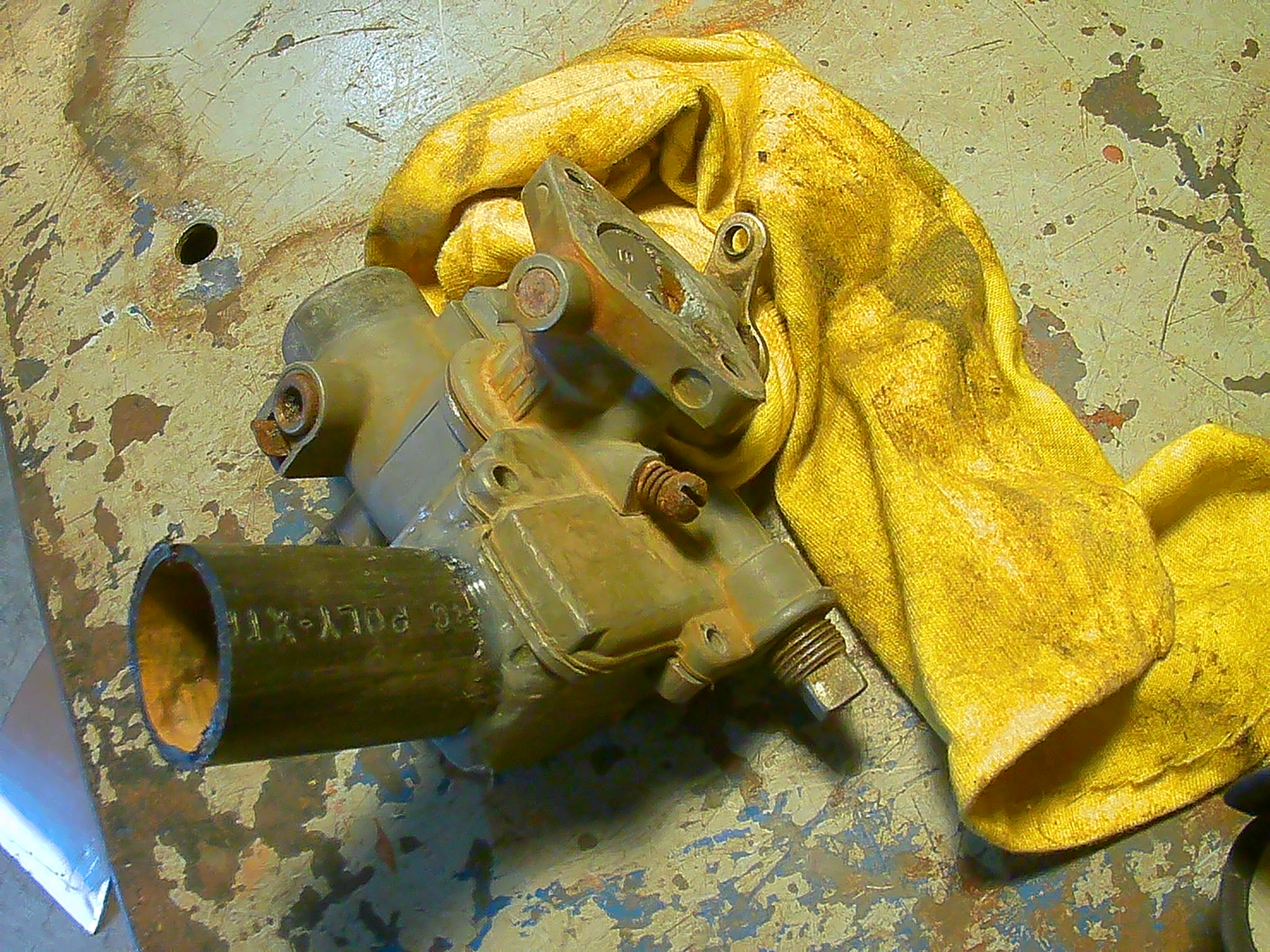

My way of fixing a troubled gasoline carburetor:

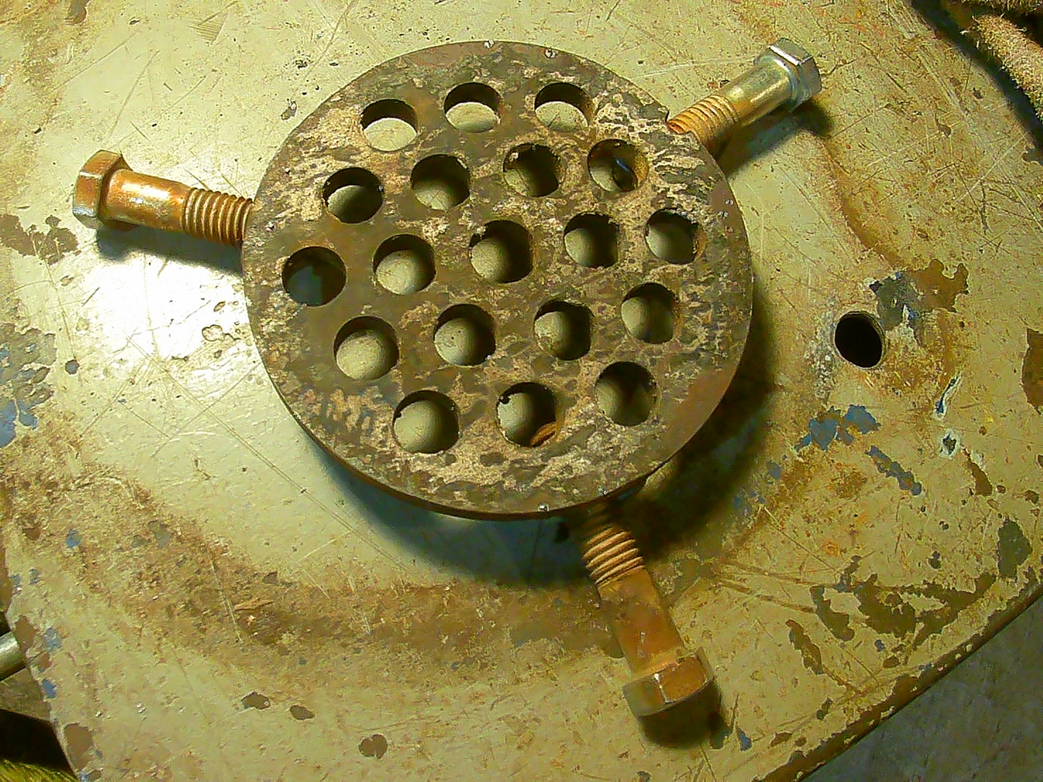

Grate for 5 gallon bucket gasifier:
