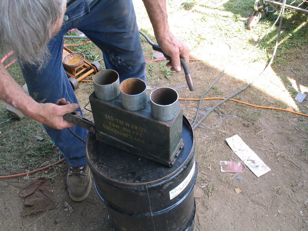

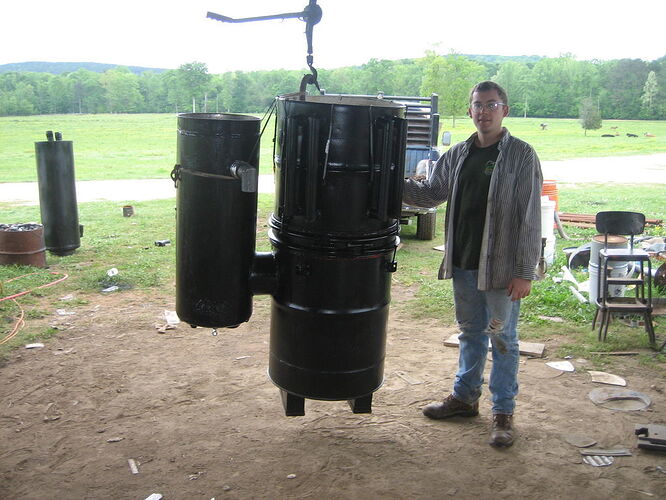

Chris, What a blast! Can you share any photos of building the heat exchanger? I’m starting another system and am just curious…
John
Hi John,
I can’t really show what’s inside the gasifier here in the public forum, but it’s basically a vessel in a vessel, transferring heat from the hot gas to the incoming air. When you get on the Premium area there are lots of pictures of the heat exchanger and everything else.

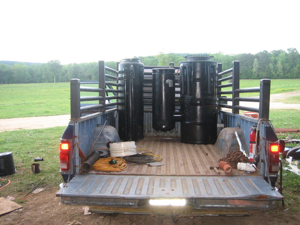

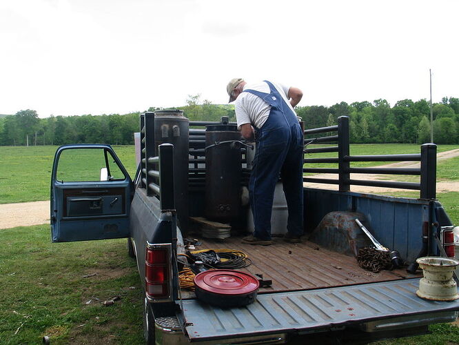

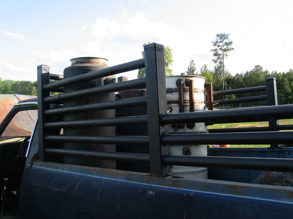

Making progress. Got the gasifier up in the bed now, it will be coming out again to get painted, but here’s how it will look mounted up.

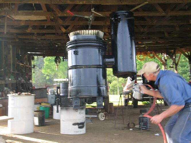

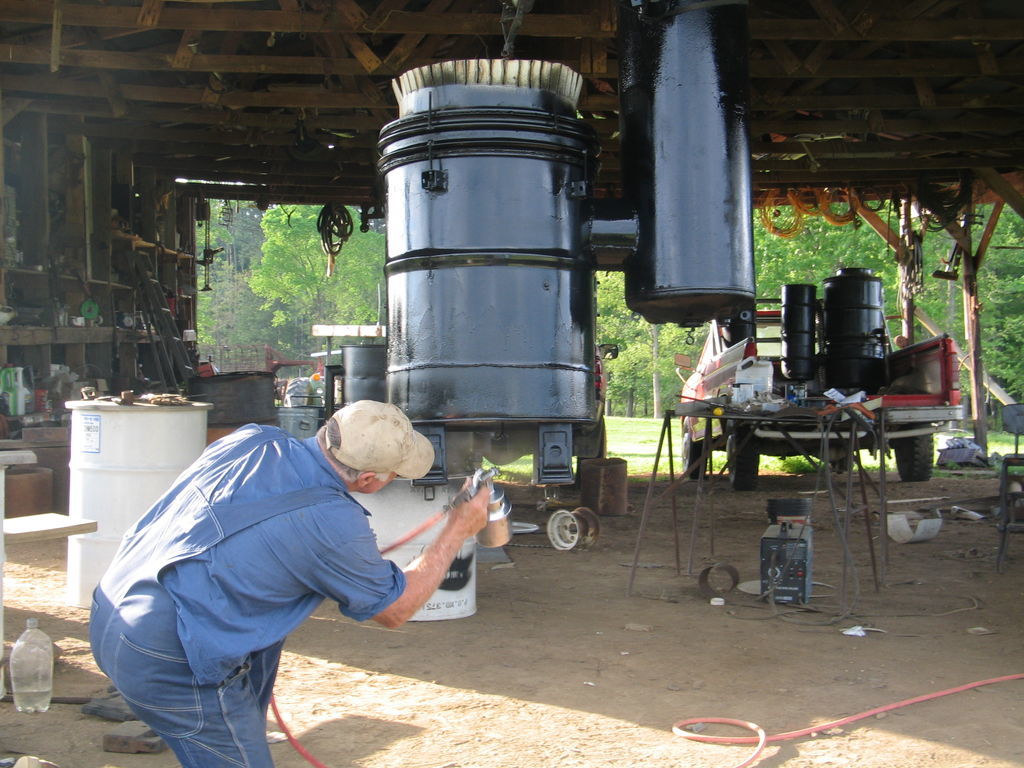

We got it painted today! Also some plumbing work. Will be gluing PVC next, and remounting the gasifier.
I can almost hear it running…

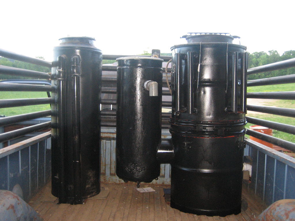

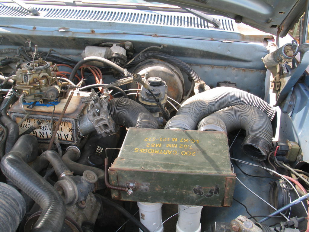

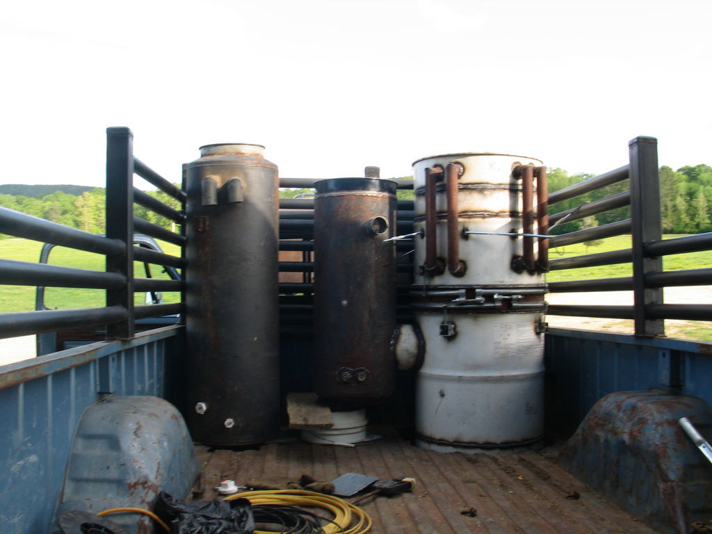

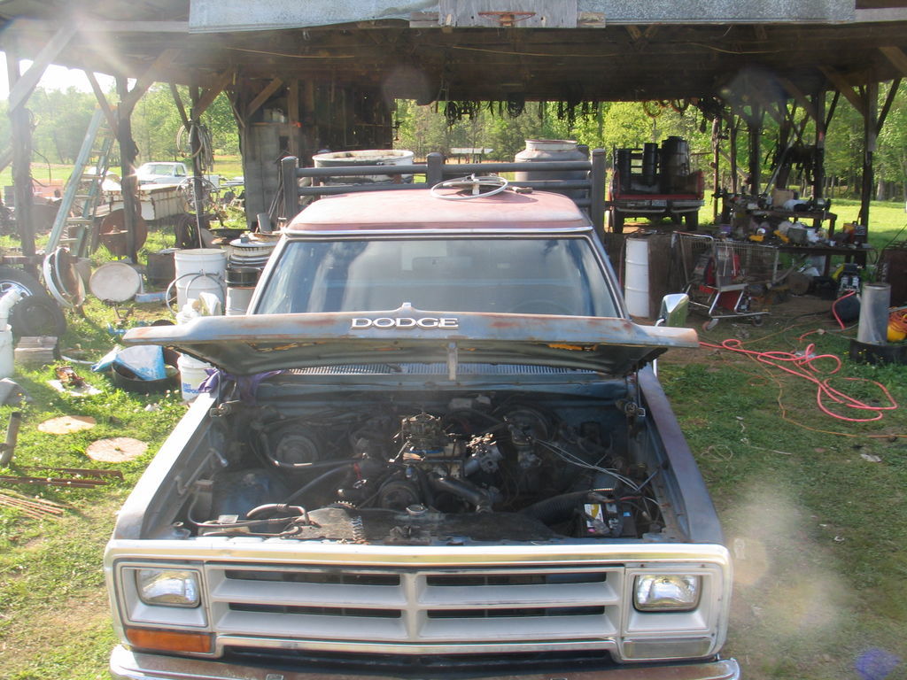

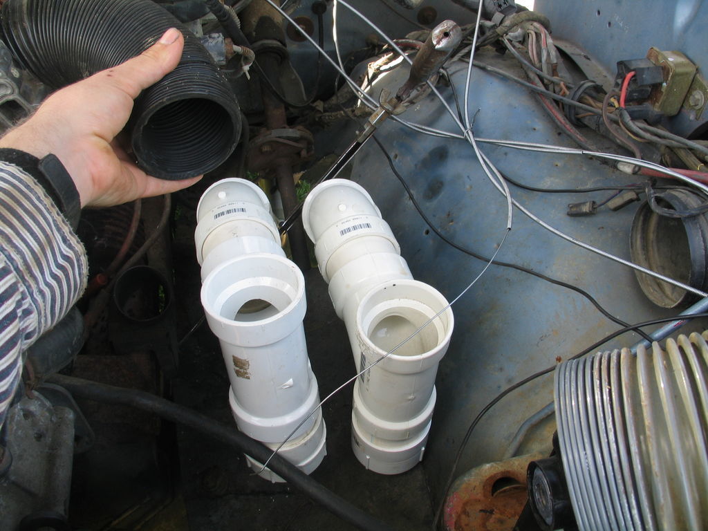

The truck is nearly ready to run!! We have the whole thing painted and mounted up. The PVC has been cut and fitted, and glued in place. Gauges installed, condensate tank plumbed, engine cranks up on gasoline. Still a few things to finish up and we can try it out on woodgas.

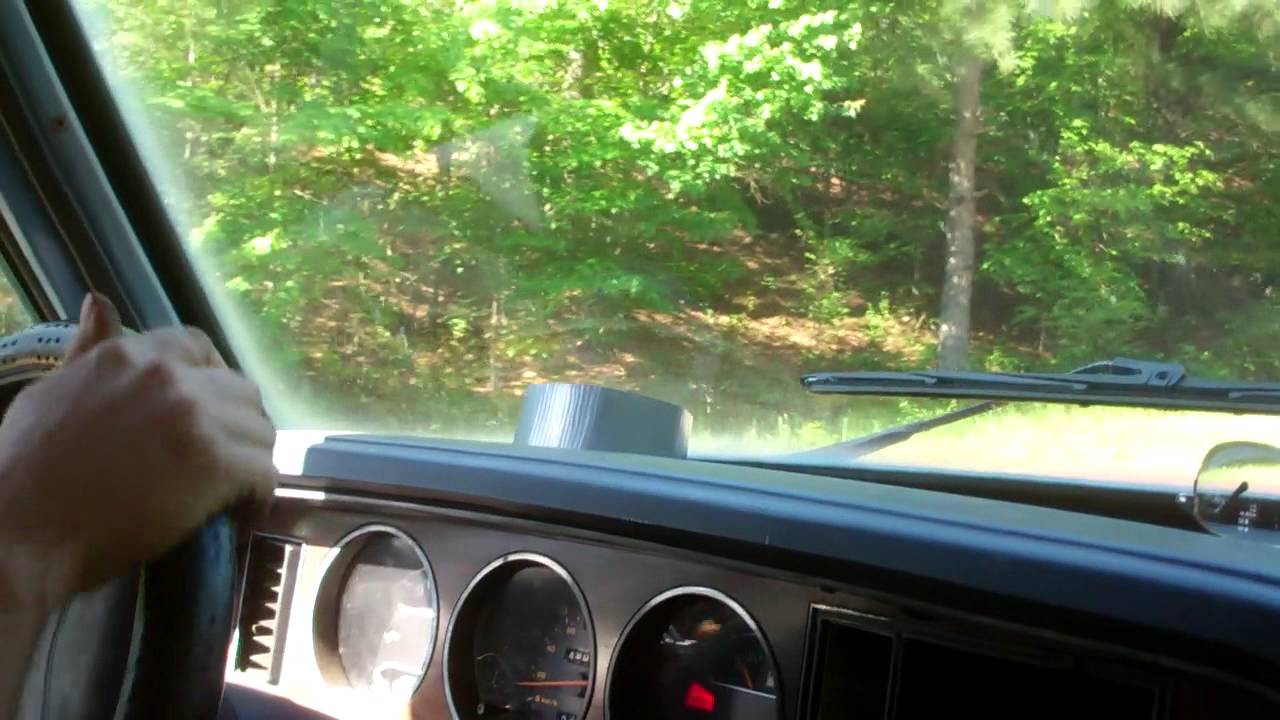

Well… It runs!! And breaks 65 no problem. Here’s a video:
60 mph in a 25 mph in front of a state prison??? Hmmm. They might have thought you were “huffing” woodgas and not burning it.
