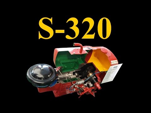

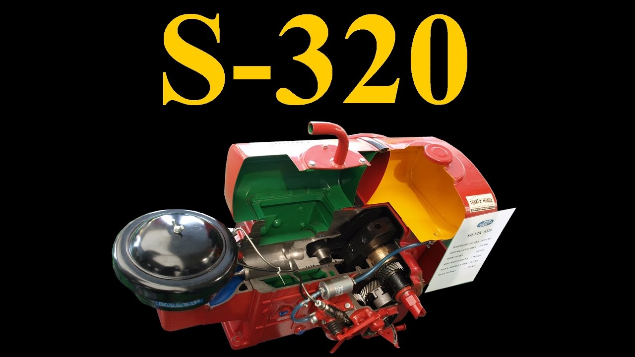

Andoria still makes a good clone of the Duetz hopper cooled diesels of the 50s.
Thats a pretty good option if you live in the EU and can get your hands on one ( just real heavy )
The Andoria engines use a cooler running Pintle style injector so you can probably use them to simple inject pilot fuel and run the rest on wood gas.
( I don;t own one I just like them and tried to import them at one time for just such an application )
