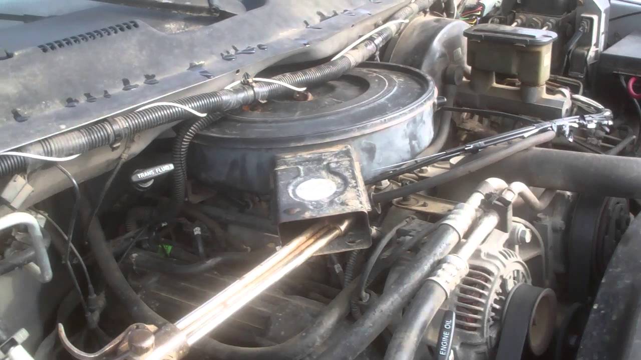

Your best thing to do would be to test the engine first by running on diesel and placing a pipe in to the air inlet and blowing LPG or handy gas .
As Wayne has done in this you tube video .
If you can adjust the engine revs by adding more LPG there may be a chance that the diesel will run on wood gas with a diesel pilot ignition.
This is Wayne running a vw rabbit on wood gas , but the gas is being blower in to the rabbits inlet not sucked.
