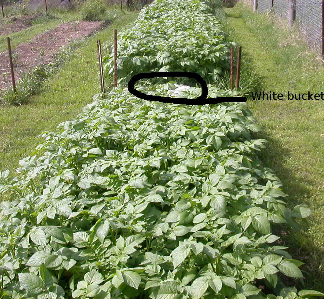

I walked back yesterday to my charcoal cone retort and noticed some greener patches of grass around it as I was coming near it. A closer look showed that in places where I spilled char as I unloaded it last fall the new shoots of grass were standing up three times as tall and had a much lusher and greener color than surrounding grass away from any charcoal. Could it be that the small pieces of charcoal being black heated more by the sun gave the plants the extra boost or did it attract and hold extra nutrients and moisture over the winter to give the grass an early boost? Whatever it was, I like the results.
Hi Don, where I grew up, we burnt road sides,and hay fields in the fall. Those areas were always first to green up, and were thicker than where it wasn’t burnt. Never knew why just knew it worked. Al
