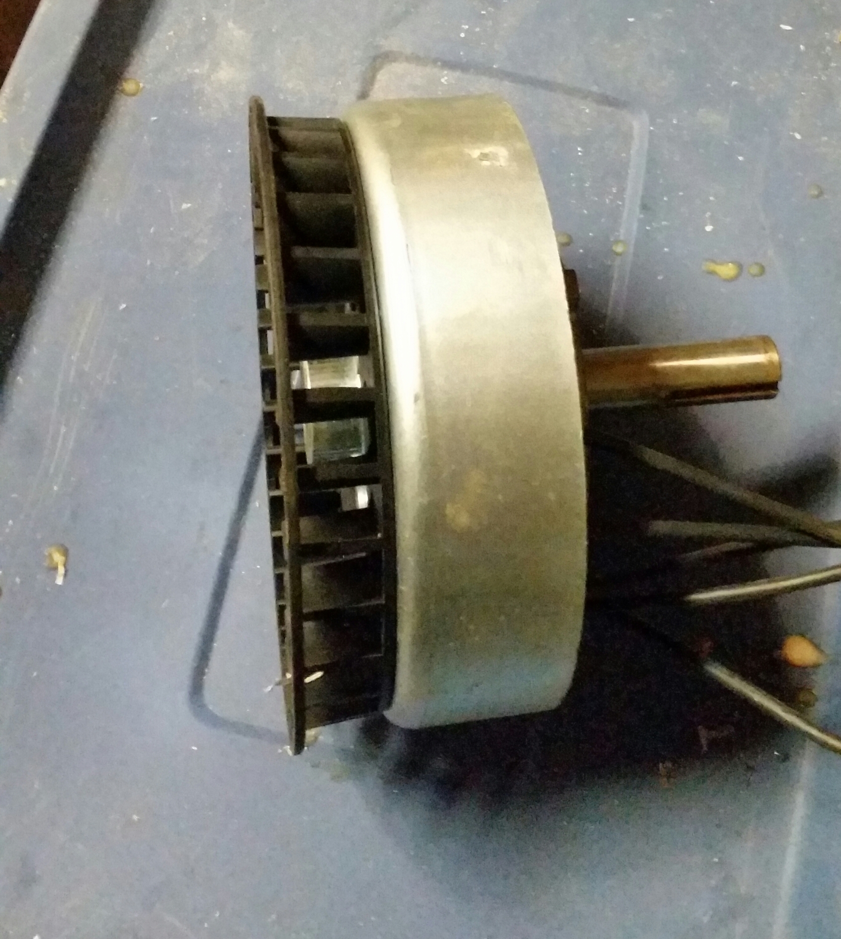

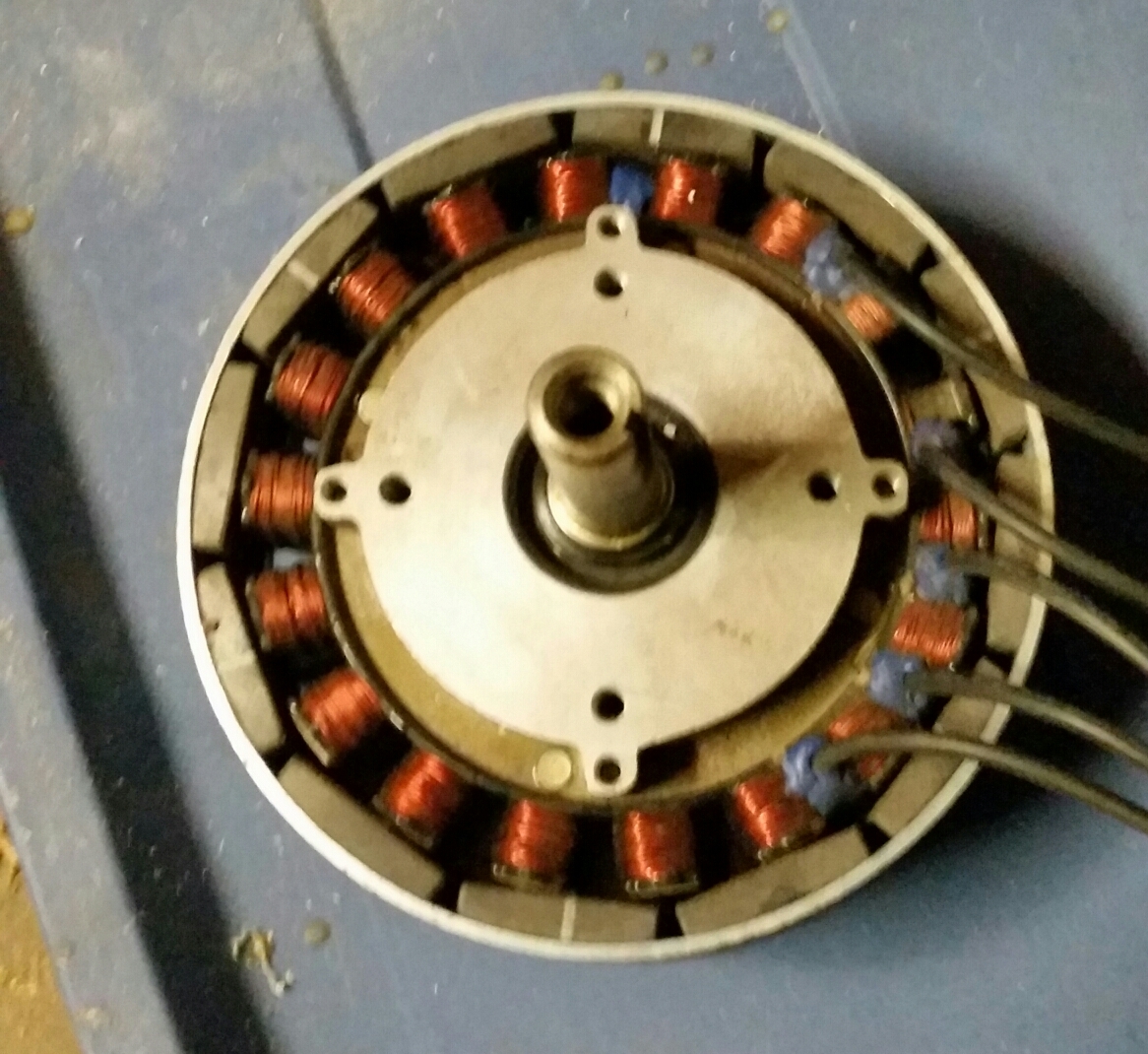

Dave the part I would like to buy is the PM alternator unit only.
I suspect the crank shaft used is the same as the regular generator units based on a single picture.
The one and only good application for these PM alternators is to charge batteries ( or DC capacitor link for an inverter )and we have the perfect application for it.
Since there is no field control the only way to increase alternator output is to increase RPM with load.
This is why inverter generators all increase and decrease speed in response to load changes.
This is a handy feature for a wood gas powered engine for a couple of reasons.
If the load exceeds the prime movers ability to increase power then engine slows down, but it will not stall our stop.
See here from a previous post, this is all I really need to work from.
But It would be nice to know for sure what crank shaft they use ( I have lots of cranks for clones but a limited number of the most likely type they used generator taper, threaded pump and 20mm metric )

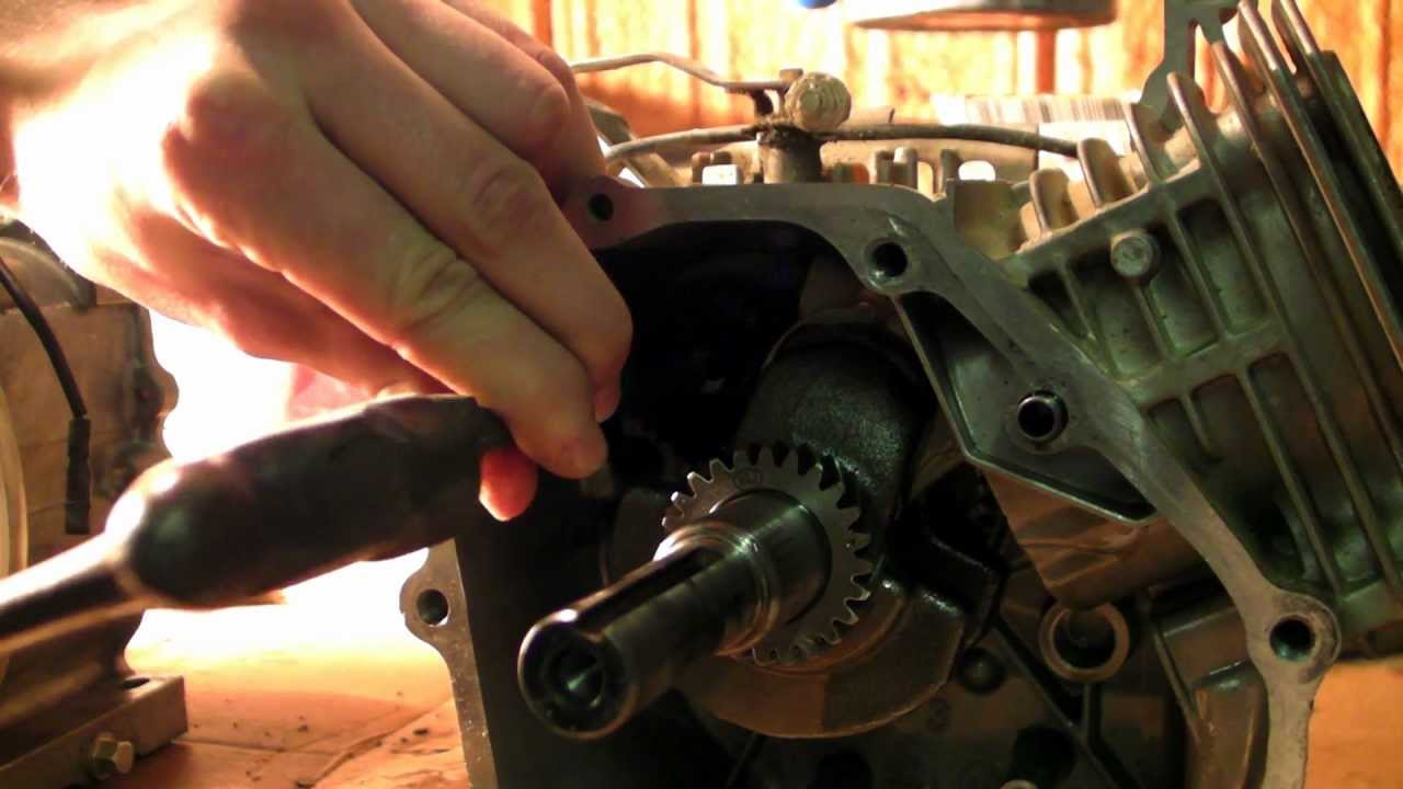

Koen:
I see the governor arm is still intact.
This leads me to think non of the internal parts to the governor were removed.
IF this arm moves the wrong way it will come in contact with the crank shaft.
There is a high probability that parts of the governor are now in the bottom of the engine.
You will need to remove these pieces.
Drive out the governor gear with a punch from the flywheel side.
The arm will be removed pulling it down through the crank case.
Buy 2 short American AN type 1/4 inch 20 TPI screws and force them to thread in the holes.
No tapping is required they will make their own threads ( Whitworth will also work but use hard ones not cheap Indian crap. I have no idea what you have for bolts other than metric )

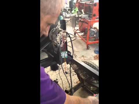

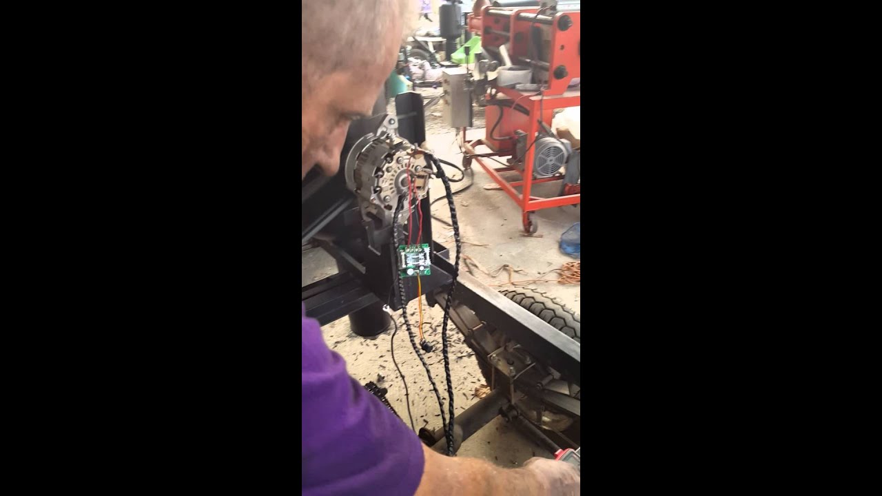

Its an 80 amps 24V truck alternator, choosen for the low rpm and the static rotor windings (only the cage turns) Also has no brushes.
I added about 14 vid’s on youtube having this running. You might see more detail on them as well.
Good hint for the arm to remove, will first have the springs back on it before i open this one… ( 2 brand new )
I adjust the load with a pwm, able to connect it with a arduino later on, for throttle and load control.
This was the first test on woodgas driving it.
The alternator is now without its own regulator, so i can boost the voltage as i want or as far i can
Step by step working it up to a multi tool …
The batt pack is 60 Volts, but the batteries are down… old solar gell batteries, need budget for new ones…
i want to be able to pull 3 Kwh with an inverter, meaning 2 kwh from the running alternator and 1 Kwh from the batteries
This as max value ofcourse and continiuous.
Back to the governor, i was thinking to build a “servo” control with that arm, to adjust the load/rpm, a poti to the arm and a servo on a butterfly valve. Maybe you have some idea how to ?

I am alarmed about that governor arm being left like that.
I think you had better stop now and remove the parts or do something about this.
I am 99%v sure you have loose parts flying around in that engine ( plastic pieces but still potentially a problem )
If that crank hits the arm while its loose at the right time and place its game over for the engine.
Here is a video that shows what i am talking about with the punch and hammer.
