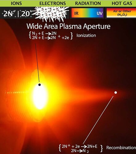

The point of relevance is the formation of CHEMICAL PLASMA using an lower amount of syngas. You can use this high temperature source for standard wood gasification or for charcoal gasification. This process use normal air and transform the nitrogen inert gas into an ionization flame. In fact you obtain an very similar plasma like with an electrical source. Using the chemical plasma you can purify syngas also. Some applications are possible with an right reactor design.
This is the flame from the plasma burner with the purified syngas using wood pellet… The photo is on black because the flame normally is bluish transparent at high temperature.
Do you think the video is an fake? Please watch the flame in action to - YouTube

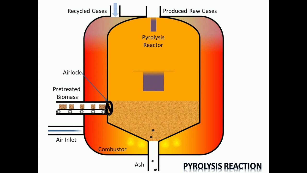

Hello Daucie,
Just thought I’d throw this link in to show you how they use recirculated gases instead of plasma.
TJ
(and now I’m running behind to get to work, but it’s better than watching a cat drink out of a toilet)
also think I may have posted this to the wrong thread, but it’s close.
